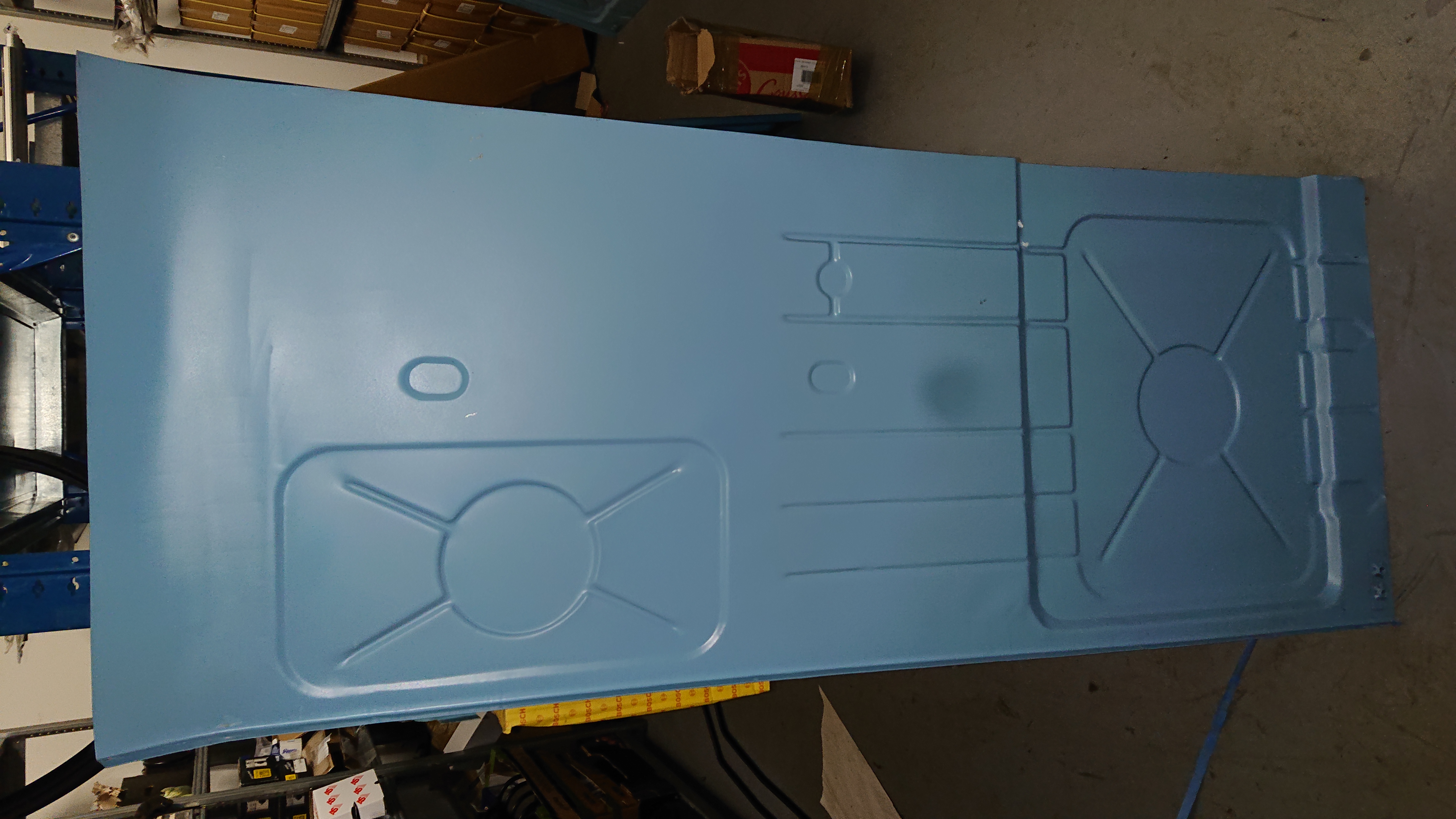

It really depends on what portion of the floor pan you are replacing. None are perfect as Don says, some cover more area than others. I found the W&N matched ok but did not have the same front curve and no side lip. For my needs, it was fine. Decide what you are going to cut out and go from there.
Didn't try them myself, but they appear to be resell of the polish Pelny Sklep Manufactura ; however their website seems to be non-functional:
If the bmw-oldtimerteile.de (Stefan Ries) can still supply them (website says "unavailable"), it would be great to know & document here.
