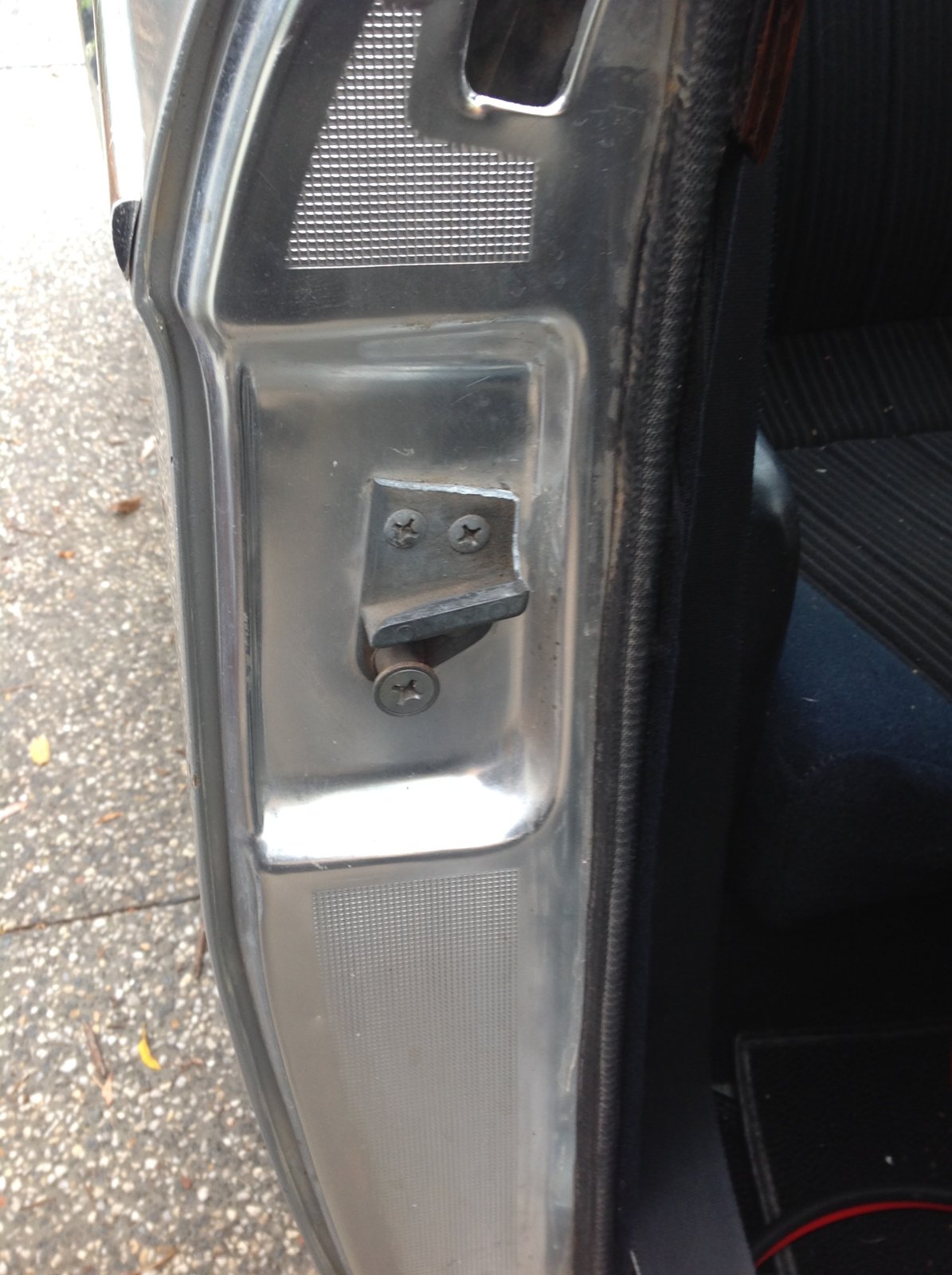

Also need one of these as it's broken:

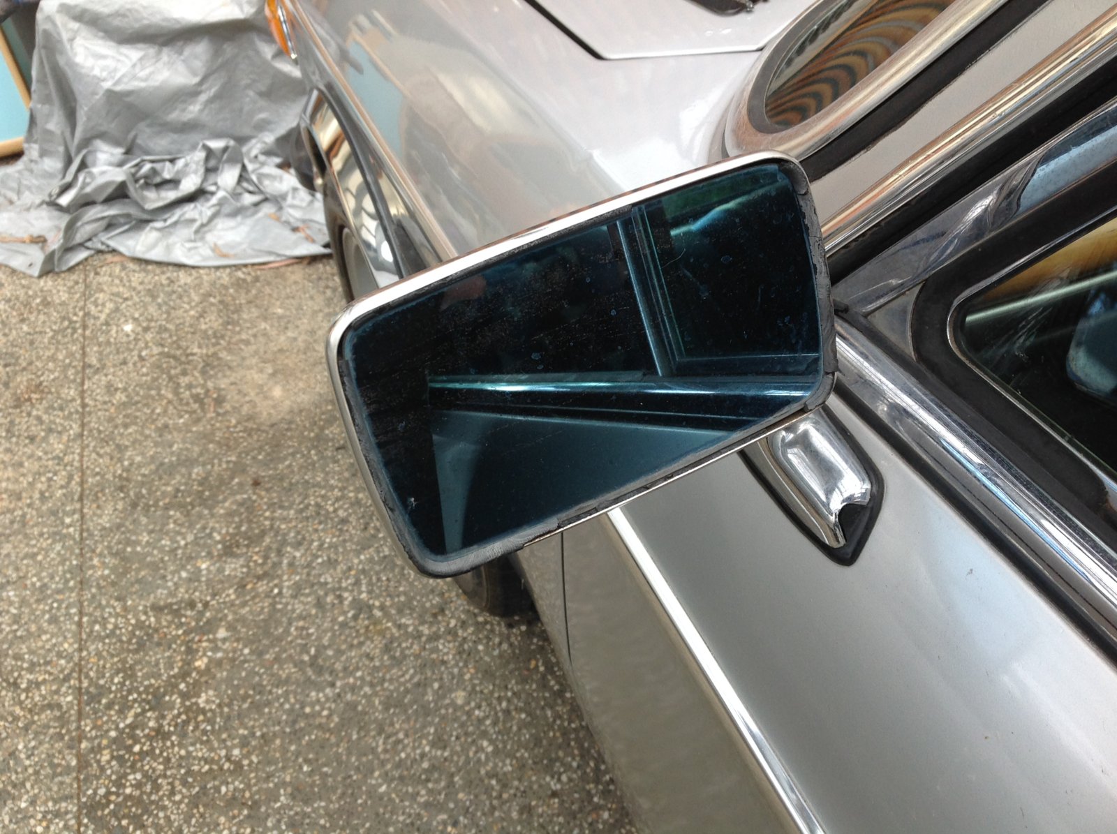

The plastic inserts around my mirrors is also shot. Can this be replaced or do I buy new mirrors?

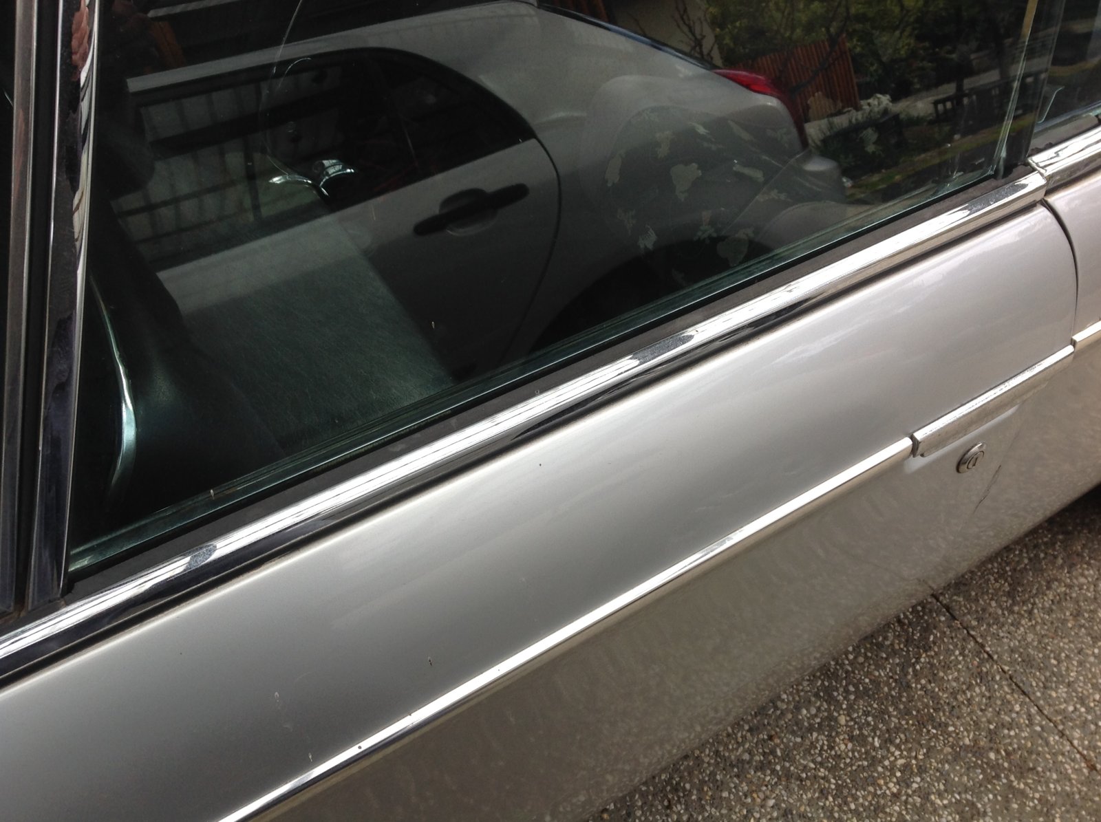

Same for my window rubbers, I'm assuming I just grab these from W&N?

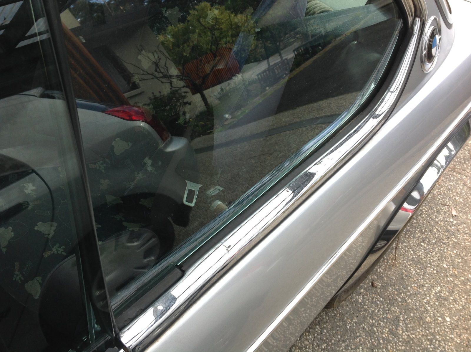

Same for these little seals peaking out from under the chrome trim
Spend some time on RealOEM.com and the Walloth site and you will find part numbers for most of the rubber. The mirror surround is not replaceable on flag style mirrors.

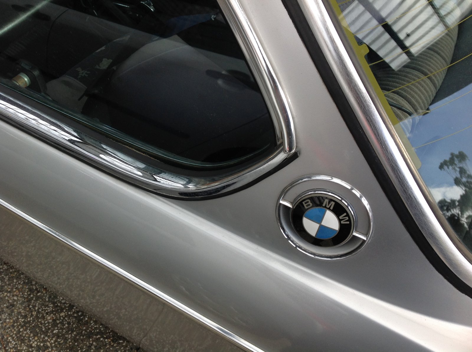

All E9 BMW roundels, CS and 3.0 badges are still available from BMW new. Also I spotted an OEM 3.0 badge currently Ebay. Don't get second hand badges, buy brand new ones they look much nicer.
(also be careful you don't buy Chinese made copies, as they will turn yellow after a few months)

black frames are the way the mirror is fixed, the frame itself is loose in the mirror cover, but once the mirror glass is in its frame if you press it against the cover it gets fixed in its place
it is critical to remove the old glass with its old frame
i would cut the old frame border so the glass slips inside the cover
i did this in my lh side mirror
problem, yes, so far no more frames available, i had a couple of them but fixed a couple of them for friends
