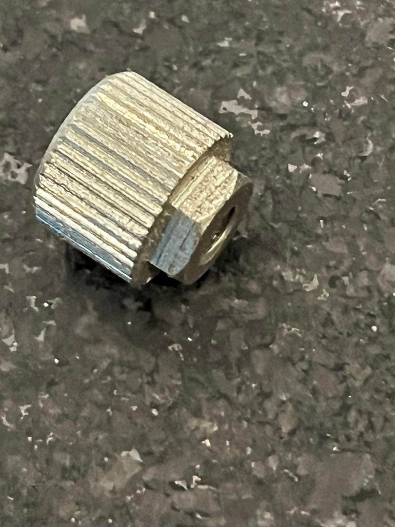

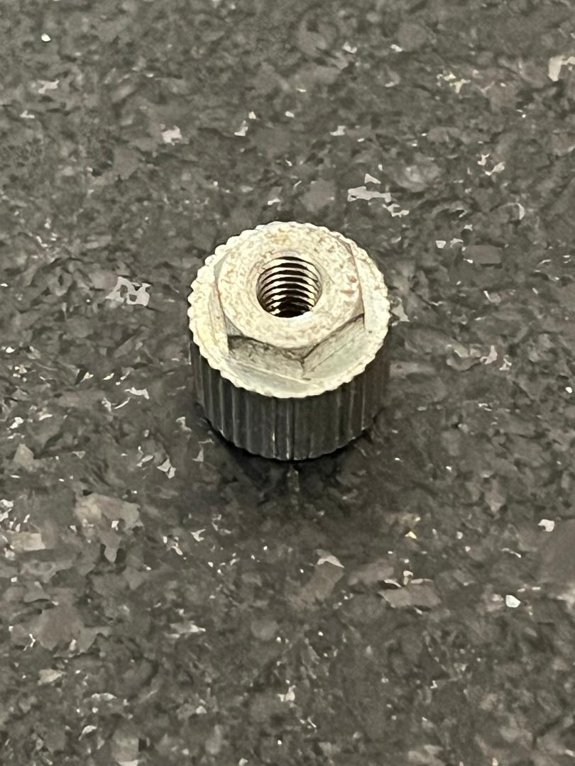

Jon, i think this is what you need ... don't think you need a spring washer. there aren't any on mine. if this is what you need, i will mail it to you.
scott
  • Like
Reactions: Dlc
Scott,
That's the one. I think it's a 7mm nut. Thanks once again. I need to supply you with something out of my parts stash so let me know if there's a part you are on the lookout for. Send me a DM when you figure out what that is.
Regards, Jon
