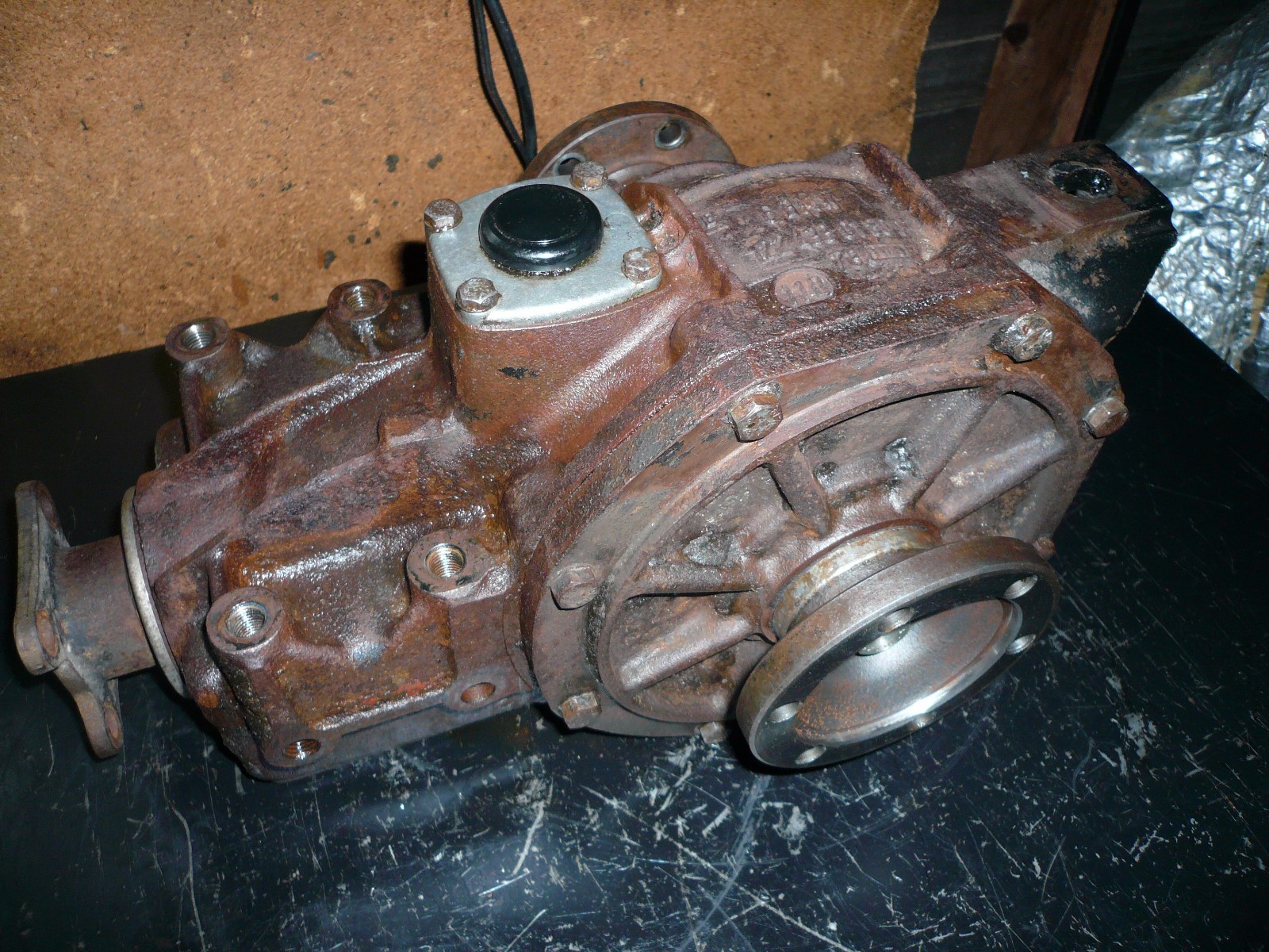

Wtb limited slip diff
I have a 3.07 and 3.64 that I think we have spoken about before but I will not know which I will keep for a few months. There has been lots of feedback that the 3.07 may be too tall, but given that I have it, I may just install it and see because 3.07 is not really that far from the factory 3.25 for the CSL and at the end of the day, BMW paired the 3.07 with the dogleg CR gearbox on the 635csi, which was not a slow car.

  • I have a 11/40 with an "S" but no white markings. I have the trailing arms too from a 3.0cs both going in the 2800cs
