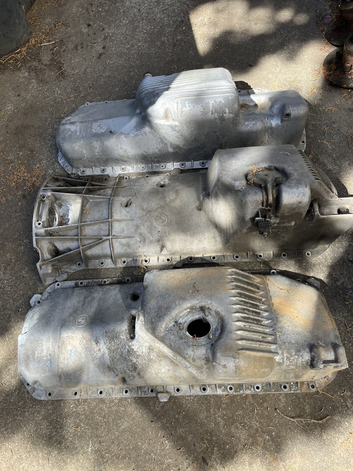

The M30B35 pan won't clear the steering/suspension in an E9. You need the pan from an early M30 with the mid sump.
Pans from top to bottom - M30 from an E3, M30 from a late 80's 735i, M30 from an E28

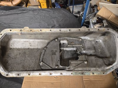

Think the thread sowed some confusion, , I need an M30 oil pan that will fit in an E9 chassis. I believe the ones that are for sure same and will bolt right up with my new E9 oil pump correctly are from the E3- E9-E12. I have an M30B35 oil pan from a 535 already, that oil pan will not into fit an E9 chassis. Here is a picture of the pan I am looking for, if anyone has one of these let me know
. Thanks All

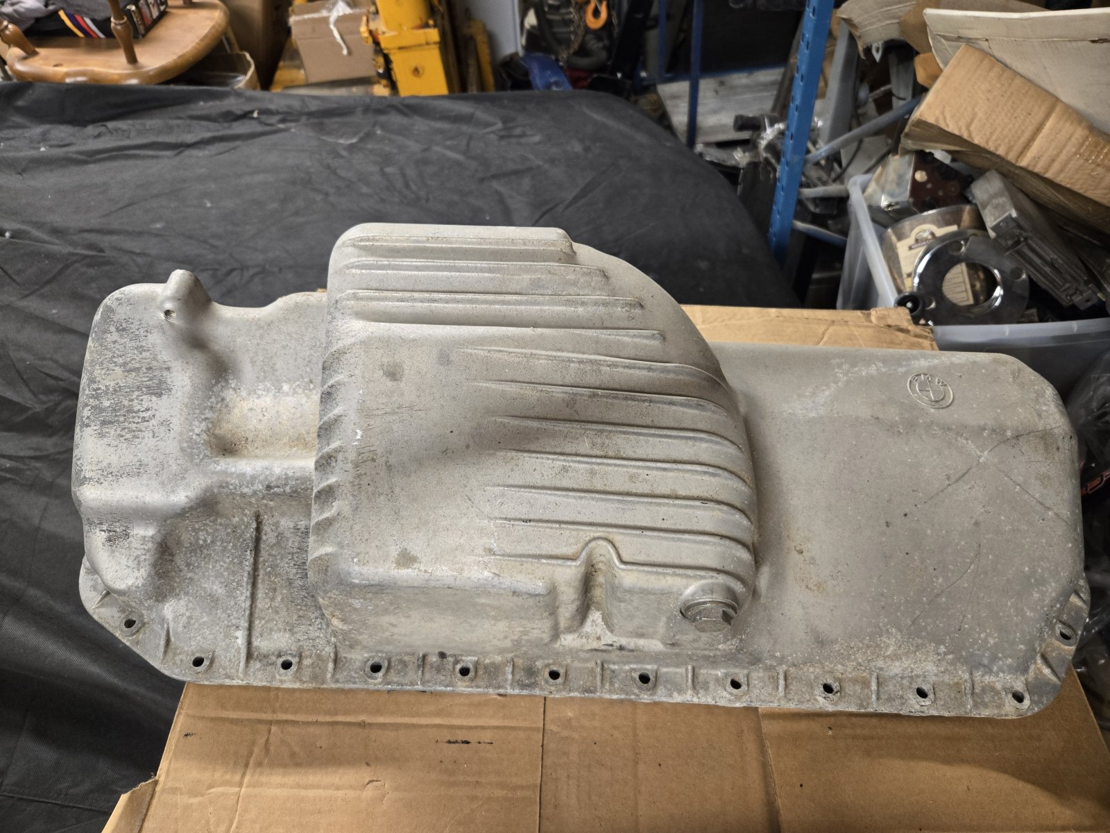

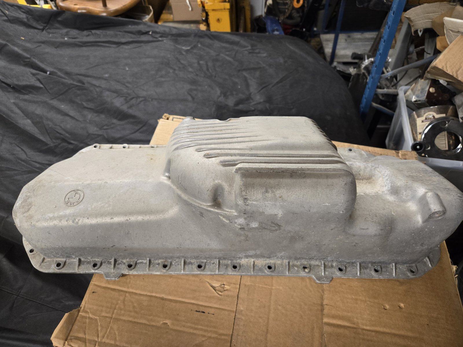

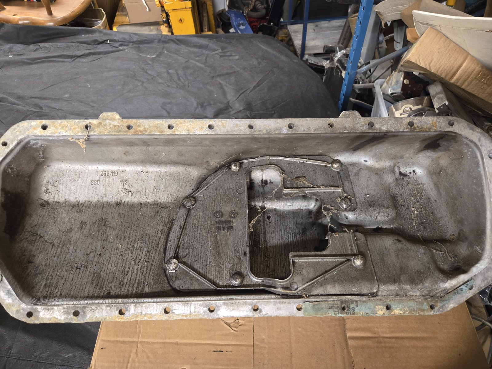

I have this one .
