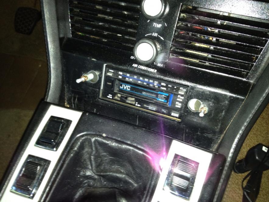

How do I make this work for newer sony stereo?
How do i make this work for newer sony stereo?
is this the original plate or is it the back plate?
Just enlarge the faceplate opening to the standard DIN aperture. Do it carefully as you don't get a second chance. Nice AC radio plates are hard to get and pricey. Other than the oem faceplate, there is no other parts needed to mount a radio unit.
face plate for radio
How do I cut it? , what kind of tools or what sort of shop does this?
Also, suggest you make the cutout about 1/32" smaller than the exact opening, then file to size using a sharp fine metal file.
