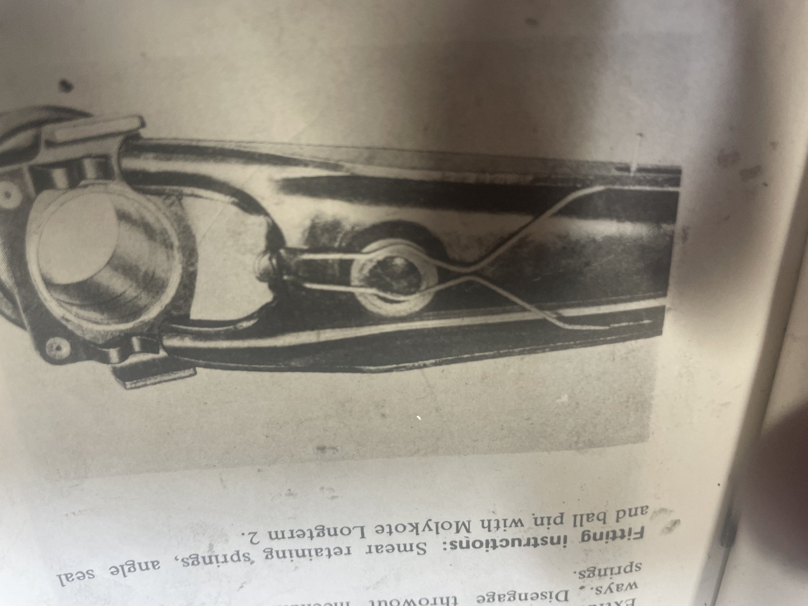

The spring is on the old style clutch arm. Anyone who switched to a five speed and had an older fork arm might have this lying around. I believe the five speed requires the new style, pivot and spring.

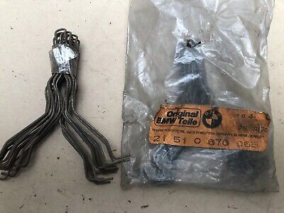

In Uruguay:
BMW 2002 TI / TII / TURBO GETRAG 235/5 CLUTCH FORK SPRING CLIP N.O.S | eBay
The Getrag 235/5, optional close ratio 2002 5 speed was the factory optional close ratio five speed gearbox for the 2002. These units are fairly rare. This transmission was an option even on the 2002 Turbo.www.ebay.com
The Goldmine, thanks.In Uruguay:

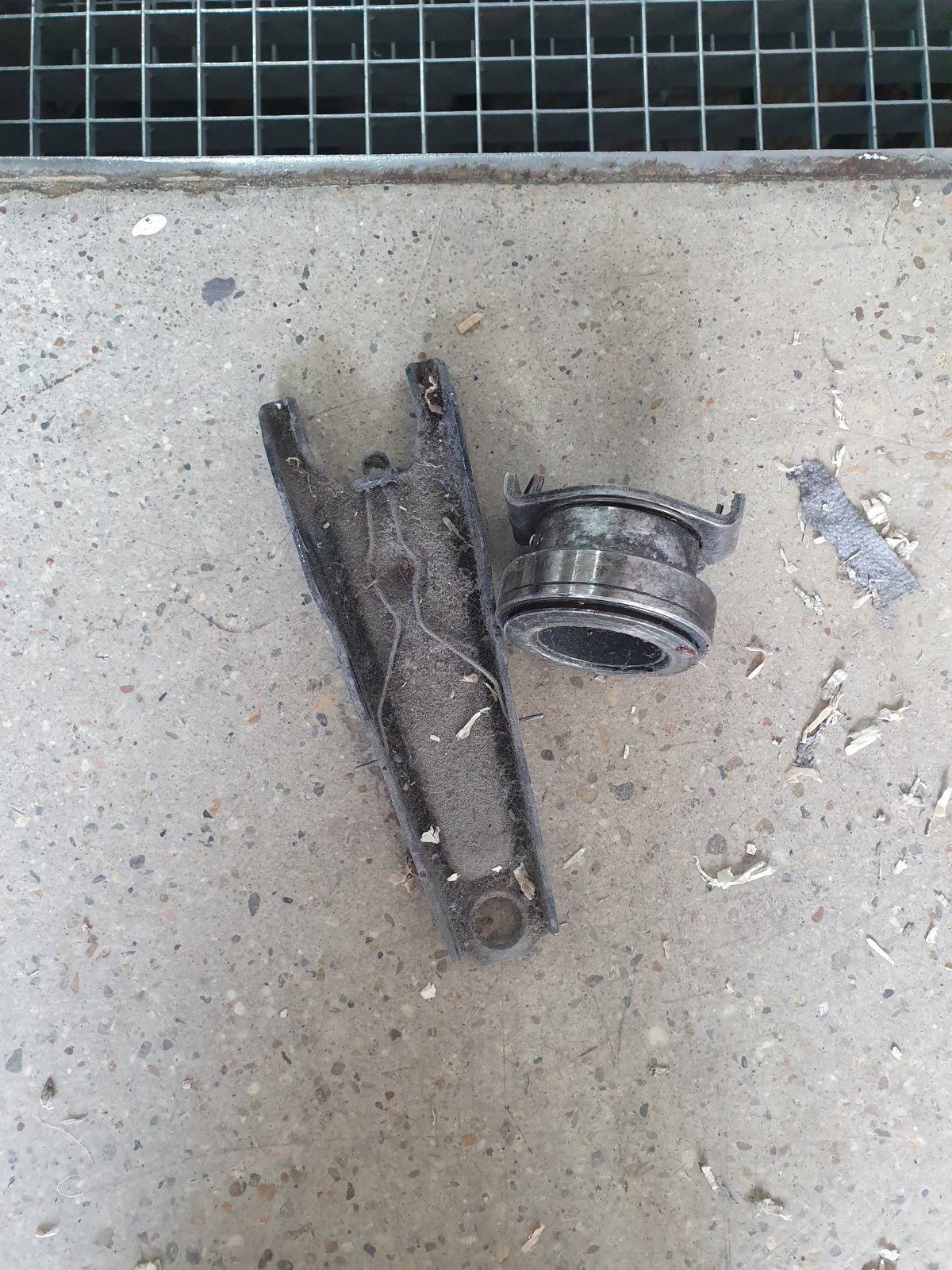

Surprisingly, I had that. It’s kind of an inverted cap.Same as 2002's and E12's try over on the 2002FAQ There is also a rubber cap/seal that goes around the pivot now, that one is hard to find
