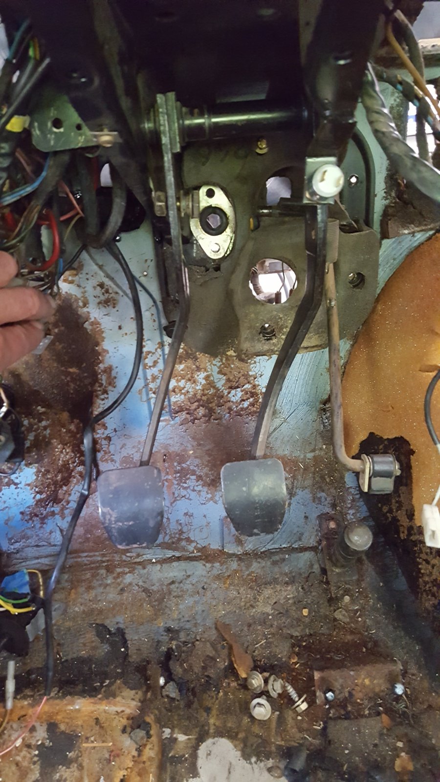

Swapping my auto Bavaria to a 4 speed and need pedals and correct driveshaft. Doesn't have to have CSB.
Awaiting to hear from a couple folks if the e12 pedals are difficult to modify for the swap, so I’ll keep looking for a stock e3 brake and clutch pedal. I live in 97211, Portland OR. Thanks!

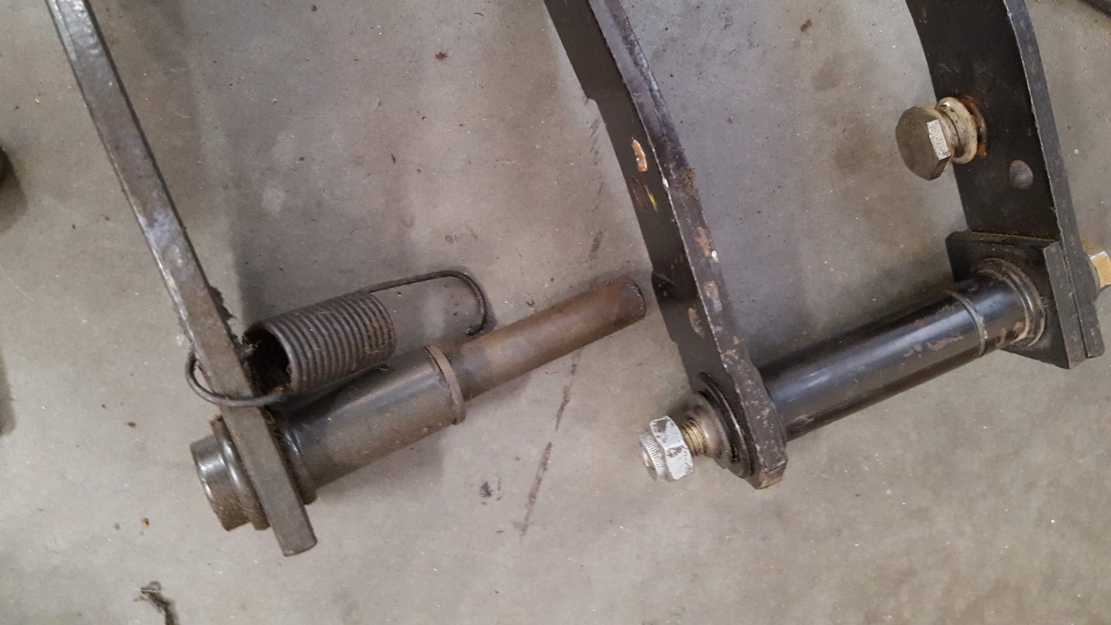

I believe the offset on the e12 pedals is different, and 74 and later had the large spring as well which I assume the e12 does also. Jefflit here attempted to modify a set for his 73, I can’t remember what transpired.

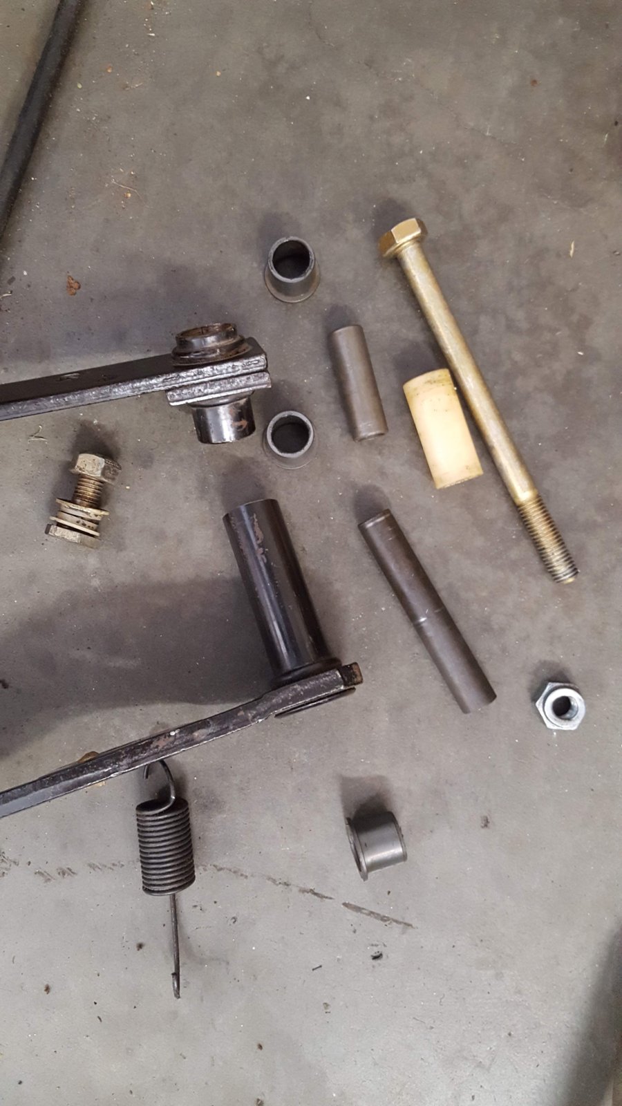

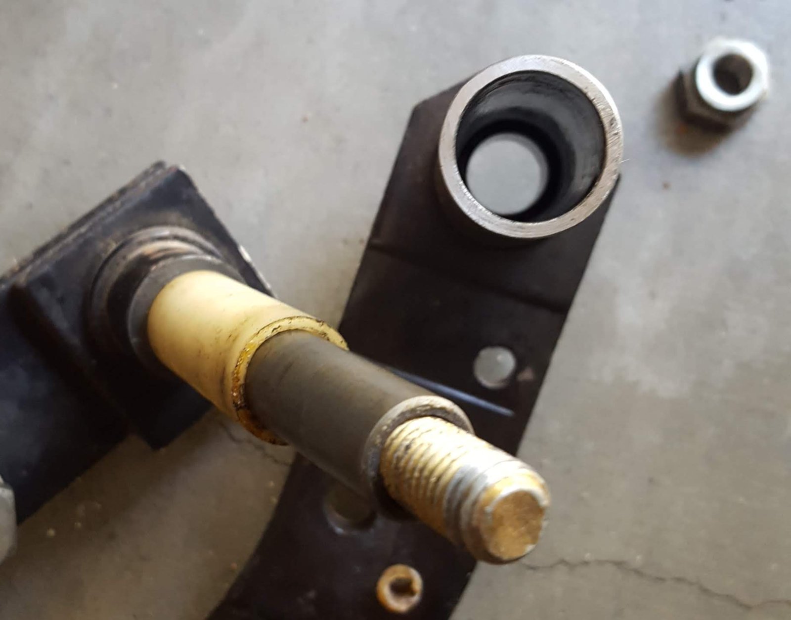

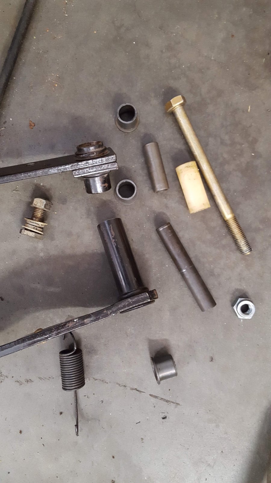

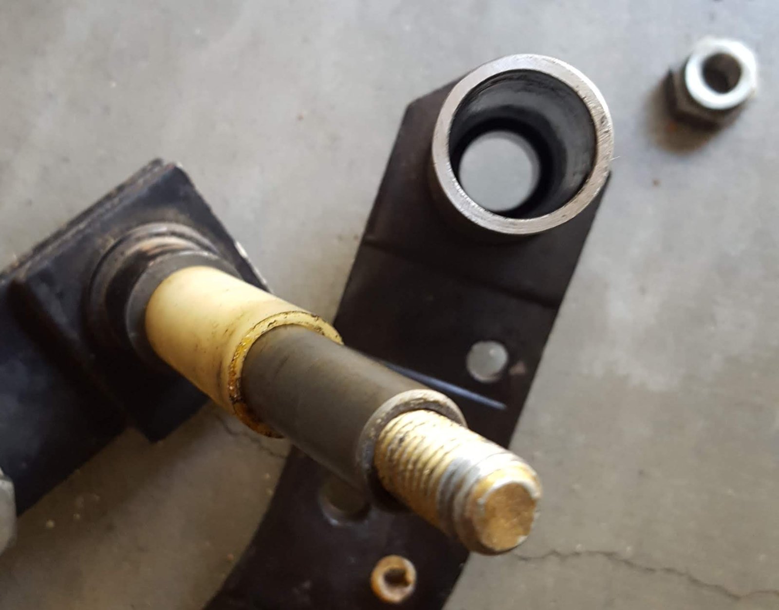

Indeed, I modified E12 pedals. I believe they work fine once machined to fit. Offset to clutch slave may be a bit off but not more than can be compensated for. You be the judge. Mine have been black powder coated since these fitment photos. I don't need them (Tesla is an automatic). Let me know if interested.
Machined to fit...
Compared to auto brake pedal:
All the bits:

Definitely interested- nicely done, too. PM me or I’ll contact you when I’m off work. I have snippets of time here and there.
