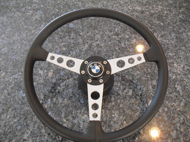

decent petri wheels with good metal, correct horn button and hub are getting expensive here in the states. be careful with the texas seller 'bgo ego' or 'ego bgo' ... not sure which it is ... or what i call him - huge ego. he has been selling wheels of late with the incorrect horn button and an aftermarket hub for well over 1000 bucks. the wheel itself is generally in pretty good shape, but getting the correct hub and button is very difficult. and NO, this one is not for sale

Why doesn't this look right?
Its a pieced together wheel.
It's a rare "dished" petri 40cm wheel, never used on BMW's. So its not correct. Also using aftermarket CNC hub and momo horn button.
Built it for my hot rod project, but since sold that.
I like the dished Petri so much that I bought one myself! :)
Agree.
I am also dished 40 Petri owner and like it very much (rebuilt it to fit e9).
Last year i purchased correct BMW 38 Petri and at first moment when compared them side by side i was little bit disappointed with 38, because dished 40 have more wow effect, look more impressive (my personal opinion).

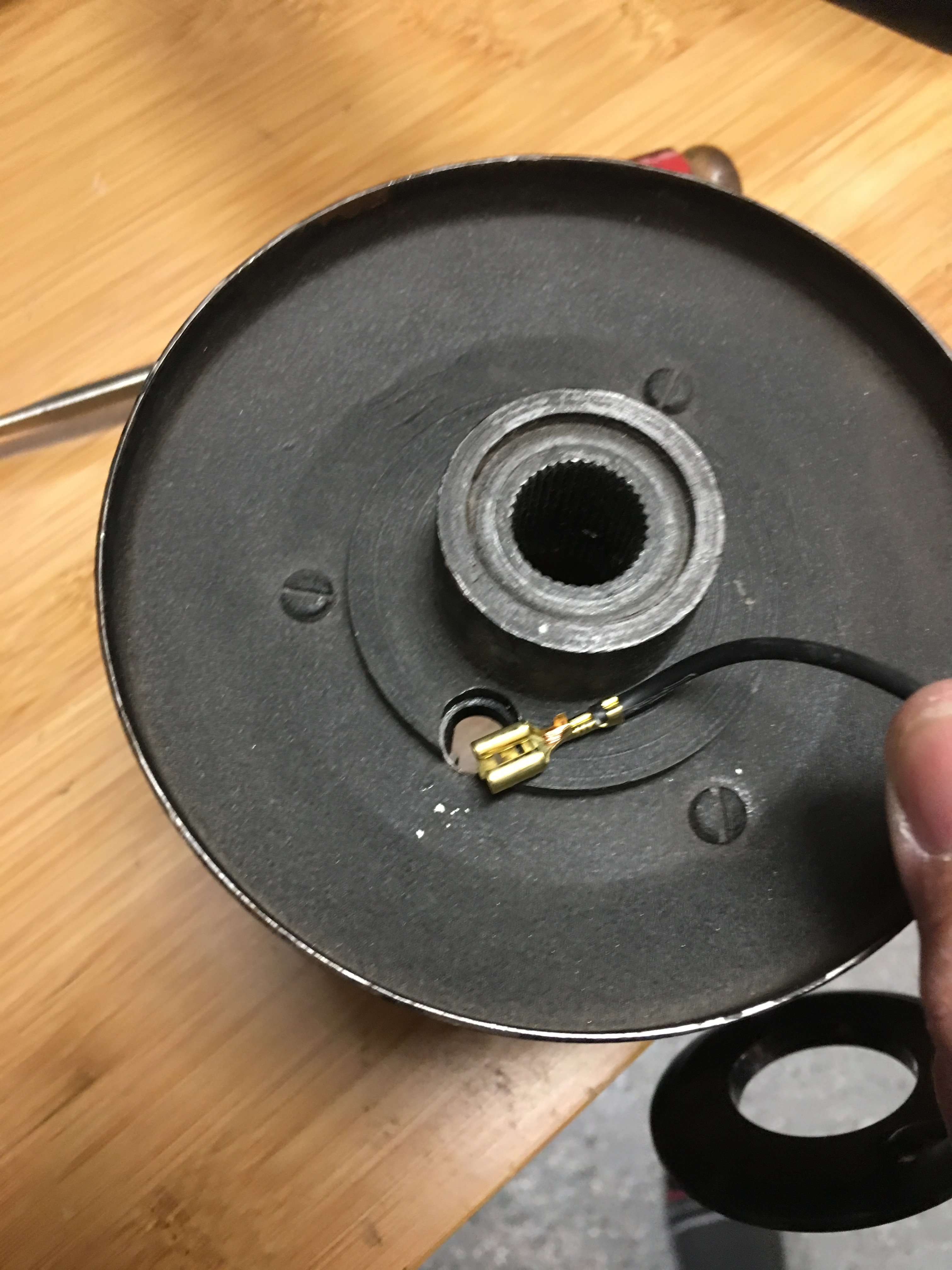

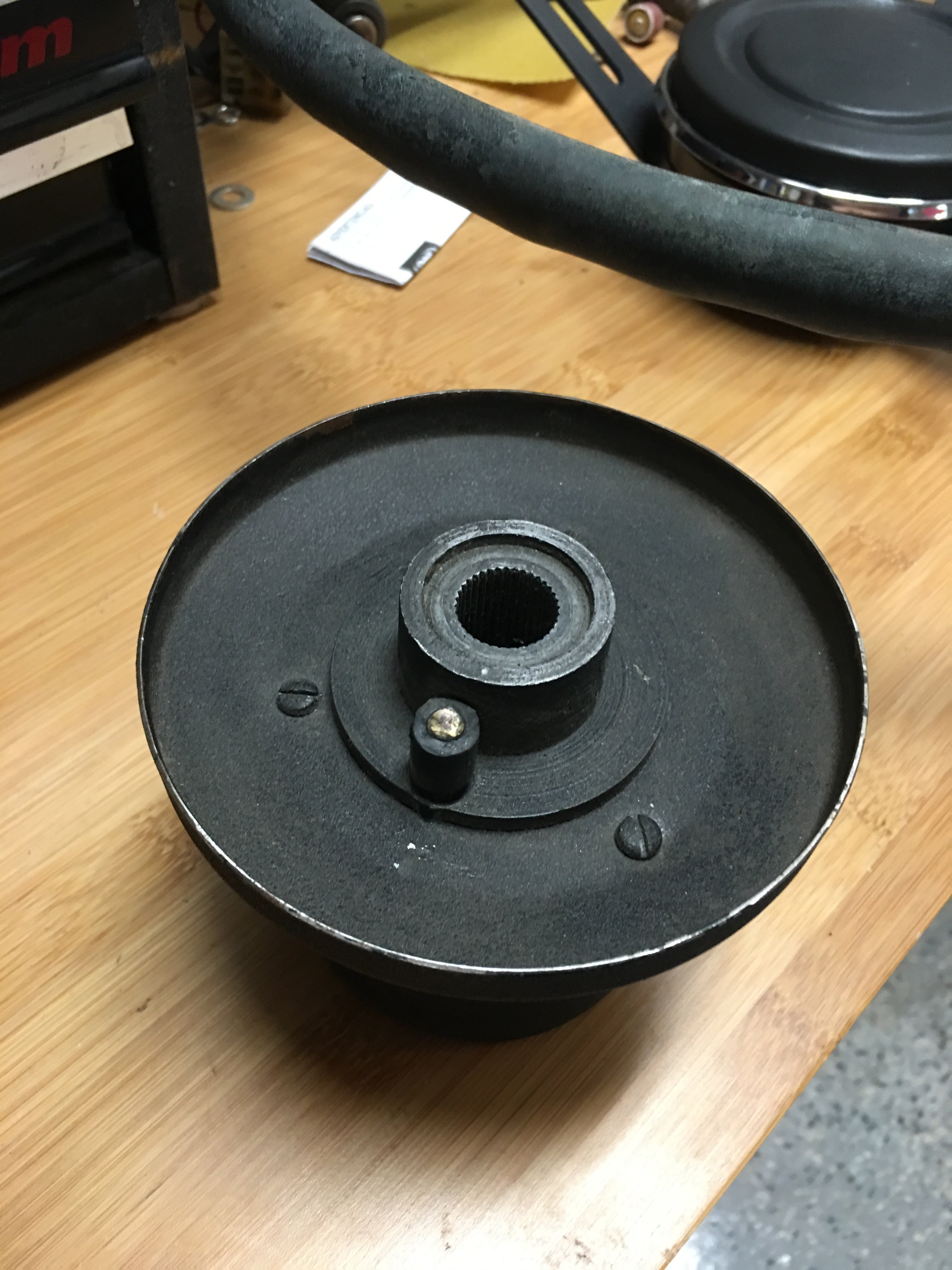

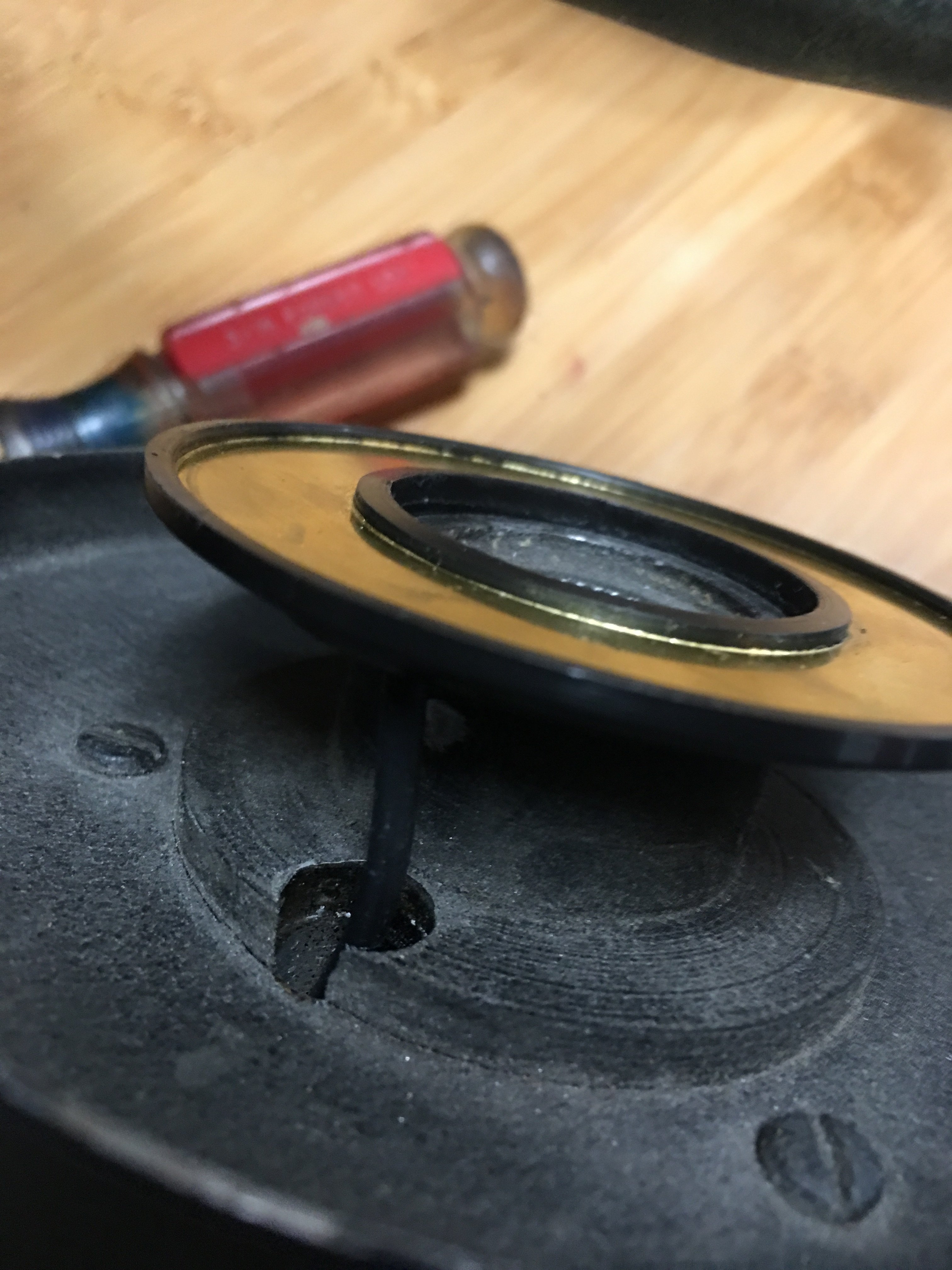

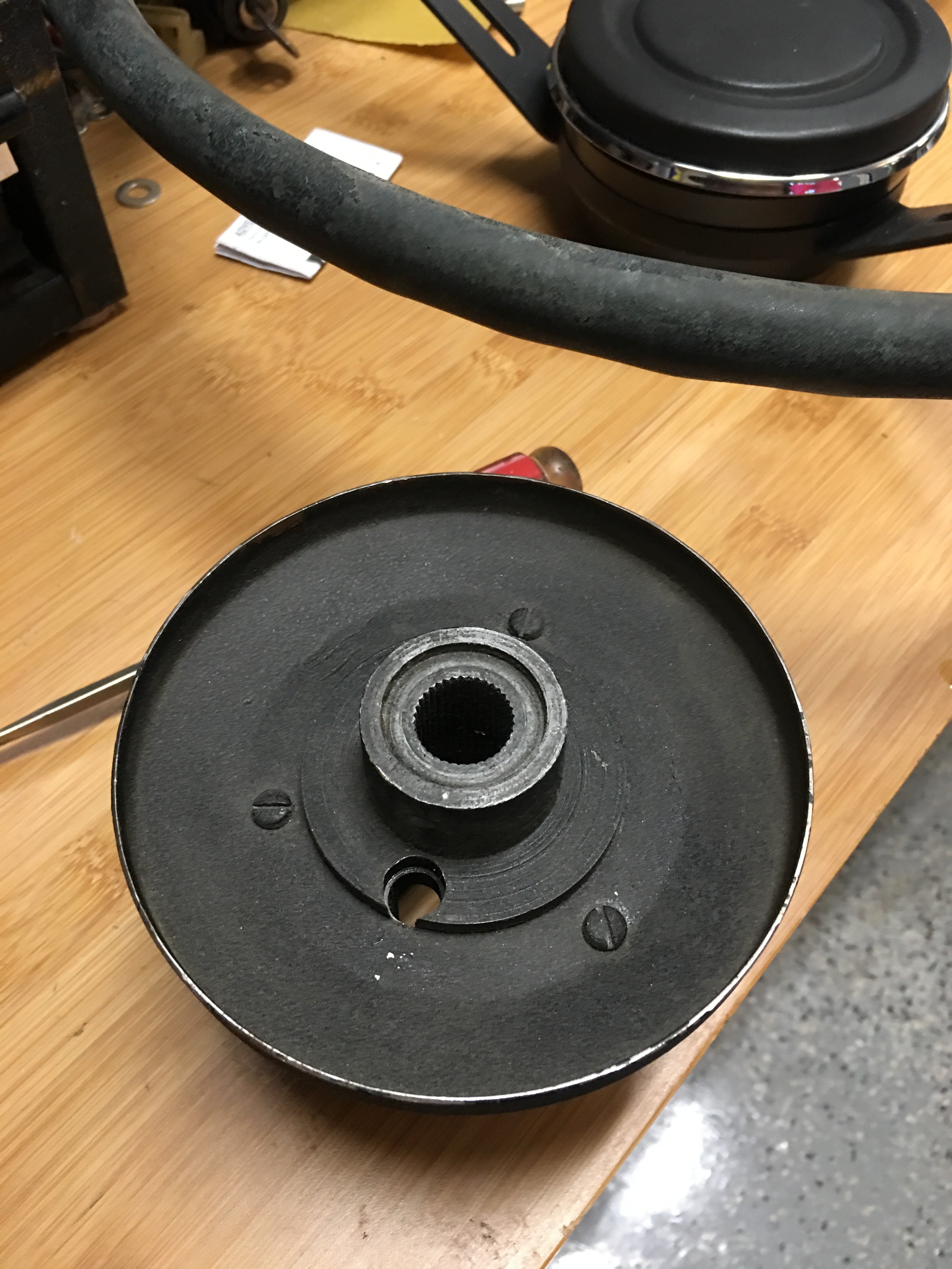

I just did this since I was in the garage. This is a very early solid aluminum 2002 hub with a steel base and a brass plunger. I removed the plunger and took a horn ring and ran the wire where the plunger was. I didn’t press it on all the way because it was very snug.
Would likely need to remove that spacer also.

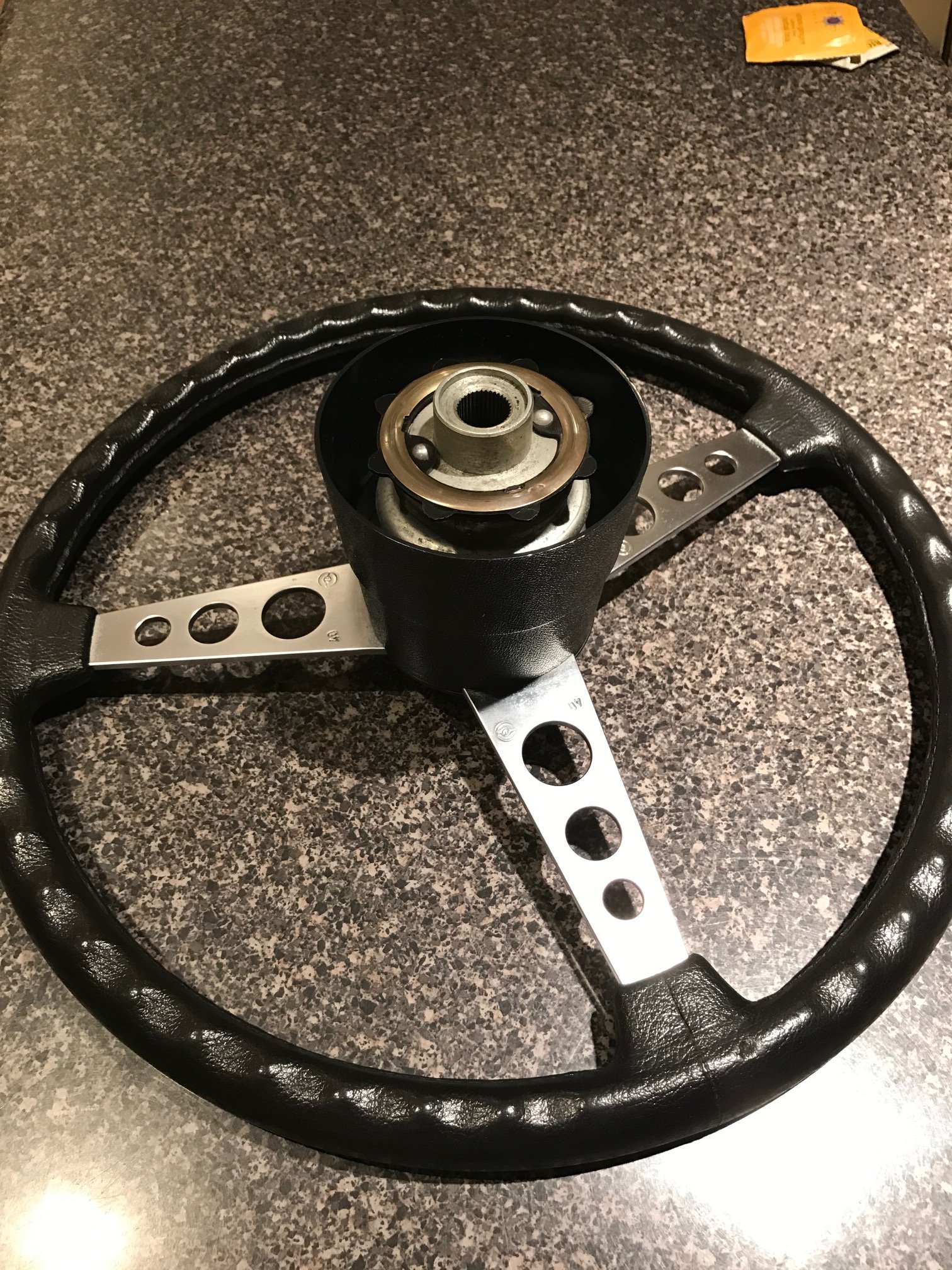

I should mention that if you do t have a petri hub, you will need to mount it to a different hub. If I don’t go with a petri hub for mine, I’ll use a conversion ring or a quick disconnect.
