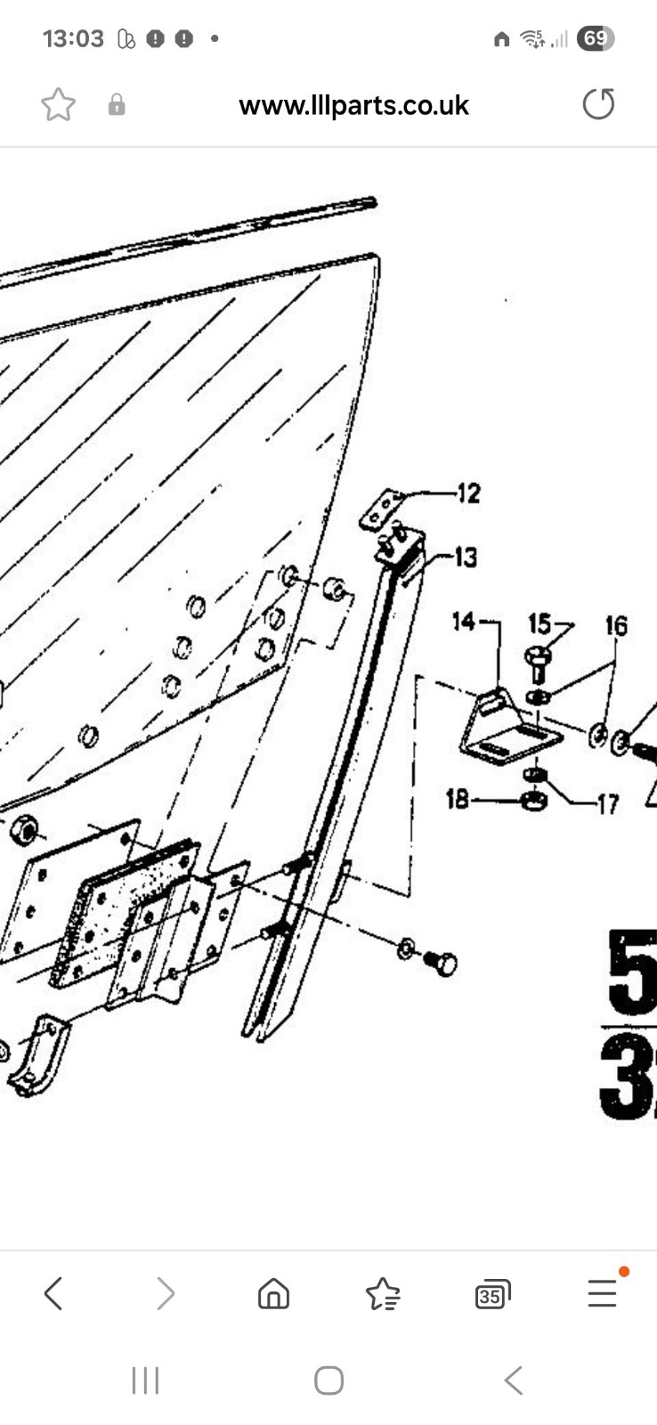

Does anyone have one of these. The bolts at the top of mine have lost their threads. Either a replacement or a way of repairing it would be appreciated.
The part number is 51326754235 or 51326754236 - Real OEM does not specify which is which.
Is it the black, static part through which the sliding block runs? Item #13 in the drawing?
If so, then I would try and retap the top of the m6 thread into an M4 and use an m4 nut. It'll be plenty strong.
I think if you tap to an M5, that then the M5's threads valley's and ridges likely coincide with the old buggered ones. An m4 will use the intact material.
I'll have a look, as my part is out of the car. It might be that the m6 threads are actually pressed into a flange, as the track is some funny metal cast alloy.
This could mean that pressing new ones is perhaps possible.

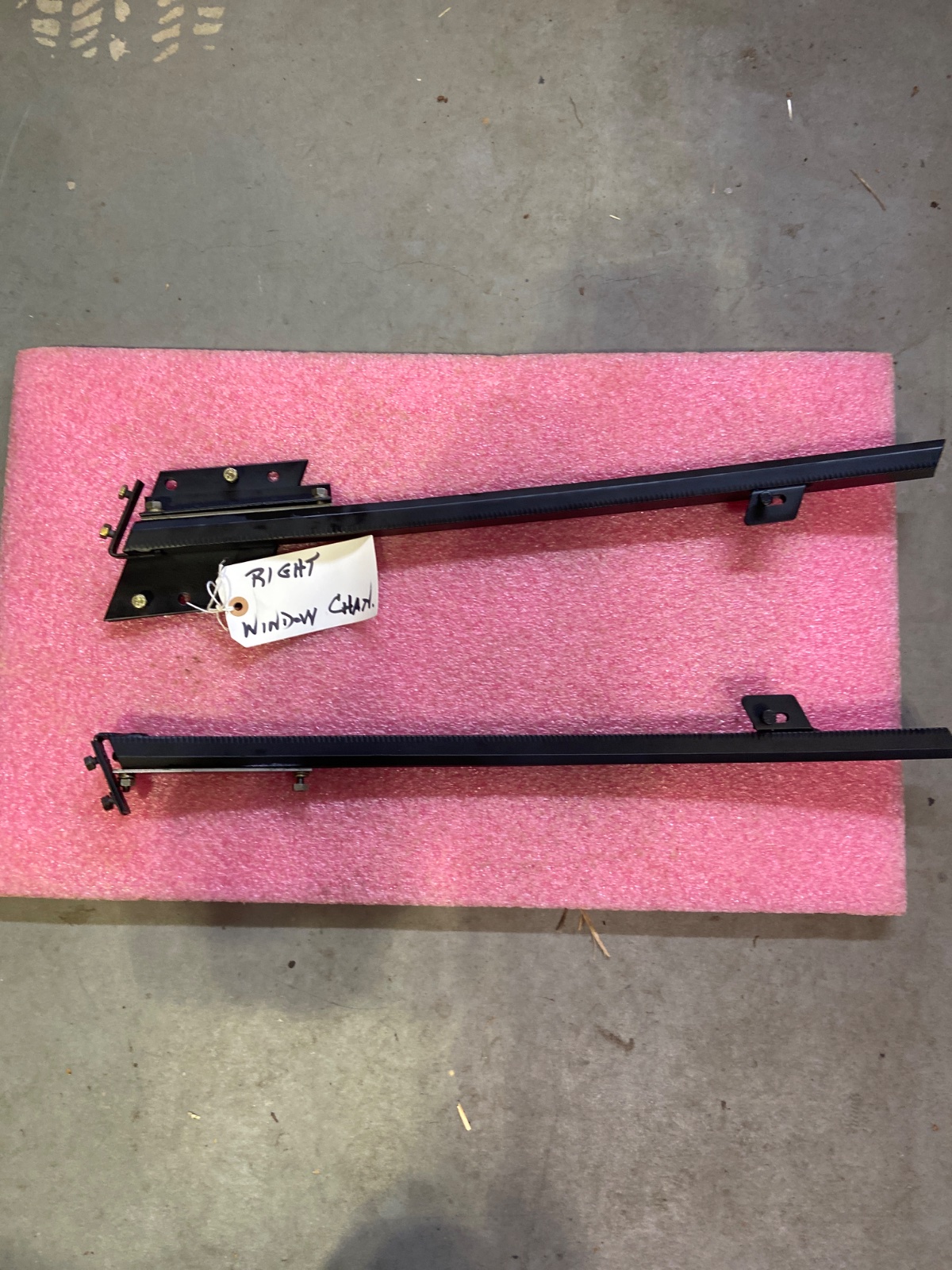

This is what I have as spares. Window guides have been powder coated and lubricants led. A full right assy and a left hand channel guide. Perfect condition.
