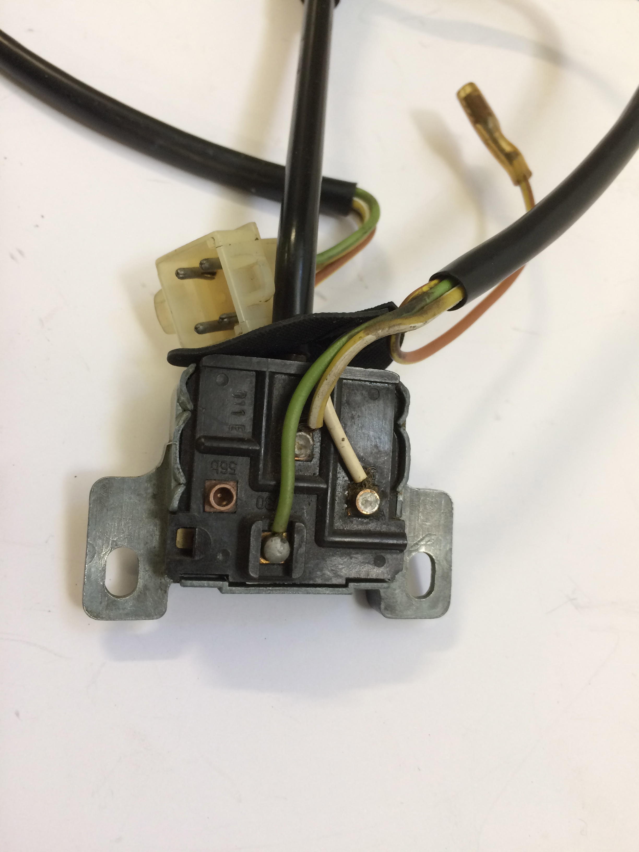

Hi. I have 72 CSI. Do yours work well? Can you send me pictures.
Hi Jahan,
I managed to upload pics. These switches are from pre 74 model.

So now back to the original question would the stalk mounted switches on 2000 NK fit E9?
zinz
1,213
1,216
Austin, Texas
What year is the 2000NK ?
Walloth Nesch has the hi-lo headlight stalk for the very early cars (left side of steering column), but does not have the turn signal stalk (right side of steering column).
The early stalks do not have the wiring harness, but have male connectors on the back of the switches. The switches pictured above, appear to be identical to those found on the later 2002 models. By early, I'm speaking about my 1967, 2000CS. I am not certain when BMW made the change to the wiring harness-style of stalk.
You might look at the NK section of BMW2002FAQ.com for more anwers (the site is being updated at the moment, so expect some downtime there)
I just bought the early hi-lo stalk from W&N and it works perfectly.
The e9 switches are different than what I bought for the 2000CS... very expensive! https://www.wallothnesch.com/en/body-electric/bmw-2-5-cs-3-0-csl-e9/catalog-picture-61-03.html
