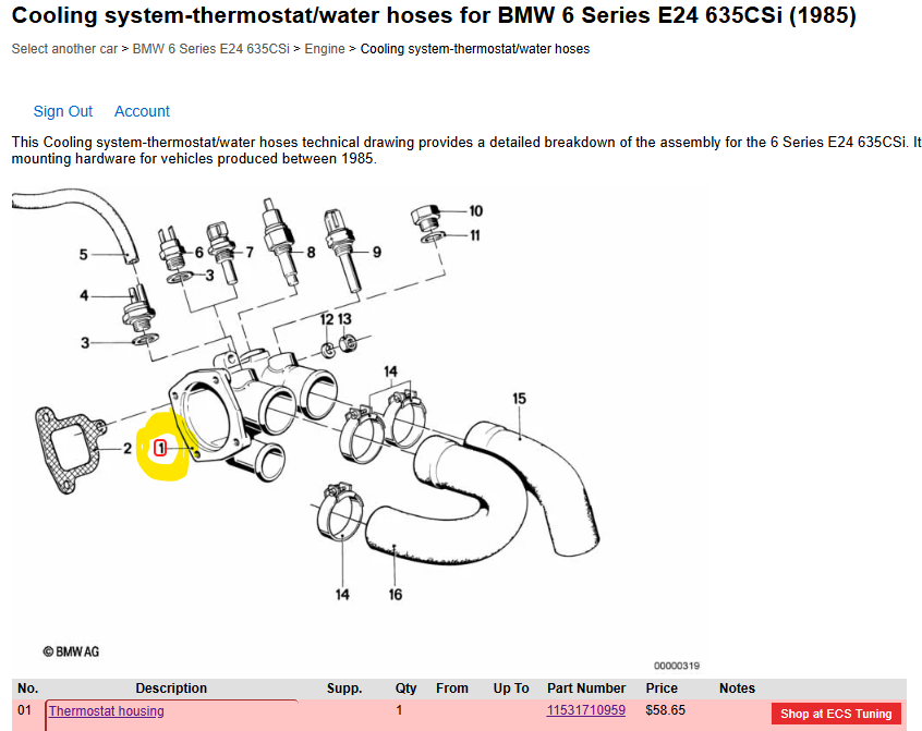

Hmm interesting - I just ordered one from AutoHaus two weeks ago which I returned when I realized I had already ordered the part previously. This is part number 11531710959. I sent it back to them last week so I’d imagine they will have it back in stock (by at least 1) shortly - website says they expect stock soon. Otherwise eBay. Or message Ireland engineering and see if they plan to restock their thermostat kit with housing cover and thermostat.

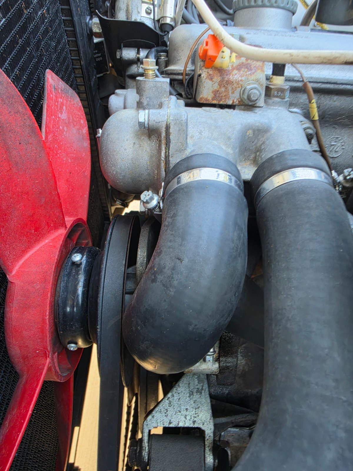

As you all know I'm new to this. Someone here posted under the cooling system upgrade that everyone should be using the latest thermostat housing possible. Is this the right housing for my M30B30 engine?
David
David, the new housing will fit on the m30b30 engine as it fits on all m30 engines. the newer type thermostat ONLY fits in this type of housing ... what i don't know is whether or not you can use the older type of cap / lower hose receiver with the new type of housing. not sure that you can.
