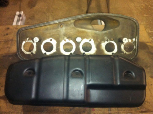

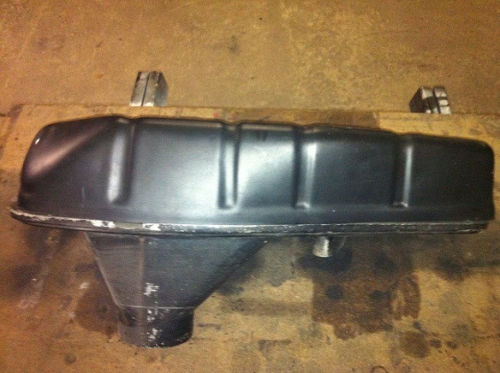

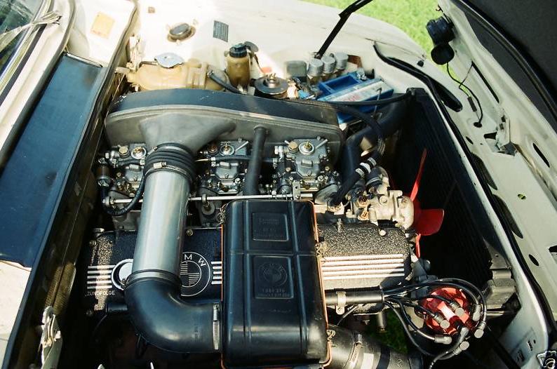

i wonder nobody talks about torque with the Webers.... when we installed them , we went from 300 NM ( oem injection) to 240 NM! ( HP was the same , 210 )
With long inlet tubes and airbox we got that 300 NM back. So it may sound great , but torque loss is pitty.
