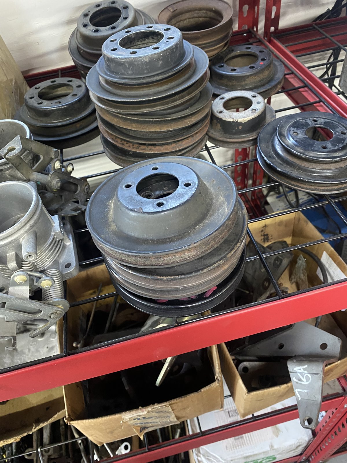

Which pulley are you seeking. A/C is not relevant as A/C runs off crank pulley.
Early water pump pulleys were a double pulley where both the power steering pump and the alternator ran off the water pump pulley.
The later pulleys are single pulley, used when the water pump only runs the alternator and the power steering pump runs off the crank pulley (need a double crank pulley here).
I believe the later single pulley came in both the 130mm and 144mm size. There is also a 102mm size, not sure if this is a double or single.
Start with how is your power steering pump driven? This determines whether you need a double or single water pump pulley.

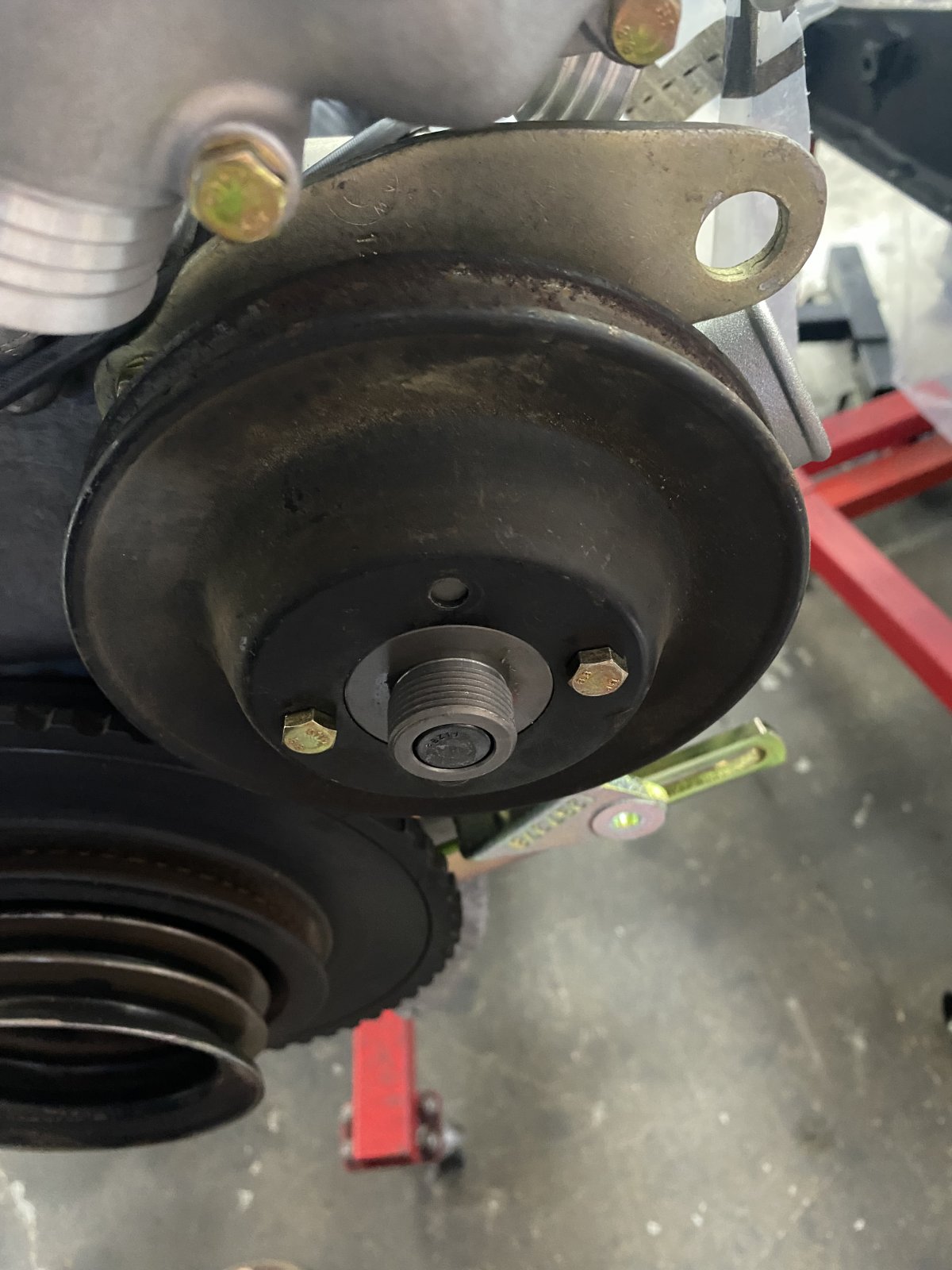

I chose to have no power steering, so I need single pulley with prefferably 130 mm size.
I thought I found this pulley but website I ordered cancel the order so I still need it.
Preferably 130mm pulley needed if not 144mm size also OK. I have to get this in US at Massachusets until 24th
130mm in short supply-
You will need to use the later water pump
144mm are available
bolt holes are asymmetric
