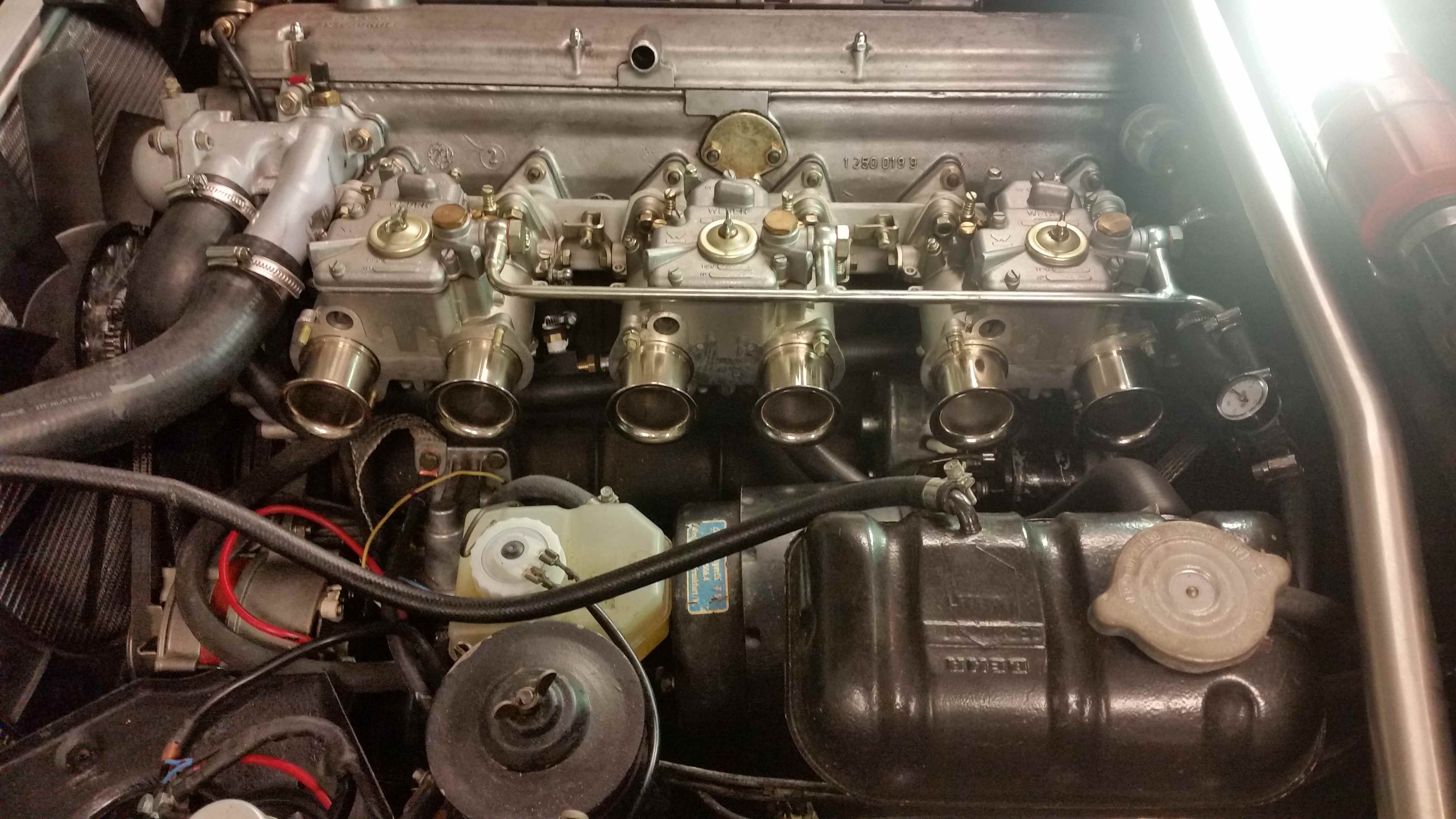

You need to do several things in preparation for triple Webers:
-- install a thermostat housing that will allow room for the first carb (Korman in North Carolina sells one);
-- install a tii brake booster in place of the stock brake booster to allow room for the center carb; and
-- remove the mechanical fuel pump, block off the opening and install an electric fuel pump.
I did all of these things, and tested them with the downdraft DGAVs before I attempted the triple Weber install. You can get by without changing the brake booster, but that would entail different air filtration for the center carb. I did not want to do this.

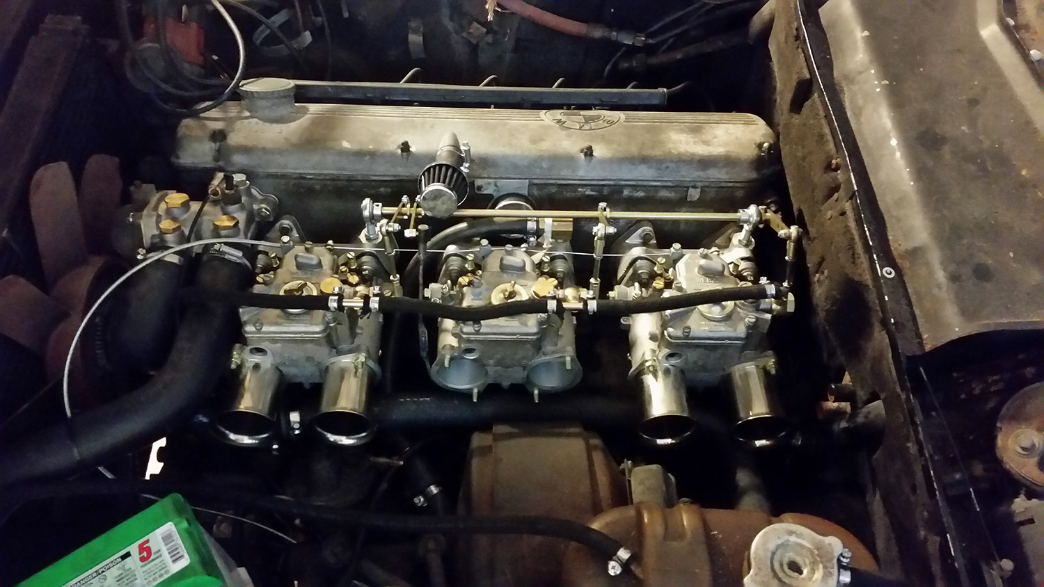

You can see the tstat housing, tii brake booster and fuel pump block off in this picture. My new fuel pump is mounted just forward of the rear subframe.
If you go down this path, these babies will be for sale soon (but I will be keeping the manifold):
We just installed triple Webers as well. Pre-restoration, so the engine compartment is not nearly as pretty as Chris's. Love your fuel line routing, by the way. But we got away with a standard BMW t-stat housing (part number 11 53 1 710 959). Currently have an electric fuel pump in the trunk, but would like to relocate it. And I am looking for a tii brake booster (should anyone have one available...). Can't fit the middle trumpets currently, which the carb does not like... This was just a test fit/run before pulling the engine for chassis work.
These are DCOE 45's I am still determining if this is too much carb for this engine. These have less than an hour of running time on the engine, and may be for sale soon as well (depending the decision above). Sorry if I'm hi-jacking this thread.

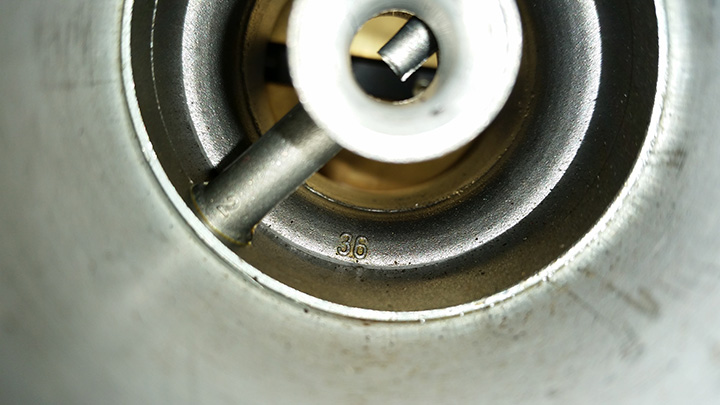

I am still peeling the layers of this onion (learning what a PO has done), but we know it has higher compression piano top pistons (presumed to be 9:1), a larger cam (do not yet know the duration), and a Stahl header. So theoretically it should breathe better. The venturis are currently 36mm.

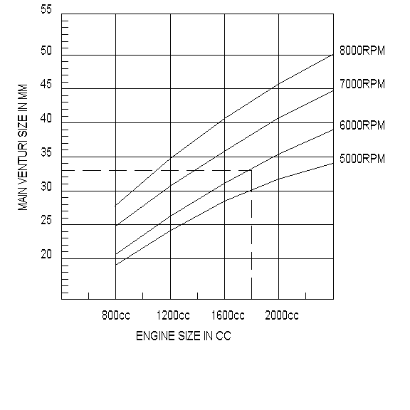

Perhaps a less "knee jerk" solution would be to replace the 36mm venturis with another size. I had found the charts/math to properly size all if this at one time. Can't find it currently, but I think that would provide insight. I'd consulted that reference originally when I purchased the 45's, but I was led to believe the engine was a 3.5 liter replant at the time. That was just the outer skin of the onion... :eek:
One resource that discusses sizing Weber carburetors is at: http://www.s262612653.websitehome.co.uk/DVAndrews/webers.htm
A key chart in David Andrews' write-up looks like this (I believe this chart assumes a 4-cyl engine, so the displacement axis would need to be scaled by 1.5 to apply to a 6-cyl):
Someone told me that the equation behind that table is: Choke Diameter (mm) = (Individual Cylinder Displacement (cc) X max rpm / 2500) ^ 1/2
Plugging some numbers into that equation: Say you have a "3L" BMW engine that actually displaces 2,986 cc. That's 497.7 cc per cylinder. Say your maximum intended rpm is 5,500. The square root of [497.7 x 5,500 / 2,500] = 33.09. Since Weber chokes typically come in even sizes, you would want to use a 32 or 34 mm choke.
What I believe this accomplishes to ensure that the airspeed through the venturi is not too low at idle to allow the fuel to atomize, nor so high at peak rpm that the flow becomes turbulent.
YES! That is the equation I once knew. And in doing the same calcs for a 3.5 liter the resulting venture size is 35.8 (36). When you multiply that by 1.25 you get a barrel diameter of 45. That is what led to my current purchase. I will still need to decide if I will live with the 45's and maybe replace the chokes with 34's. Or sell these "one-hour old" 45's and replace with 40's for this engine. Either way, I am committed to the triple carb solution. :D
