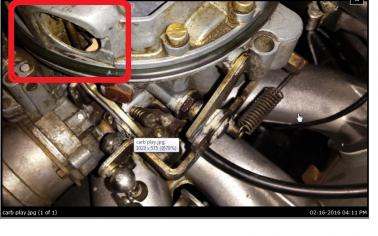

First, thanks everyone, attached is a picture; in the center you can see a hex nut that is a little wet- when I move the throttle that shaft has really excessive wobble and if anyone has a spare, and possibly a rebuild kit I would be happy to pay. Also, if whoever has the needed part has them close by I could give them my fed-ex account number and maybe have it here by Friday as I have a friend who could do the work for me this weekend. Speed of delivery is not critical, but if it's easy....

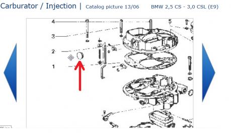

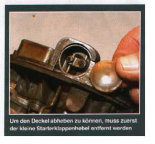

no solution, but
Are you perhaps also missing a cover?
See attached your pic with a red square. I believe that that hole needs to be closed of with a cap as well.
I have been trying to find two for my car, but i haven't been able to dig them up anywhere. So i might be wrong, but they do appear in the parts books.

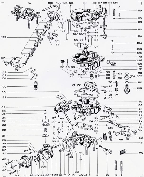

good find, but irrelevant IMHO
those covers are for avoiding dirt entering direct to the levers, you can see that the opening below is always open :-/
