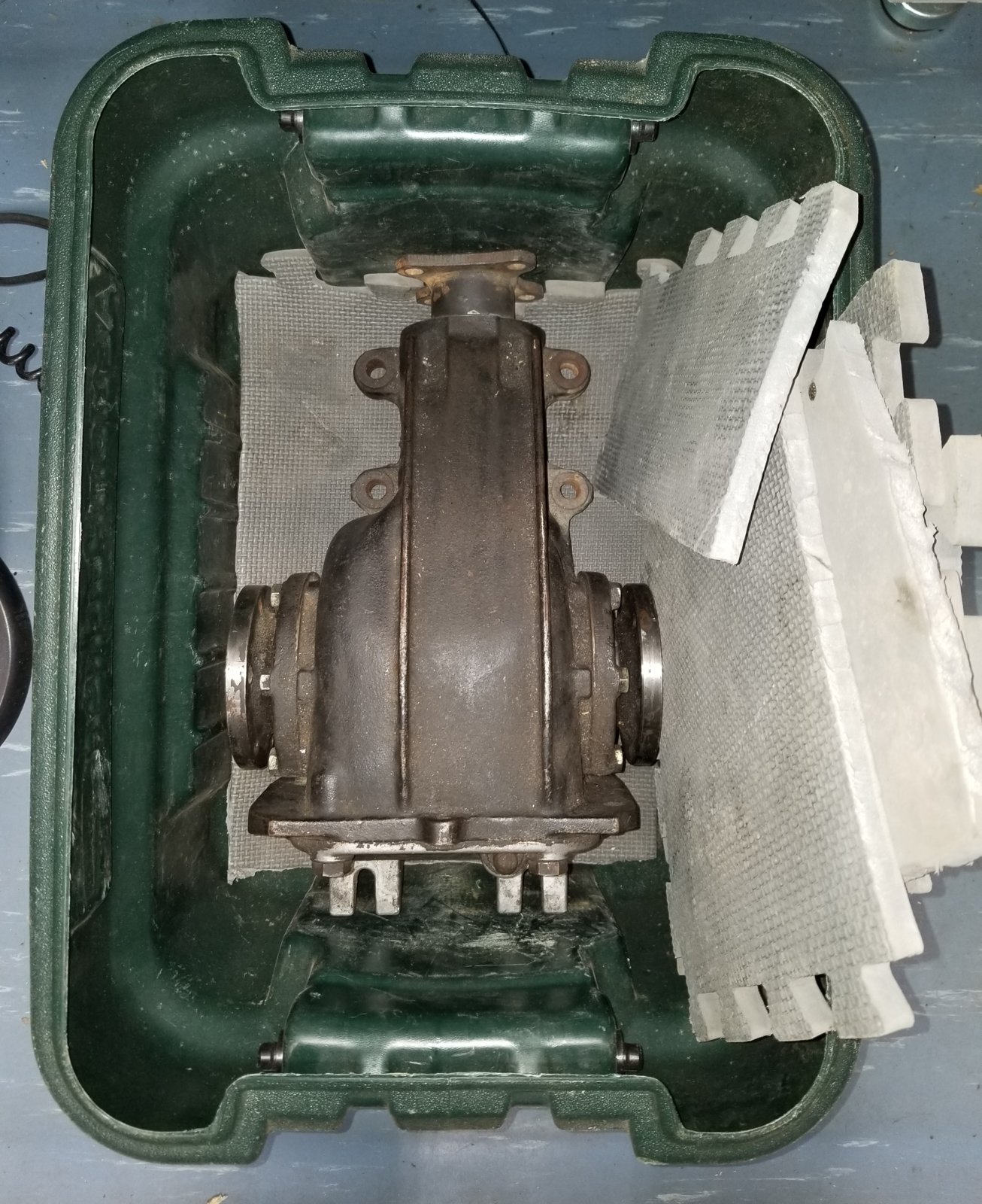

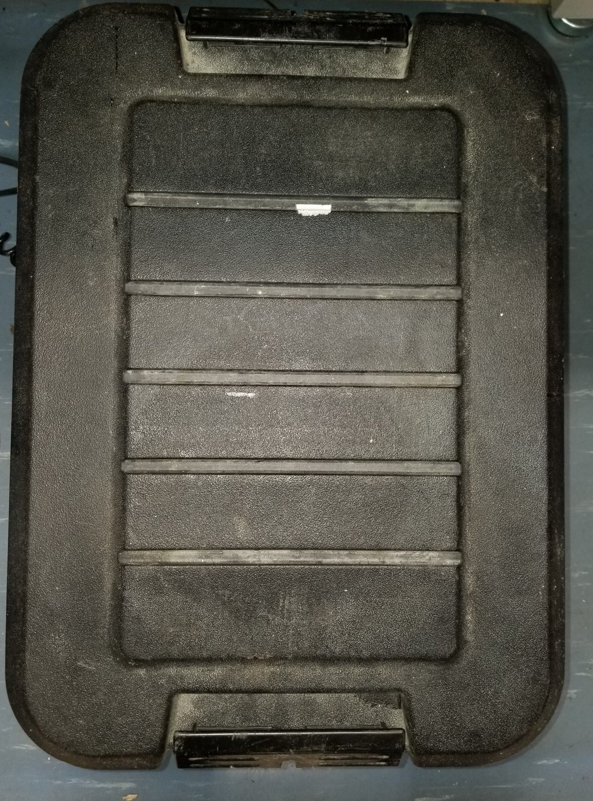

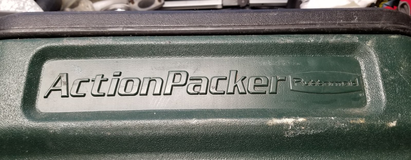

I haven't yet shipped a diff for the e9's but I've shipped many for the '02's. Use a Rubbermaid Heavy Duty storage container of the right size to hold the diff and some thick foam padding on all sides. Surround the diff with the foam padding making sure it can't move. That is the single most important technique for shipping any heavy item-- secure it so that it is immobile inside the container. I've even used milk crates for the '02 diffs. See pics.

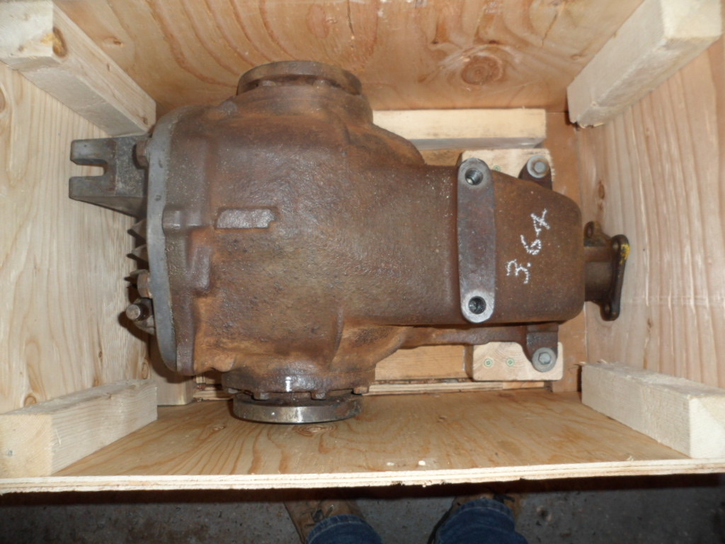

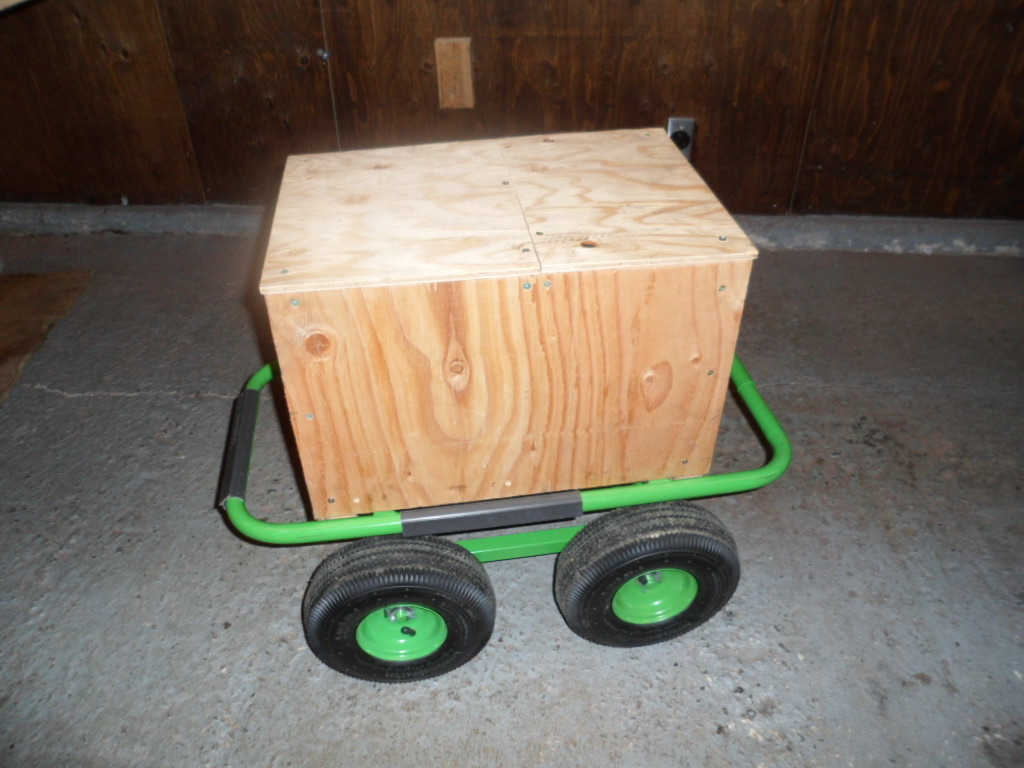

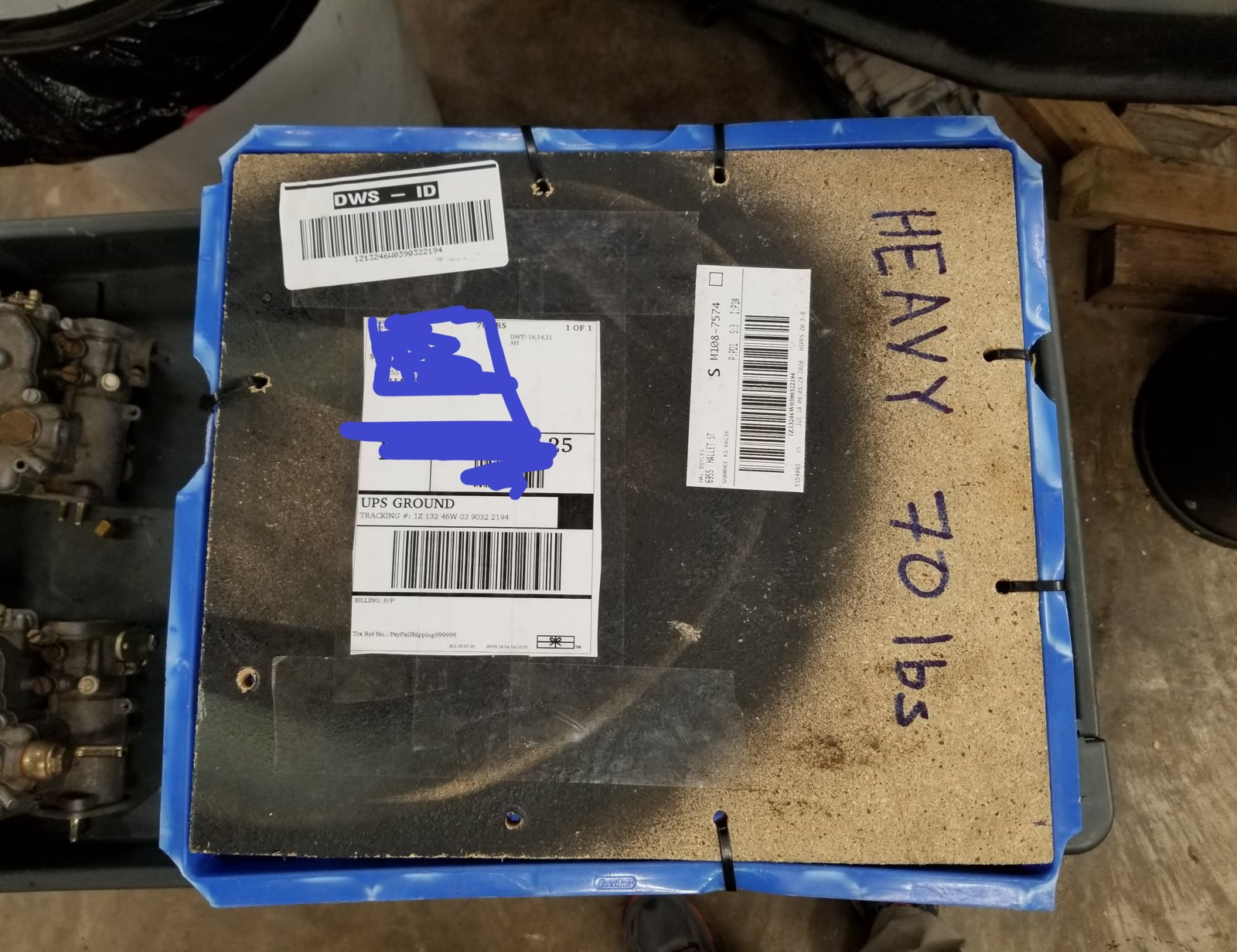

I shipped a 210mm large case LSD to diffsonline not long ago. Built a robust custom "crate" to hold it and secure it tight inside. Very heavy, but it got to where it was going. Important to make sure the unit is drained and dry. Nothing interrupts a shipment's travels more than a puddle dribbling out of a seam of any carton. :cool:
B58FD212-C5A2-4747-BB4C-BC68711528C2_1_105_c.jpegC1055654-C876-4789-9465-4C858FF46C33_1_105_c.jpeg

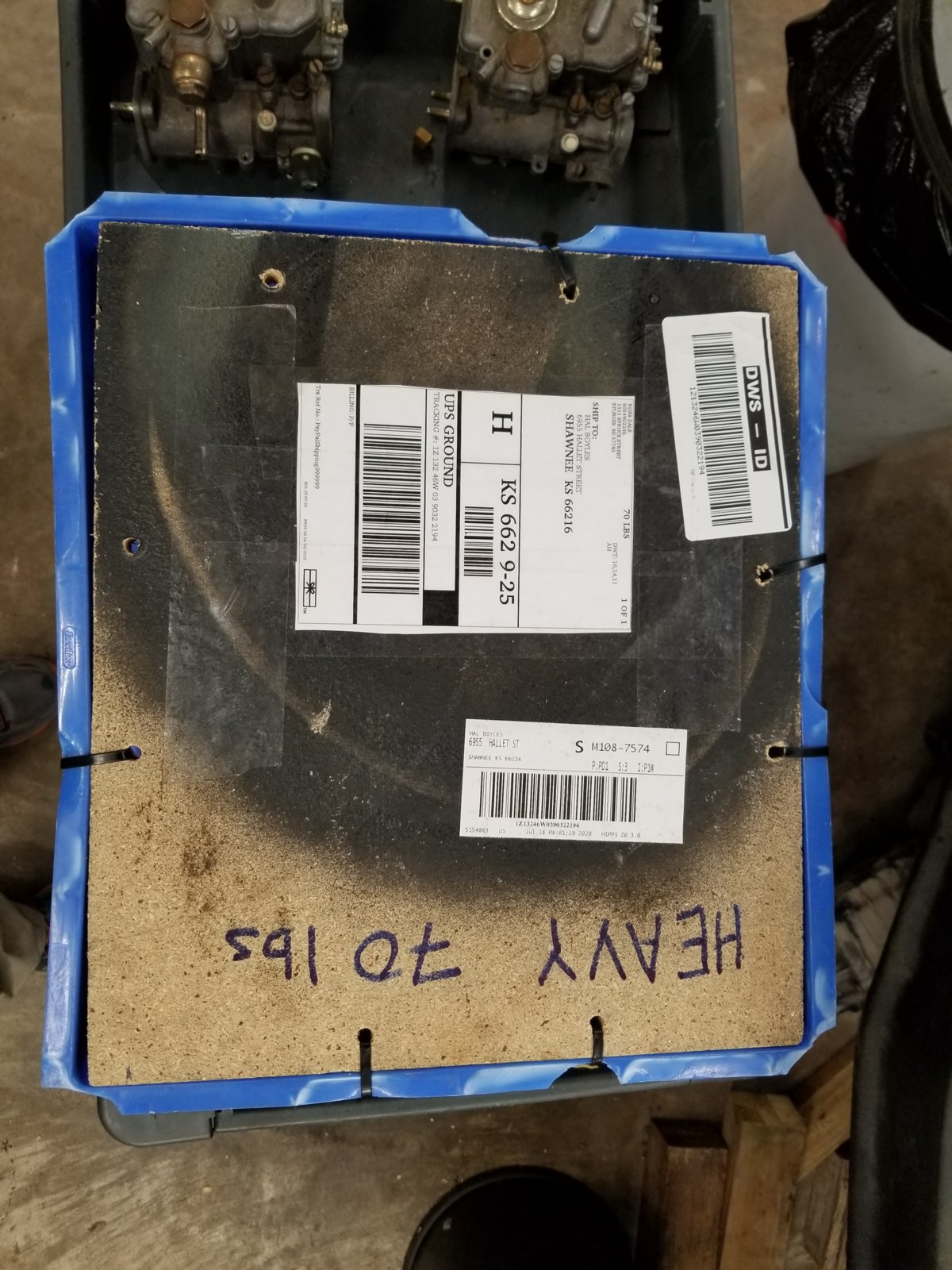

Ups, in a black storage tub from home depot. Less than a $100 cross country. That is direct at a UPS depot not through a mail store franchise. Buy a sheet of construction foam and put a layer on the bottom of the tub and pack the rest around the diff. You can screw the top down with short sheet metal screws. I put 1x2 around the upper perimeter of the tub, screw it it in from the sides, and then screw the top to that. I have shipped at least a dozen diffs and trannies like that and there has not been a problem. The tub and foam will cost you about $15 Franchise store will hit you for at least $140
