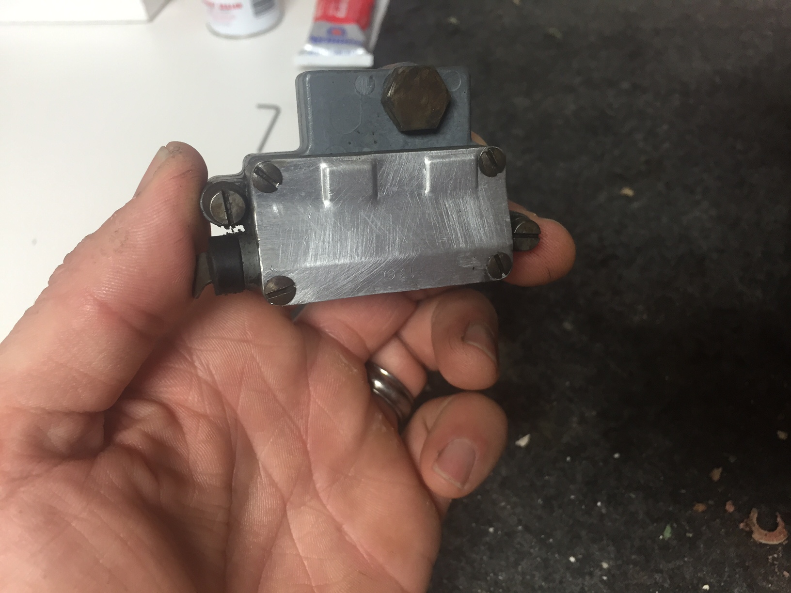

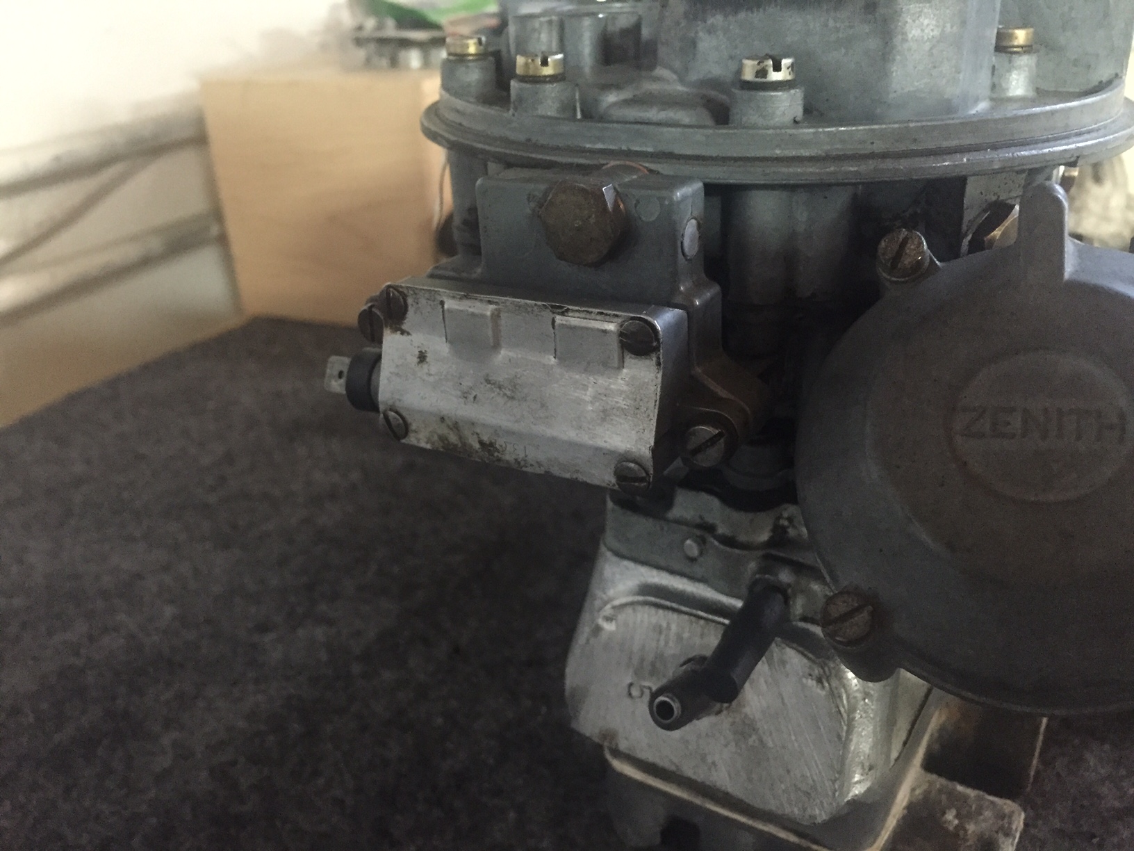

deQuincey, sorry, I didn't do a good job of describing the part...:-) It's the thermostatic valve that provides electrical assistance in heating the bimetallic spring in the choke housing that does have coolant flowing through it. I found it on W&N but it's 170bps...yikes. I managed to disassemble it next to my other one that is nicely intact and solder it back together again. Will it work? Time will tell...;-)
Honolulu, yes, you're correct. I guess my frustration was not being able to find really good info, not just on how it basically worked, but what people have done when it's too far gone to repair.. I understand going for simpler with the webers, too, but I'd love to make these babies sing again! I've redone many different carbs on lots of cars and feel like I'll be able to get it there if I can find answers to these things. So, THANK YOU to all of you guys on here!!! I love being able to have a resource like this. Here are a couple shots of the Thermo valves now.. and yes, I'll take care of the last bits of grease on there before they go back on...:-)

View attachment 19258 View attachment 19259
there is no coolant across that one, this has only an electrical resistance and a bimetallic plate with a small tip that acts like a valve for the passing air
moreover if you drive in a climate that has no low temperatures you can bypass it
Yes, that's what I had said....it only assists the choke that has coolant flowing through it by helping heat the metallic spring during warm up.. It does NOT have coolant going to it. We're saying the same thing...:). I know it never had coolant in it...I just wondered how important it was in the choke/initial warm up portion of the cold start... But I think I have it back together again, and it's actually a very simple mechanism...Also hoping that, being in SoCal, It probably won't get cold very often to rely on it much. Thanks again for all the replies, it's always very helpful to toss the info back and forth, as it usually helps me think of something I missed..great way to solve things. Thanks!!

edit*: yes, bypassing it was what I was wondering about..so if it ends up not working I'll probably just take it out of the loop. Thank you deQuincey!
bypass in socal, absolutely !
there are meant for cold start below 15 deg cels
for bypassing simply remove the pointed tip, do nt remove the whole thing, you can leave a piece of electric wire for aesthetic purposes
