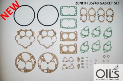

Planning on redoing the Zeniths on the e3 from the ground up next winter, I have an order going out from W&N now and thought I should take the gasket kits at the same time.
Anybody used these gaskets? Are these okay or should I source them from somewhere else? Are there O-rings etc. that I need, which isn't included in this kit?
Looks like those don't include the accel pump skirt or secondary vacuum pull downs, look into the Royze kits, they are better than the Walker ones. You'll likely reuse the float valves.
Get a large box, low sides, like one that fruit is shipped in. Take apart and rebuild in the box so you cannot lose anything. Take photos as you go, refer to tech section here also. I think accel plunger and float bowl setting was the most tedious.

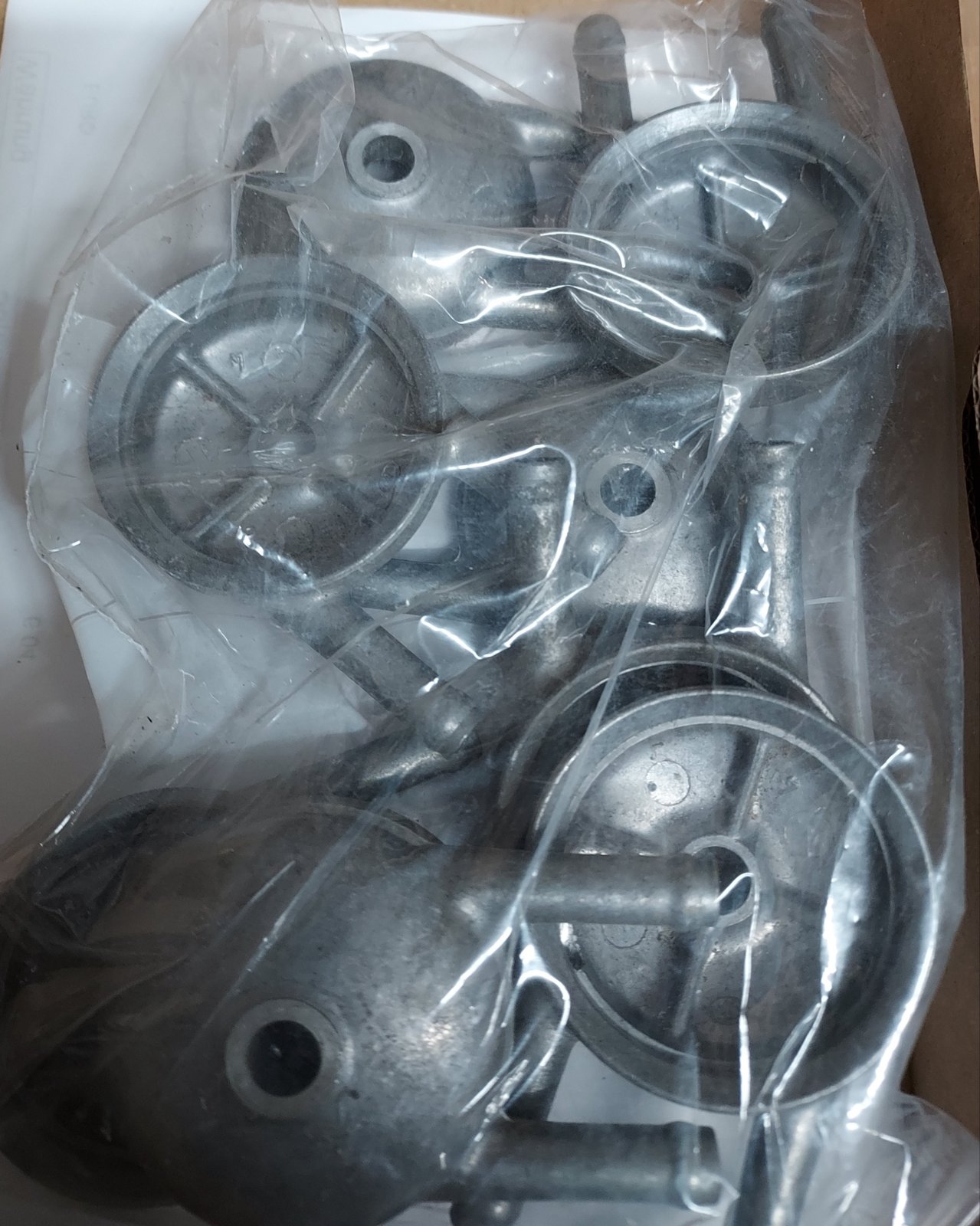

some info there
Found some of these,...recientemente
