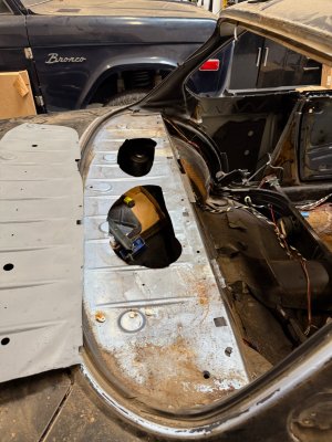

    Found the female spade ground right where you said it was, near the tank.

    Found the female spade ground connector. Now to find it's home..

    A ground wire is never black they are always brown. If near the starter it may come from the 12:00 terminal and is hot when cranking...

    That double black wire comes from your ignition switch to that spade connector and then goes to your diagnostic plug. It is the crank...

    Hi all, Found this little guy dangling near the starter. 2 Black wires crimped together, possible ground? Can't find his home plug...

    Chris Reber posted the thread 72 CSi wiring in E9 Discussion.
