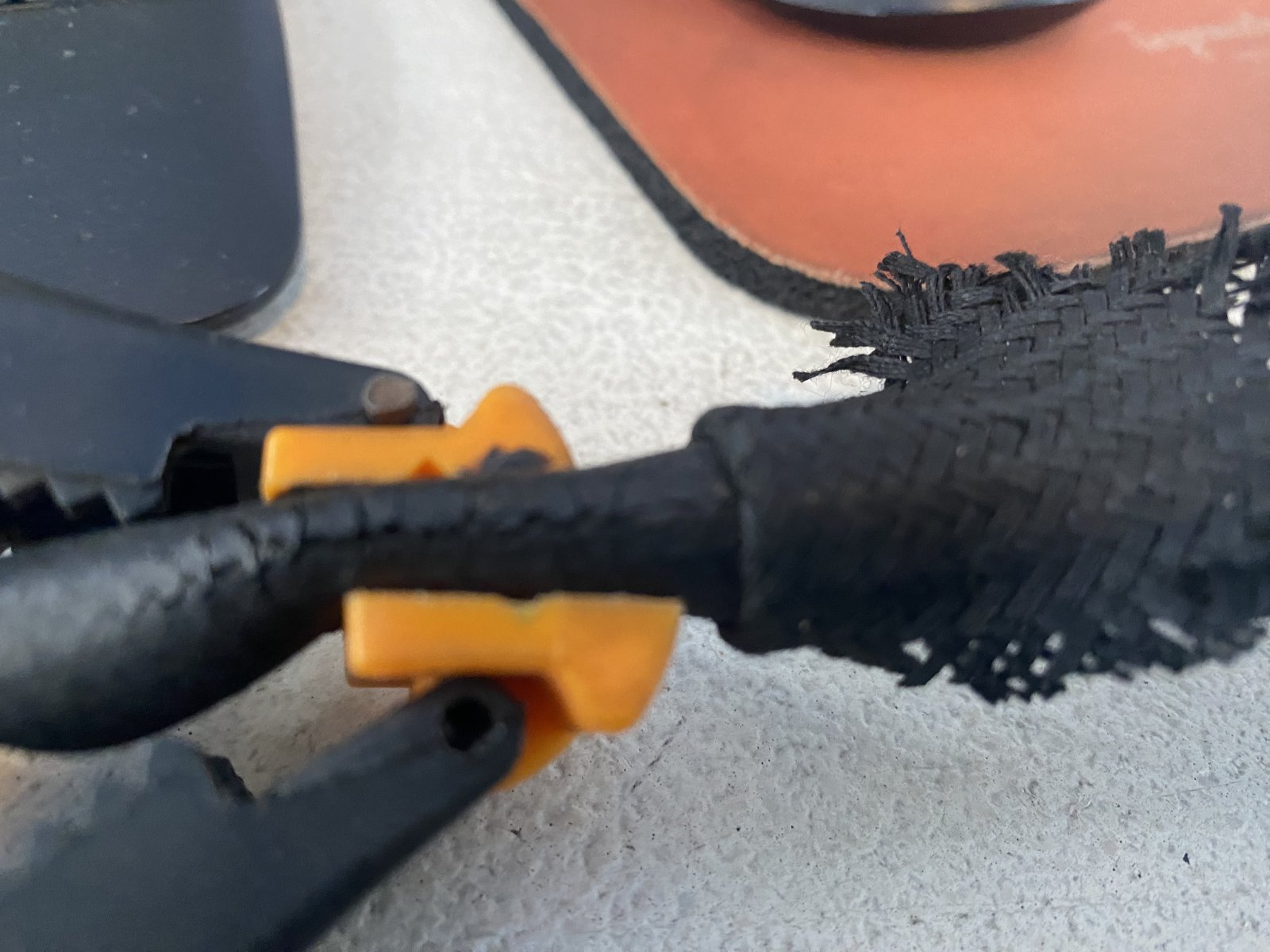

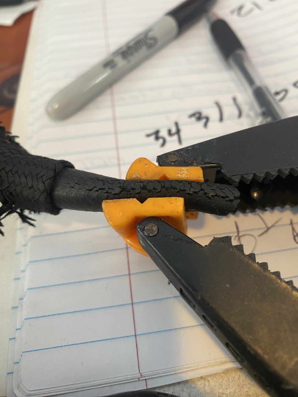

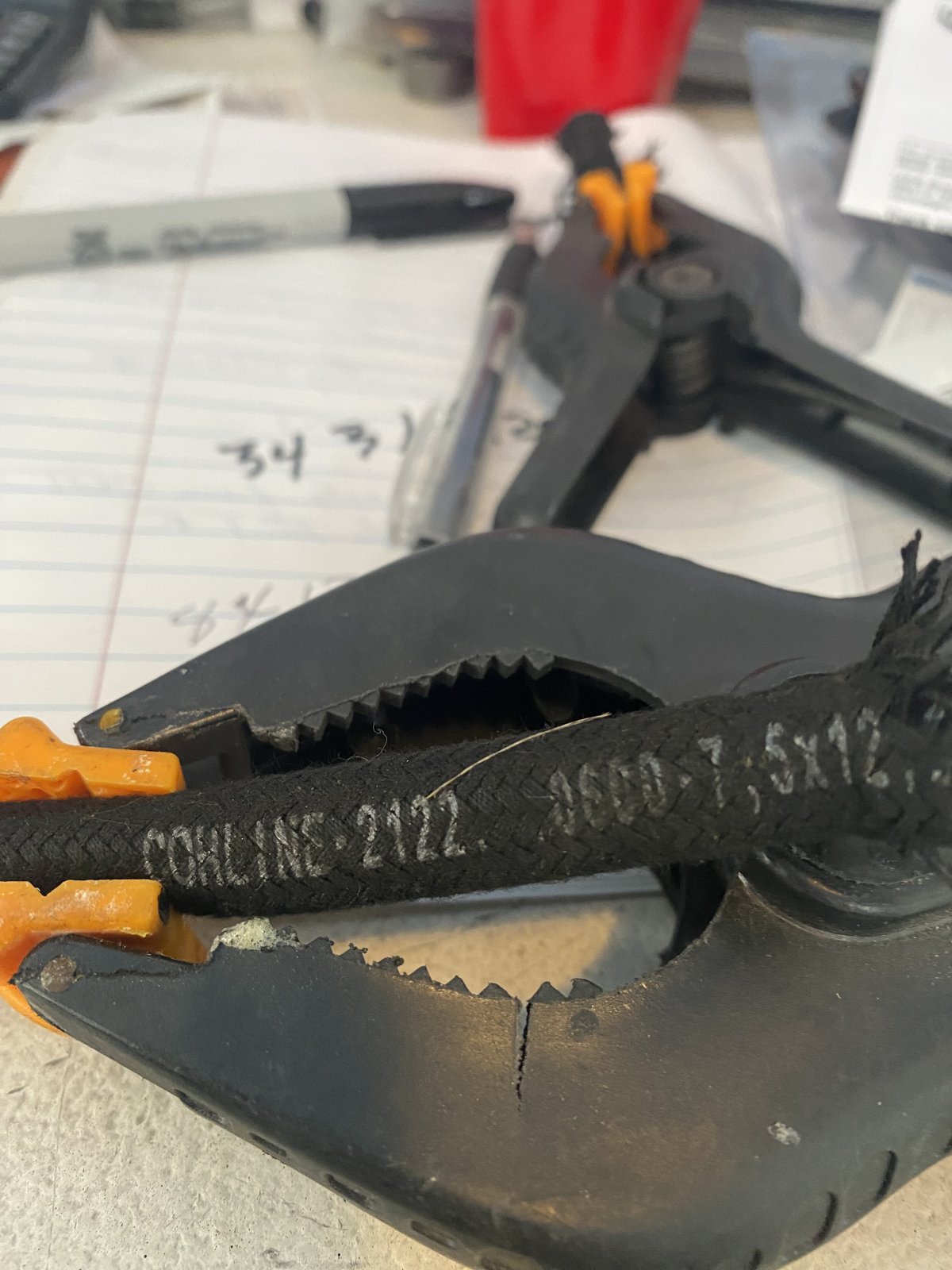

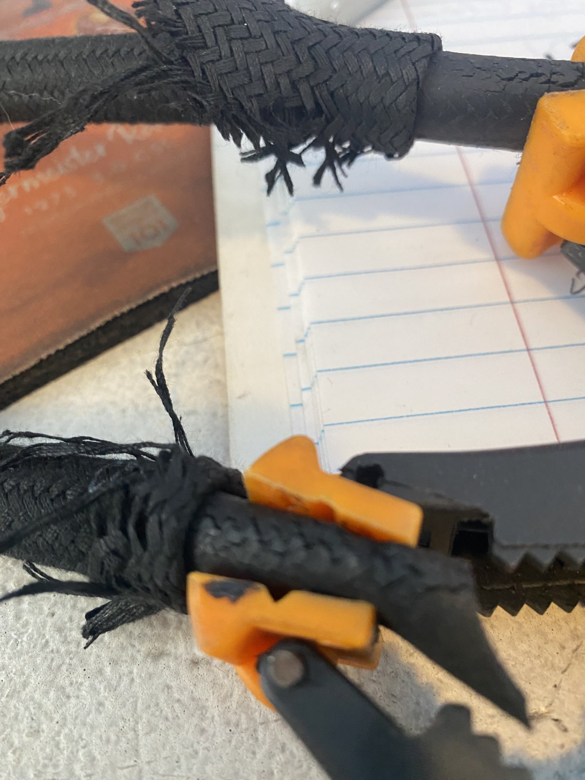

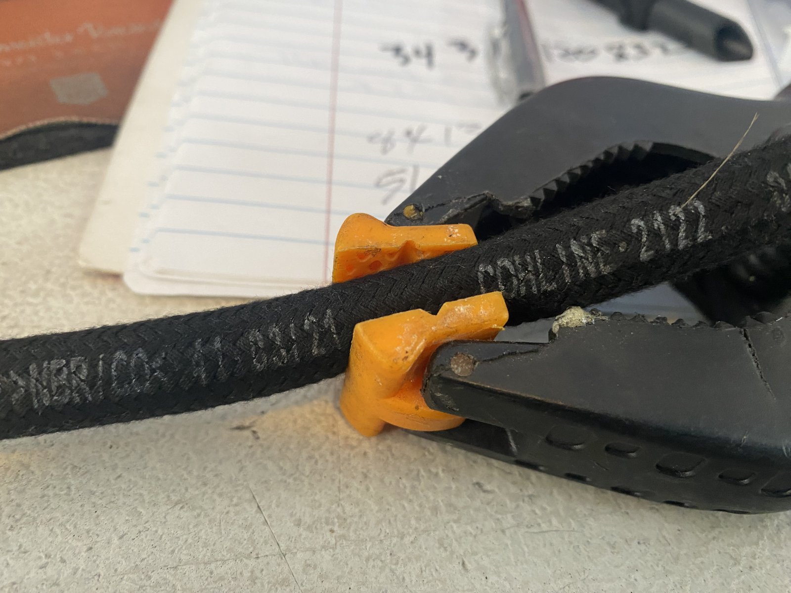

Absolute fire hazard from defective product. Car towed in yesterday with 1 1/2 year old hose squirting gas onto the firewall.
The fabric on Cohline 2122 conceals the rapid cracking that is occuring.
This defective hose is being talked about all over the internet with Cohline refusing to acknowledge.
