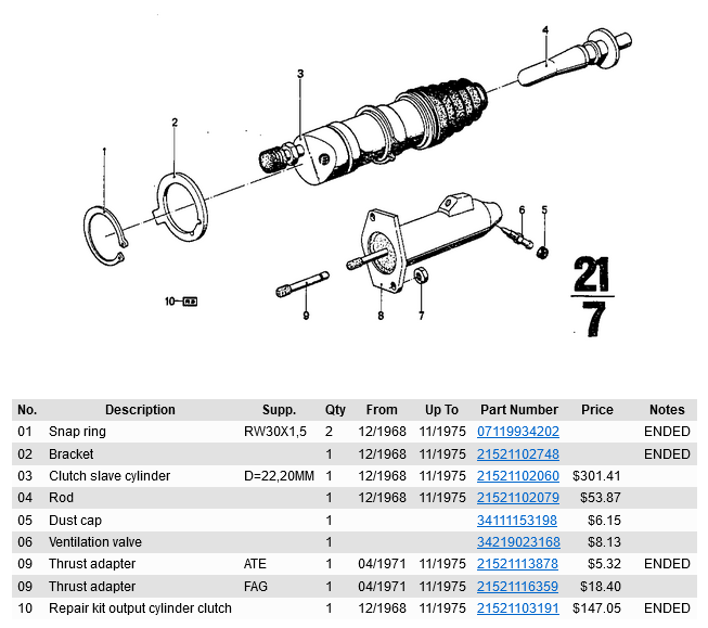

Dave,
do you have 4 speed or a 5 speed in the car? - it does make a difference. the upper slave is for the 4 speed / early e3 + e9 ... the lower slave is for the 5 speed / late e3 + e9
davi duma
New Member
7
1
ont. canada N9E 277
Dave,
Thanks for responding. I have the cylinder with the supporting ring & clips. The picture on the bottom has bolt holes used to secure the cylinder directly to the block. What's missing in the pic is the bracket that holds the cylinder to the block...upper pic . .thanks again . . Dave
