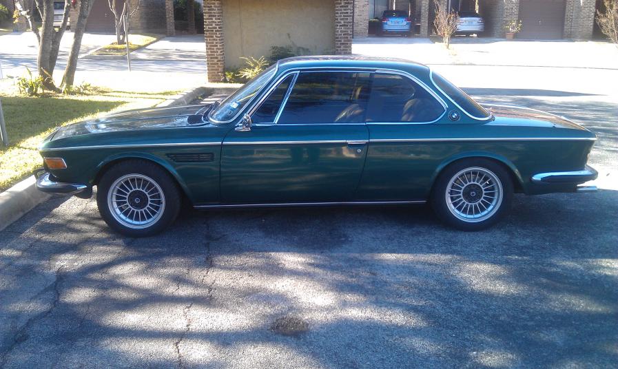

The swap out is going slow as I am having to 'soak' a lot of nuts to get them freed. I'm leaving tomorrow for a small football game in Miami on Monday, so may not finish until next week. Not that it matters, but here is a 'before' photo (note car on slight incline). Will be reading up on all of the threads on rolling the fenders while on the trip.

Well, it got a bit easier and was able to finish this morning. Took it on a careful test drive and so far I can discern no rubbing. "After" photo below. It looks like the rear came down more than the front, but not sure. Of course, in the "if it's not one thing, it's another" category, the starboard rear muffler hanger broke and it's bumping around back there now. Once I get that fettled, will slowly become more aggressive with maneuvering and speed bumps. But as for 'normal' driving, it seems ok. The car has the Coupeking staggered Alpinas and the usual 205/55 and 225/50 Conti HD. I am not going to declare victory until after a more thorough evaluation for tire rubbing.
Noticibly much tighter ride, which pleasantly surprised. Car just feels more solid in general. Will have the swaybars in a week or so to complete the package.
Looking under the car, the exhaust is really falling apart anyway, so will hit the search function and see what others have done.

Stock and Korman springs - side by side
Parked the car in the same place to provide a direct side to side comparison to folks considering Korman high rate and lower springs. The Korman sway bars should arrive Monday, and an Orangener strut tower bar completes the package.
Have found a local rentable fender roller. Plan on the recommended 10-2 o'clock roll. So far, no problem rubbing but I am not pushing.
