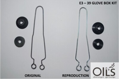

Hi Drew,
I saw this on ebay..It may be of use to you.
Cheers
Johnny, This part is used on the smaller driver's side compartment. Note the seller is Alvaro, (@alprada70) who is a forum member who makes several reproduction parts for BMW's.

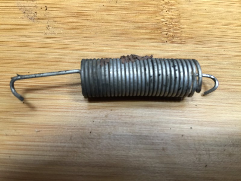

There is a spring that goes from the glove box hinge to the a-pillar. The steel is about 1mm in diameter, about 15mm in diameter. About 40 coils, one short hook, one long hook. About 40mm long. That's off the top of my head. I'll measure it tonight or tomorrow.

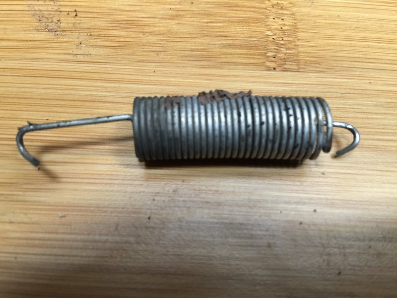

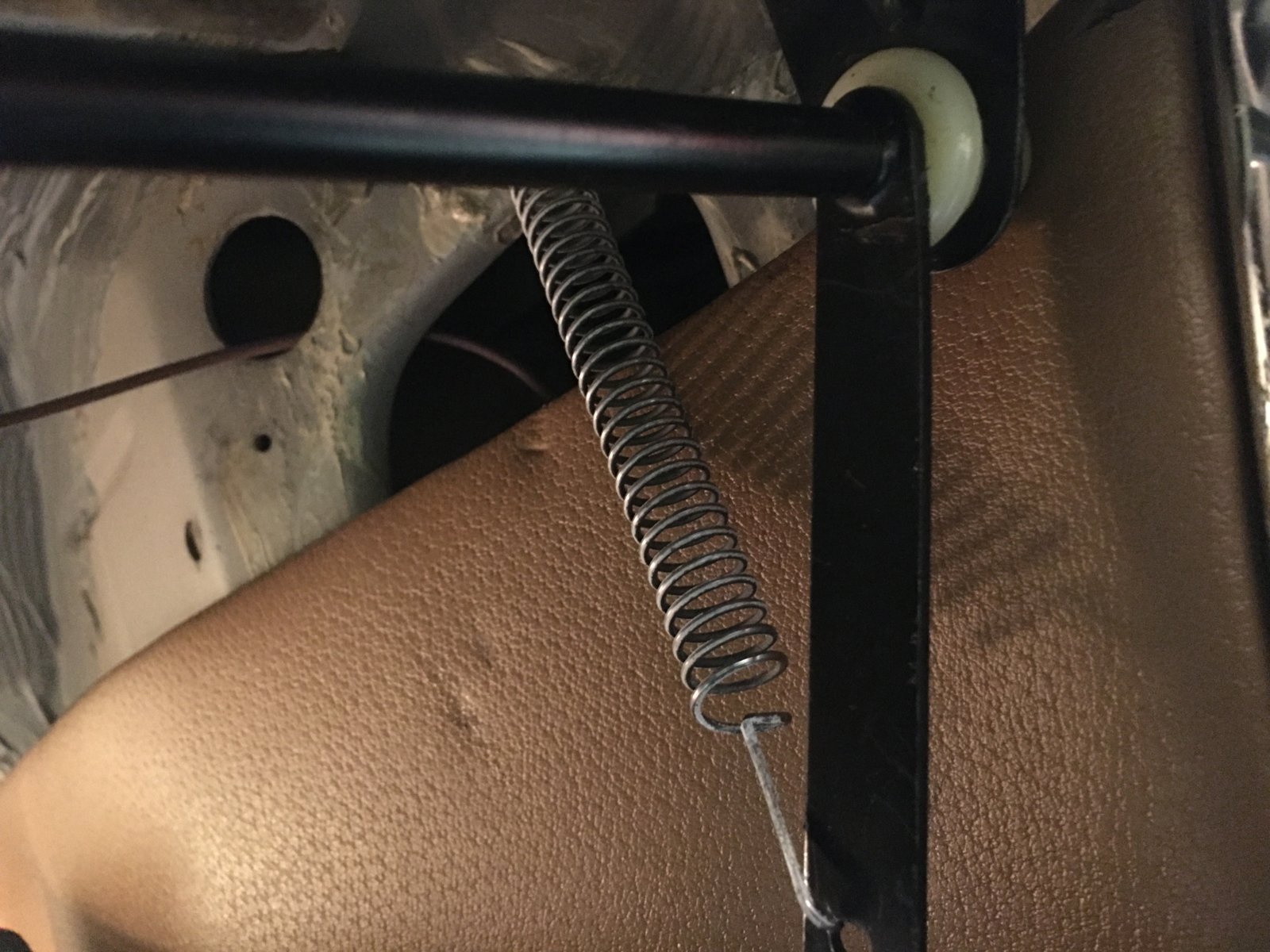

Looks like I already snapped pics in 2016. I have the same spring in my project car, just a bit more rusty. :)
McMaster Carr will sell in a pack of 10 or so. Whoever buys the right spring will have plenty of extras!

Thanks and especially for the link that shows where it goes. Never ever had one of those.

The hole the top of the spring hooks in is just above and behind the black bar in the photo. The spring will shine up real nice, just saying Stan.
