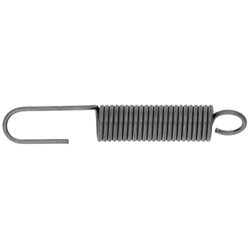

My local Ace Hardware has a good selection of springs. I picked one the right length (2.5 in) and end configuration, and it works fine. $3. And it is a PITA to install.

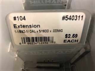

did it have a SKU # ???
To close the loop on this, here's the SKU on the spring that I bought at Ace Hardware. Brand name is Hillman. Spring #104. May be available elsewhere.
As an aside, when installing the spring on the right-side hinge, I noted that the left hinge has a hole in the arm just like the right arm -- but no attachment point under the dash for a left-side spring. I'm guessing the hinge arms are designed to be used on either side but that coupes actually used a spring only on the right side. Dunno about RHD cars or E3's.

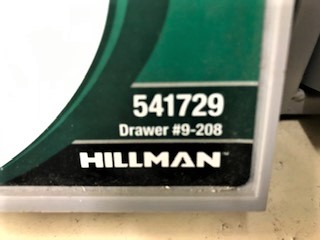

I'm going to try both, I have a cassette player in my glove box that wants to make the door come crashing down with its weight so maybe a stiffer spring is in order. I will report back.
I looked at that one and it was much stiffer than #104.
