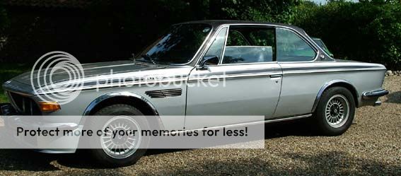

He supplied two pictures of a RHD CSL with newly fitted -30mm springs and Bilsteins, notice that the front tire has a lower profile than the rear tire, making the arch to wheel gap look a little bit bigger.
In my opinion, it sits a little bit too high, at least in the front.

Jaymic springs and Bilsteins. Front alloy spacer removed from struts, i.e. The ring that is approx 25mm thick.
Tyres are standard 14 inch.
Best wishes
C

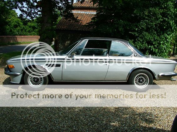

One more of the suspension.
This is a CSI so a touch heavier than an L.
C

That was very helpful. Thank you. I like your idea of doing lower in front.

Looks like I will order a custom spring set from Jaymic, after looking on Cornishmans pictures I decided to try out custom -50mm front springs combined with the regular -30mm rear springs that comes if you buy the set they offer on their site.
