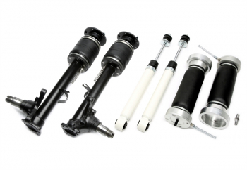

I'm looking that for air suspension conversion. But just realized that there are ready kits for that already available.
Anyone have experiences with this kit?:
Plan was to take only the struts, and add automatic leveling system (and remove the sway bars).
Would be happy to hear what air suspensions people have put in their cars. And does all of those require struts to be sent somewhere for modification?

Any experience w/these?
Not familiar with that kit but I'm putting an Air Ride Performance kit on my E3. It's off of a Lexus IS and will need some mods but not all that much. Modern air suspensions can be fantastic. The slammed low riders stand out because they're slammed low riders, but a lot of your high-end luxury vehicles use air suspension and no one ever notices. They're considered a high priced upgrade for some.

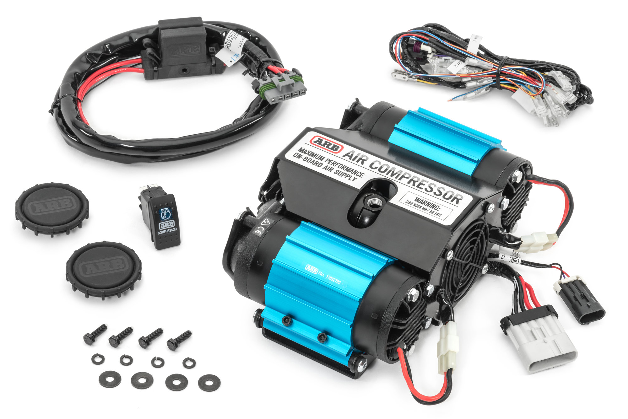

Jeff, if you want a real air compressor, get this unit from ARB. In terms of "field testing", you won't find an "air lift" organization that does it better. This has 100% duty cycle, and probably about double the CFM of most of the Viar style units. You can run air tools on it when your car breaks down. :) If you have ever owned a land rover, or a jeep, you will be intimately familiar with ARB, and their quality.
Okay, research is over. Plan is to get a BC Racing coilover kit, Airlift 3H, Airlift tank, Viaair 444C compressor, OCD single yellow bags to front (direct fitment) and OCD universal bags to rear. Rear bag needs some custom supports, but everything else should be plug and play.
What I heard from pros is that TA Technix kit is the very low end stuff that you can get. Airrex bag kit is better, but its control system is poor.
BC Racing is quality kit, and using that with proper control system like Airlift 3H makes it very solid setup and not too expensive. Talking about 3600 euros total, with all the required equipment.
