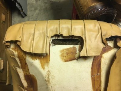

E9 Group - I began with my interior restoration by redoing the trim veneer, which so far has gone very well, not perfect but acceptable for a DIY. However on removing the rear wood tirm strip I noted a rusty panel behind the wood trim piece. In the photos, the lumpy appearance behind the vinyl unholstery is rust, and it is part of an interior panel. In general there is very little rust in this car otherwise. My question is how best to remove this panel and replace then is the part widely available. Or am I better off just going to an interior shop. Probably the best result would involve replacing the upholstery as well, something I probably could not do. Thanks in advance

Can't see a picture; you went to the same school that I did about remembering to attach images:)..are you talking about the black panel that has vinyl on where you would rest your arm, and the wood slips in from the bottom? Should be screws under the grey felt stuff. (the reason there is rust, probably..) If its just surface crud, sand it some and coat it with POR 15, would be the easiest way. No need to go to bare metal, the stuff likes a little tooth to adhere to. I assume that the bumps are rust bubbles under the black paint. Or you can strip the paint, sand or blast/brush, prime, paint....If you seal well with POR 15, and have good rubber seals to keep mother nature out, they should last longer than either of us.

Sorry folks I did add the photos. Wondering how to take this apart, it appears to involve also removing the lower chrome window trim
Are you referring to the chrome trim in your photo as rusty? It is riveted to the stamped steel section that the wood is fastened to.
That seems more difficult to repair than it is to find another one.
Now I see what you mean by bumps..if you were going through customs, they'd have to open that up. That probably is rust that is at full blossom, behind the vinyl. Never seen that...I have a few sets, and all have a little oxidation, but you might want to start with a set that's a little better. Are the fronts in similar condition?

Thanks for your photos, despite that I first forgot to post mine ! It is the stamped steel support for the wood trim not the chrome trim . The second piece from the top in your photo Can you tell me how to go about disassembly to remove that piece from the door panel ?
You have to pull the rear side panel (rear seat out=push down and pull out, armrest obvious) and you will see a few small screws holding it in place. Screws out and pull up.
Replacing that means removing the wood (screws under the felt), drilling out the rivets to remove the alum trim, then reupholster. None of this is hard, I learned on the fly. World Upholstery has the vinyl, Ebay has the thin foam underneath ( if that needs to go), own a rivet gun.

You need to disassemble first them from the body, then remove the wood, remove the felt & you will see all of the rivets that hold chrome parts, rivets are ca. 3mm (i was using 6mm drill, to not damage the trim & not to make larger holes, used almost no pressure). After middle aluminium & top chrome/brass trim will be removed you will be able to remove upholstery material.
Couple weeks ago i made full disassembly of my set.
After media blasting they look like this:
Nice ... thank you for details. I will probabaly need to replace the part I am sure it has disintegrated from rust.
