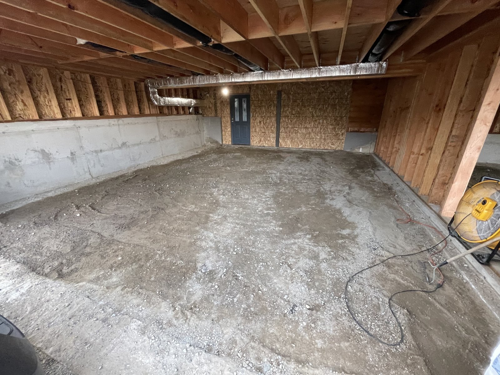

Last weekend I retroactively pulled the old driveway asphalt out of my new garage. The earth is hard as a rock due to 2014 new asphalt prep with a grader and roller.
I need to decide if I want rebar, steel mesh, or nothing. Most everything that Inread suggests that rebar isn’t needed with a 4” slab. I talked to my concrete shop today and they recommend fiberglass rebar, which is more affordable (#3 with strength of #4) and much easier to handle.
I live in minor earthquake country. Last larger one was a 3.6 about 15 miles away. My main concern is cracking, not overall load. It is my understanding that rebar mostly helps with weight bearing capacity.

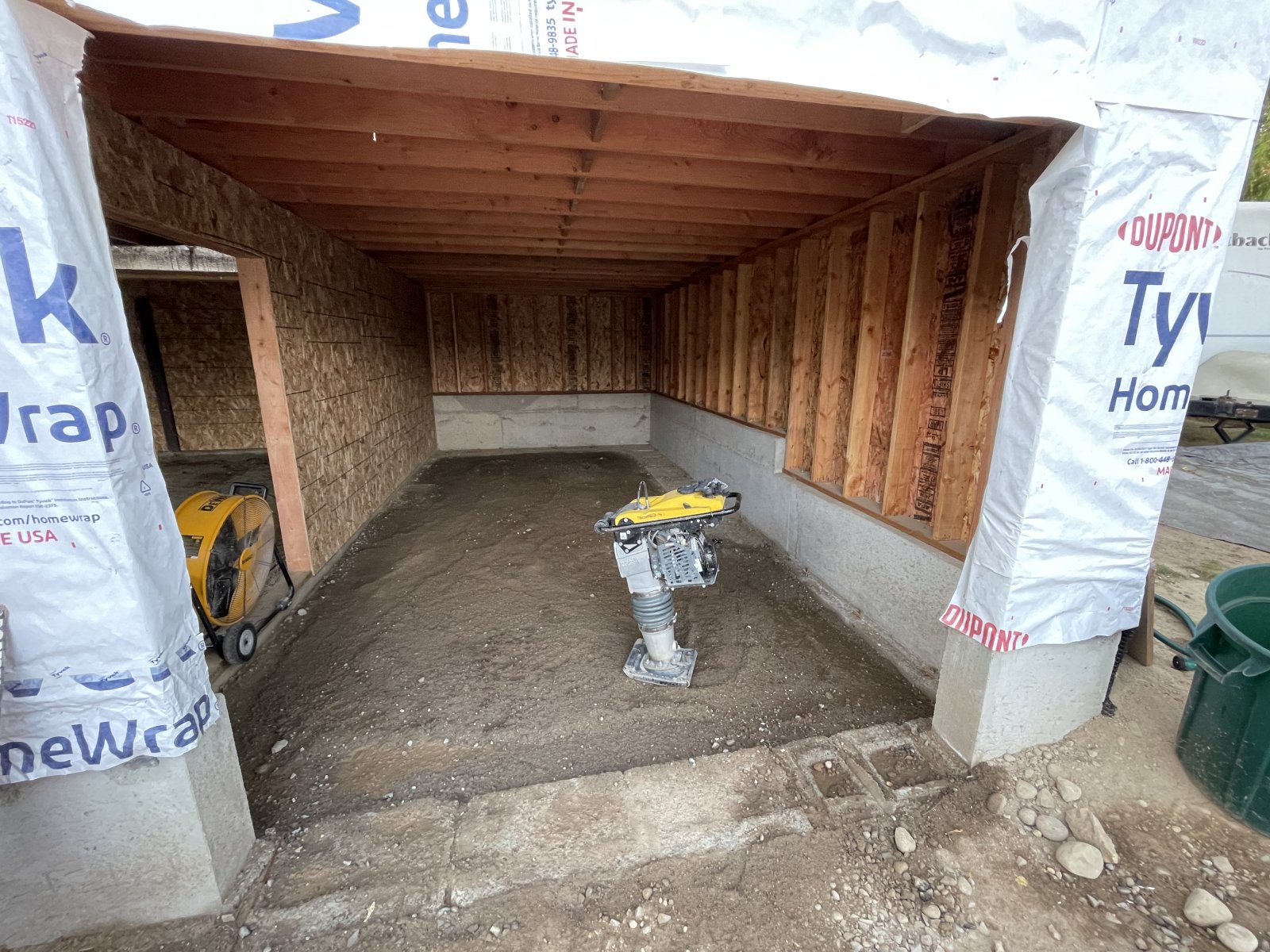

I was thinking of maybe putting rebar in the 3rd (e9) bay only. When my house project no longer owns me I may put in a four post or scissor. I only have 8’ of headroom.
If you suggest foam, I have zero desire to scrape another 2” off of my base. Temps are mild here and the ceiling will be insulated.
Main garage
E9 space:

Thanks @rsporsche! I’m on board with the mesh. I can also throw fiberglass rebar in for good measure also if it helps (maybe just in the e9 bay). The “rebar” is only $8 for a 20’ stick.
My main garage is 23x24, and the e9 garage is 11x24.
