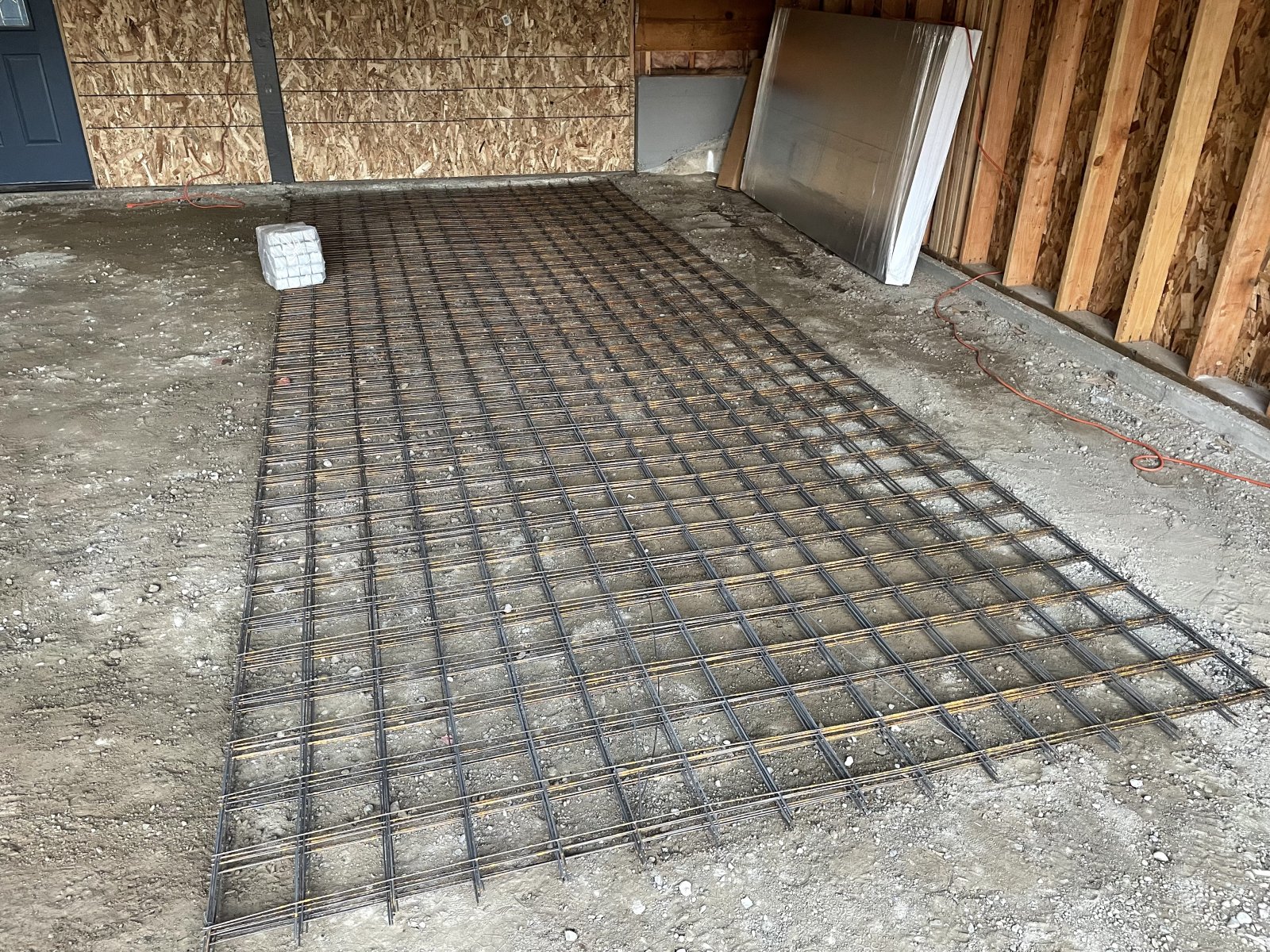

Can you lay down a thin plastic moisture barrier?
Yeah that is happening no matter what. I got the mesh, foam, and vapor barrier this morning. I may be slow on car stuff but I don’t mess around on house projects.

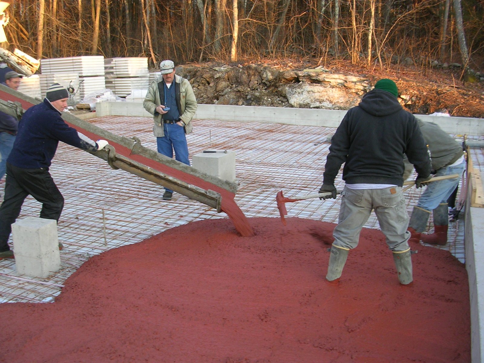

I like this picture. It looks like they were turning your garage into a cranberry bog.
They were & very gritty, too. Broke the blender & he swore never again!I like this picture. It looks like they were turning your garage into a cranberry bog.
