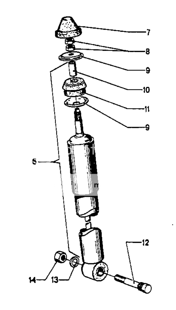

I would like to install the rear sub frame of my E9 tomorrow.
I have a question about the rubber(s) that should be used in the shock towers.
Can I use the original rubber with bushing (nr. 10 & 11 picture below) or should I use the rubbers delivered with the Bilstein shock absorber, if so in which order?
Thanks in advance!

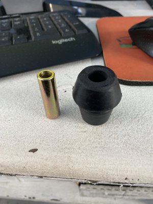

The correct BMW part has the steel sleeve (#10) and the bushing is one piece- not two like what came with the Bilsteins. That will prevent the knock Don speaks of, when the Bilstein rubber pieces get lose, which they will, the shaft of the shock will rattle around in the hole. Not good, that's why BMW used that part :-)
Interesting... The e9 is different from a 2002 in this regard. The Bilstein for an '02 is one bushing with sleeve, as Peter describes the e9 BMW part.
Sorry for the bad advice. Sounds like the OEM bushing is the way to go.

Hi everyone,
First of all thanks for the prompt replies!
I already have the OEM rubbers and bushings from W&N, so this is not the issue.
I asked the question because I already helped to assemble an E9 two years ago with a friend of mine.
We replaced the rear sub frame then with the Bilstein rubbers and washers, but it just doesn't felt right on the mechanical point of view.
As Peter already confirmed I thought the shaft of the Bilstein would just rattle in the big hole of the shock tower.
My friend was convinced that this was the right way, but I wasn't, therefore I asked this question.
I will use the original rubbers and bushings from BMW since this makes more sense to me.
I installed the front sub frame today. Rear sub frame is for tomorrow.
Thanks again guys and the best wishes for next year!

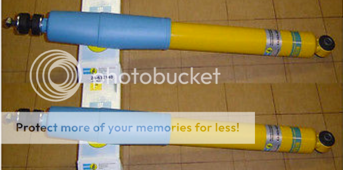

Strange... the e9 OEM bushing is the same as what came to me when I've put Billies on my 2002s. Don't know why they'd package something different for the Coupes... I would definitely use that BMW part (like the one pictured above)... and yes, they are way too expensive for what they are.
Here's a pic from Blunt's site for a 2002 Bilstein... with BMW-style bushing. He sells the bushing by itself for $43... yikes.

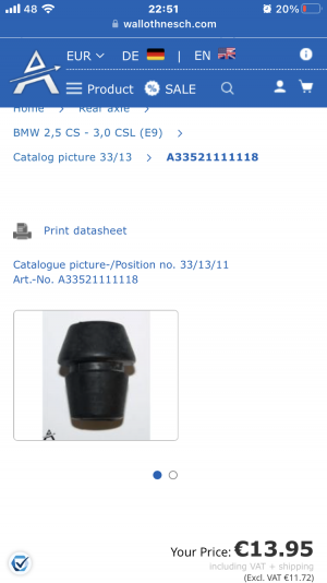

12 bucks each. It's important
https://www.wallothnesch.com/en/upper-shock-rubber-for-rear-axle-you-need-2-for-1-car-33-13-11.html

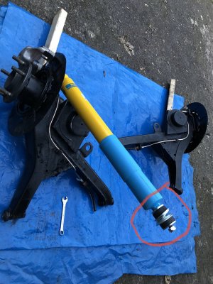

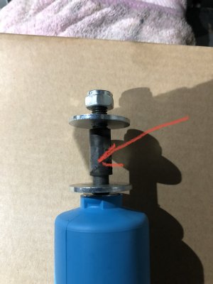

Hi Don
I was trying to fit my bilsteins earlier and I kept just pushing the metal sleeve / bush up out of the rubber part
Is there a trick to aligning them easily ?
Ie should I have the metal sleeve on the new shock or should it be already in the rubber part waiting for the new shock ?
Obviously in the photo the nylock nut and washer are still there , I have those removed before I tried to fit the shock.
I will not be using the stack that came from bilstein in the 2nd photo.
Put rubber bushing into fender, push metal sleeve into rubber bushing, install shock from below. Your first pic has a rubber sleeve on the shock, remove that.
