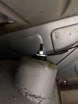

Thanks Don.
I kept just pushing the metal sleeve up ,
The shock is at an angle going through the rubber so I kept catching the sleeve with the shock.
Then I ran out of patience
I will try it again this evening
Thanks again !!
Thanks Don.
Thanks again !!

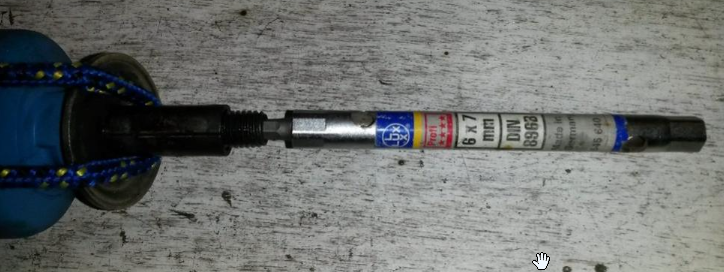

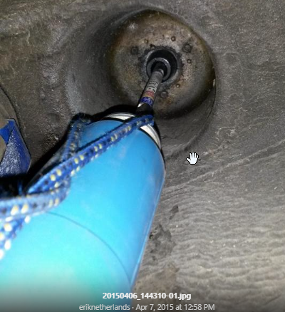

I've struggled as well with this, especially when installing the complete rear axle, witht he strut mounted on the axle at the bottom, and having the spring compressed (with a rope around it). Then when releasing the rope, I coulnd't get the pin to go in the hole.
For this dilemma I found this method to work: I extended the pin of the Bilstein with a torx bit and an extension piece (6*7mm box wrench in english?), and poking that through the hole first, then releasing the rope. ; the torx bit and extension aligns everything.
some more pics & explanation here:

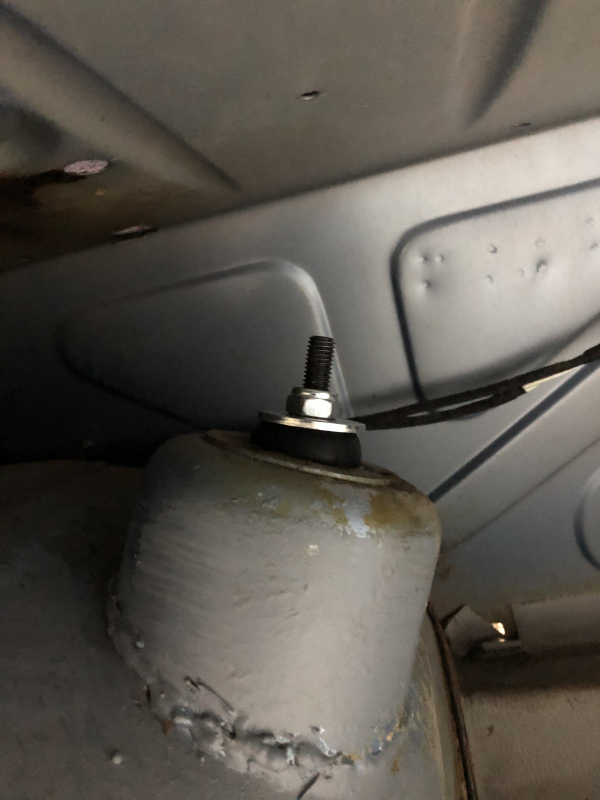

Hi guys
Thank you so much for your helpful advice.
I managed to get both trailing arms fitted this evening.
I allowed the shock to push up through the rubber first and then I sprayed some white grease onto the sleeve and with a bit of leverage and mallet action I got the sleeve to go down into the rubber from above.
It’s beer time again
This time a celebratory one !!
cheers ! :)

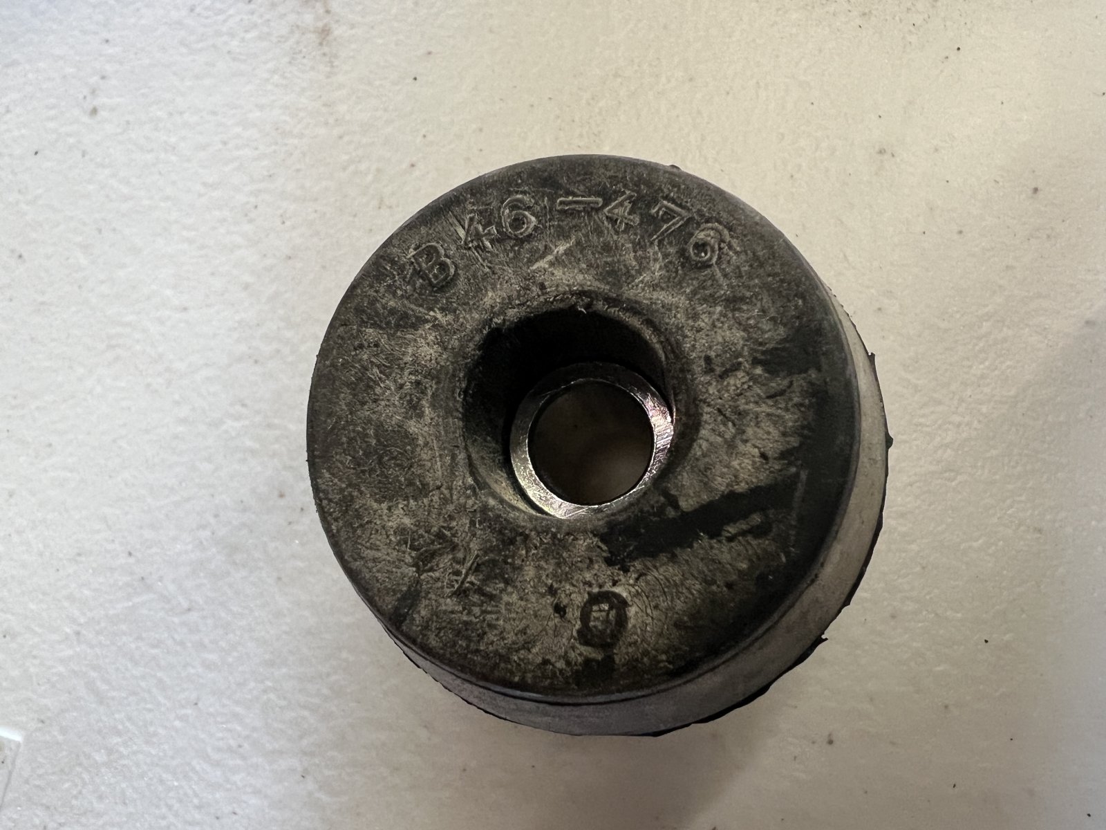

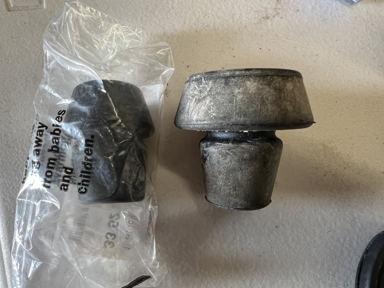

Several years ago when I was putting my E12 M535i together, the rear shocks I received came with these bushings. Totally wrong for the E12 so I just threw them in a box with all of the other surplus new parts I bought but didn’t need. Of course I had a 2002 customer that needed rear shock mounts and I couldn’t find them so I ordered new from the dealer for him (ouch). Then I found a pair in the trunk of his car so used those and I got stuck with the new ones.
I received my new Bilsteins for the E9 and they have the same bushing arrangement described earlier that apparently leads to extra noise. I was surprised to see that versus the stock style bushing and thought maybe it was an upgrade until I saw this thread.
While looking for ten bolts I had redone years ago that I didn’t need but happened to have a use for now that I cannot seem to find I found those mounts that came with the Bilsteins.
Here’s a photo compared to 33 52 3 450 101 which is the 2002 top mount and the part number they show superseded 33 52 1 111 118. Also note it has the sleeve. Part 33 52 1 105 047. The 2002 part doesn’t come with the sleeve.
I don’t know if the Bilstein number corresponds to anything specifically for the part. Worth a shot to ask I guess.
Hope that’s marginally helpful.
