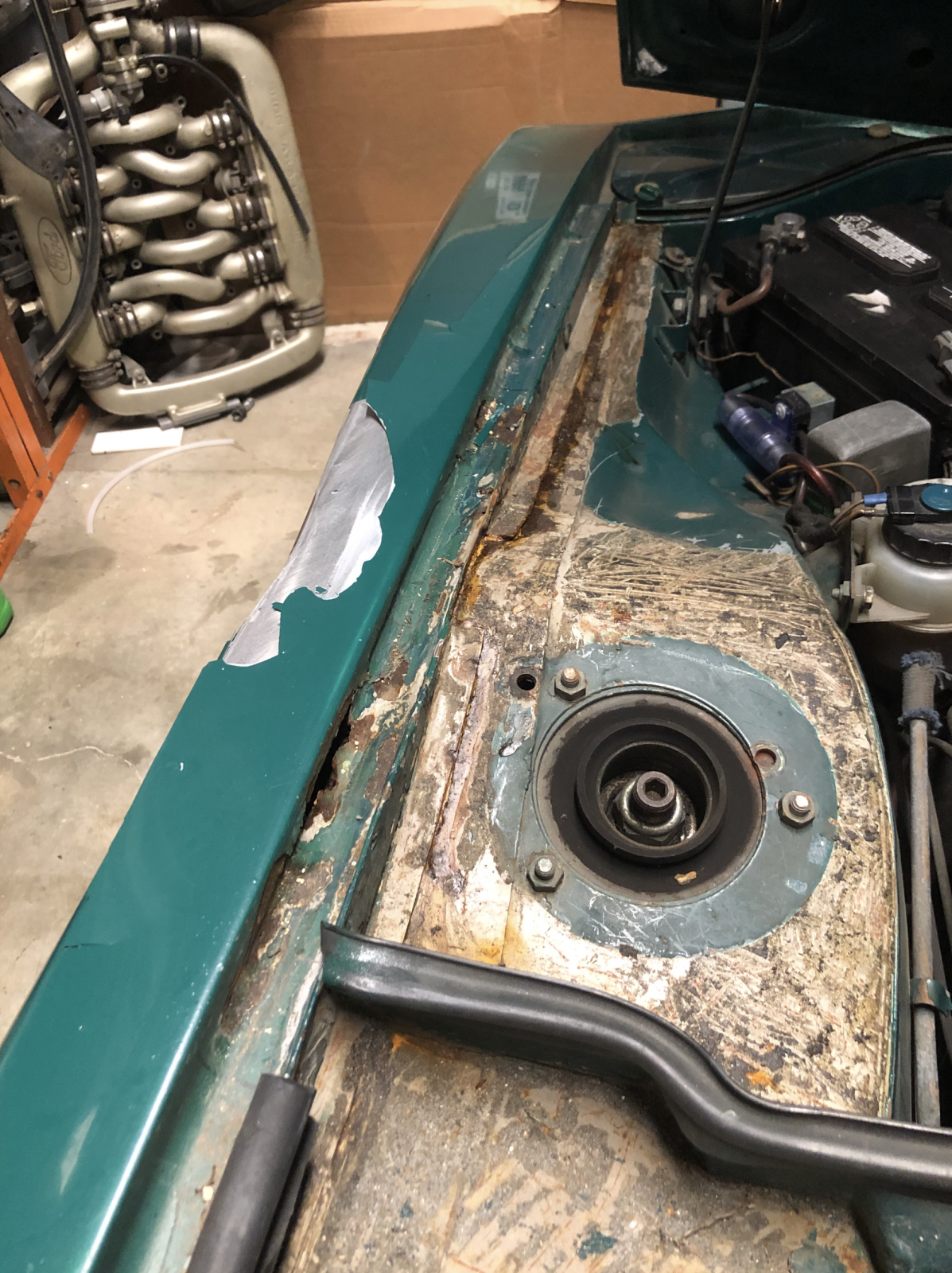

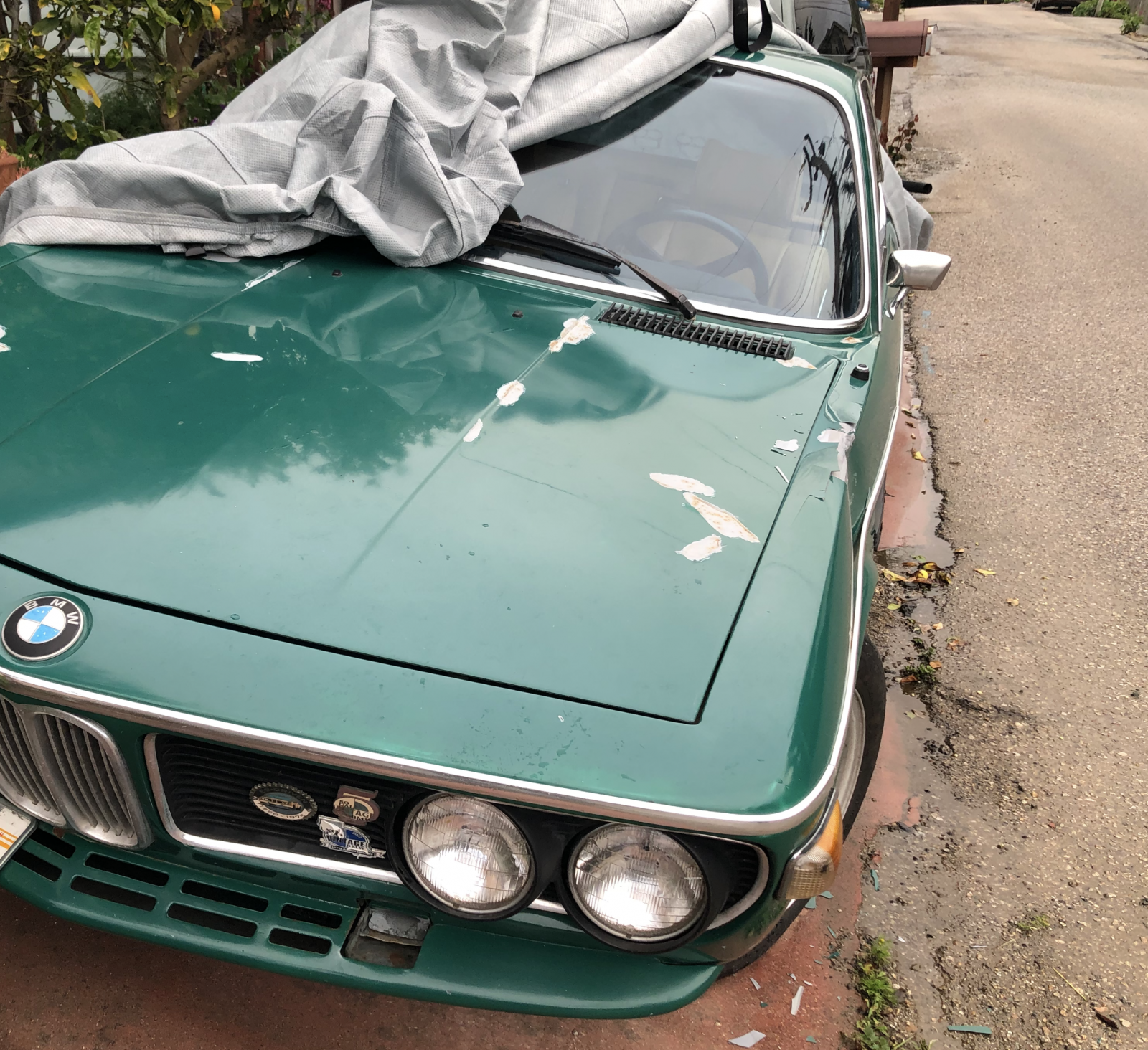

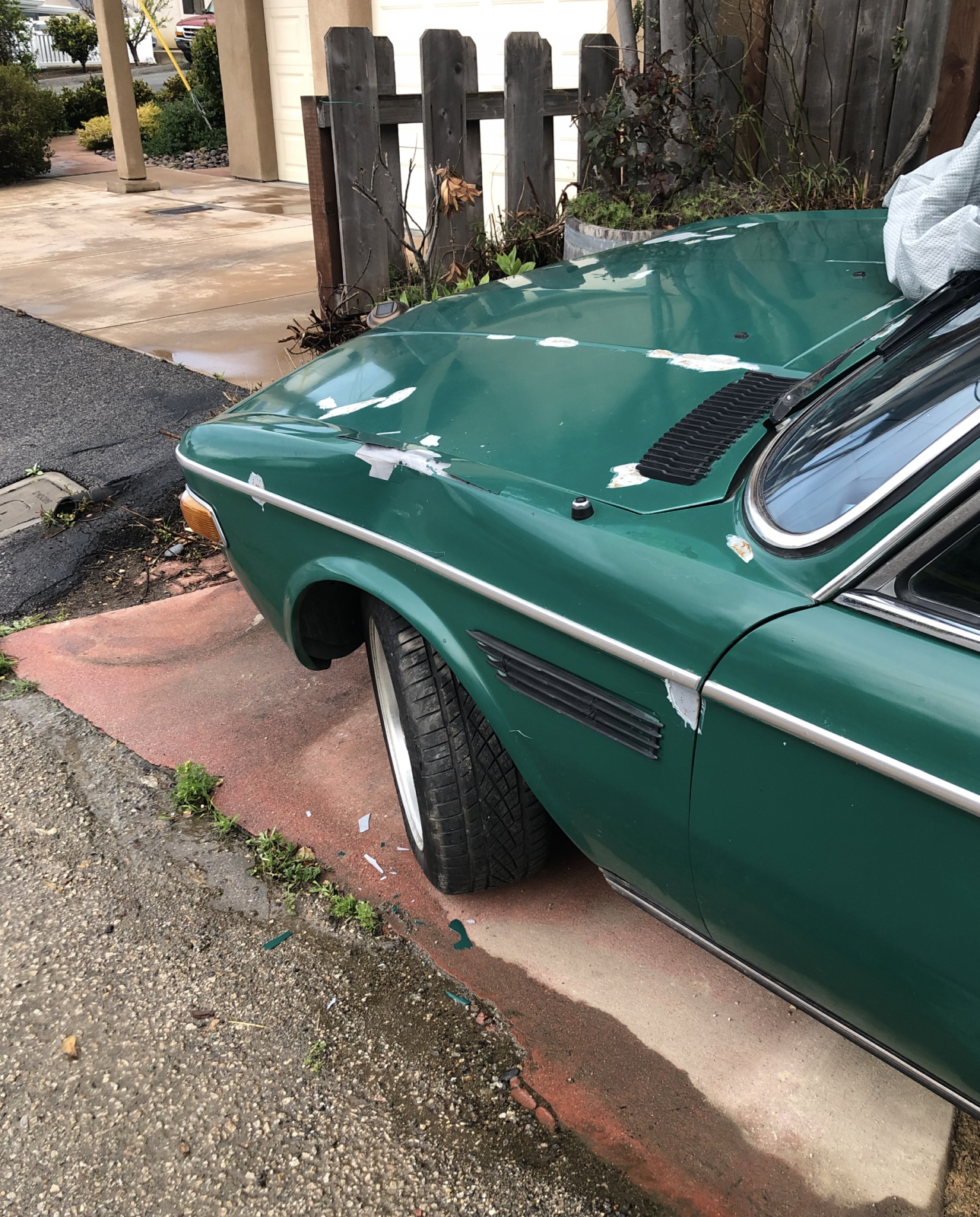

Hi crew. I'm hoping to take advantage of your expertise. My coupe has been parked parallel in front of my house off and on while I've been working on my other car in the garage and someone staying at the AirBNB across the street backed into it. Here's the outcome. (NOTE: It's the obvious dent, but not the grey primer spots. Those are where I'm trying to control the layer of filler primer from the paint job in the 80s as it chips off. Different issue.)
-The other party is insured with Progressive. I assume I'll call my insurer and they'll call theirs and that's how this will begin;
-It looks so far like the hood nor the inner fender nor the suspension are any worse off, visually of course. Lucked out if that's the case;
-Haven't driven it any farther than into the garage. Hopefully the wheel is ok;
-I see fenders are no longer available. Am I likely to be the one sourcing a fender vs. a having a collision shop try?;
-Could a talented dent specialist get any traction on this? As I said, paint work is in this car's future no matter what;
-Is there anything I need to remember when getting the damage assessed? Should I have collector specialist look at it?;
-Have I forgotten anything important?

@Blinkling, I do believe that a good dent repair guy could fix it. Especially since the backside is mostly accessible.

I don't think fenders are "readily available". The WN site shows them but they have a "0" price meaning they are not available. Any NOS or used that are have been sitting on a shelf for a very long time and typically have some shelf scars. That dent looks absolutely correctable by a competent metal guy/gal in my opinion. The fact that there is some rust at the seams is not an outcome of this fender bender, but can be addressed at the same time if you are ready to take that step. As others have noted, I think the challenge will be making sure the insurance companies understand what they are paying out. Thinking good thoughts. Best of luck!!!

If it were me..... Knowing that insurance companies HATE dealing with classics like ours they're usually willing to be a little more open to alternatives. The problem is the rust and bad paint not the damage. I think you'll have a hard time finding a shop willing to deal with an insurance company in the middle of repairs like that. I'd push back hard on the value and the cost of repairs and then have them write you a check. If you drive the car you could have a body guy pound out the fender and get it looking pretty good, there's lots of metal to work with, and put some of the money toward fixing the rest of the car/paint. This would give you time to source a good fender if you want to since you'll need to do paint in the future anyway.

I'm really torn -- both fenders should come off for a proper repair. The universe is telling me "now is the time" and the available space in my garage is saying "don't even think about it." And I think I'm too paranoid to let someone else do it.
Yeah, I saw that $0 price on the W&N site too. Just as well -- supposing I replaced the fender and made this impetus to learn how to do leading on body panels, wouldn't I need to take the dashboard, etc. out of the car before I put that much heat into the sheetmetal? It's very encouraging to think it can be straightened while still attached to the car.
