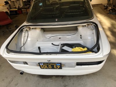

At the risk of giving you misinformation (I have a CS), I believe all the wiring that goes into the trunk follows the same path together: Through the driver side outside floor pass through to the rear seat cavity, up along the top edge of the inside wheel well arch, and through a hole where the interior wheel well top meets the trunk. This is the same path the rear lights, fuel level sender, etc travel. I cannot verify this is true for the original CSI fuel pump power specifically, but that is how everything else routes, and there is an outlet hole for the wires from inside the trunk to the fuel pump mount area. This is how I routed my electric fuel pump conversion for my CS.
I agree. I can't imagine that there is any significant difference between CS and CSI fuel pump wiring.

The wiring passes through one of the rubbers grommets in the boot floor to the pump. I'm away travelling at the moment so don't have an image of my own to send but have pinched this one (courtesy of BarryG) from the site which shows how it should sit. It might appear a little untidy but is covered by the rear boot board. This is how it was done from factory.
Friend, thank you for sharing this image — now the cable length makes perfect sense, as well as the routing that goes in the opposite direction of the other harness. This really helps clarify how the setup is supposed to look.
