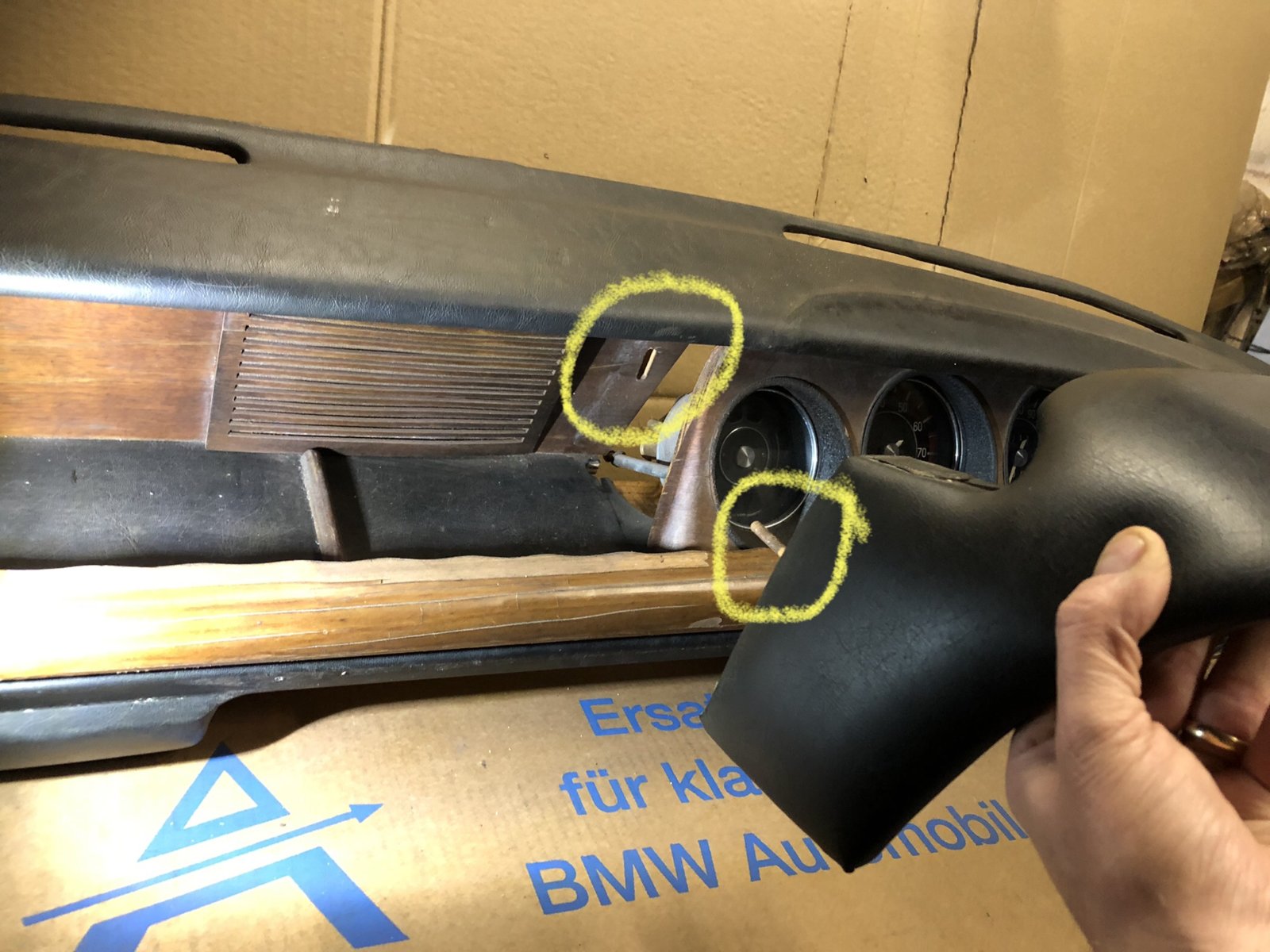

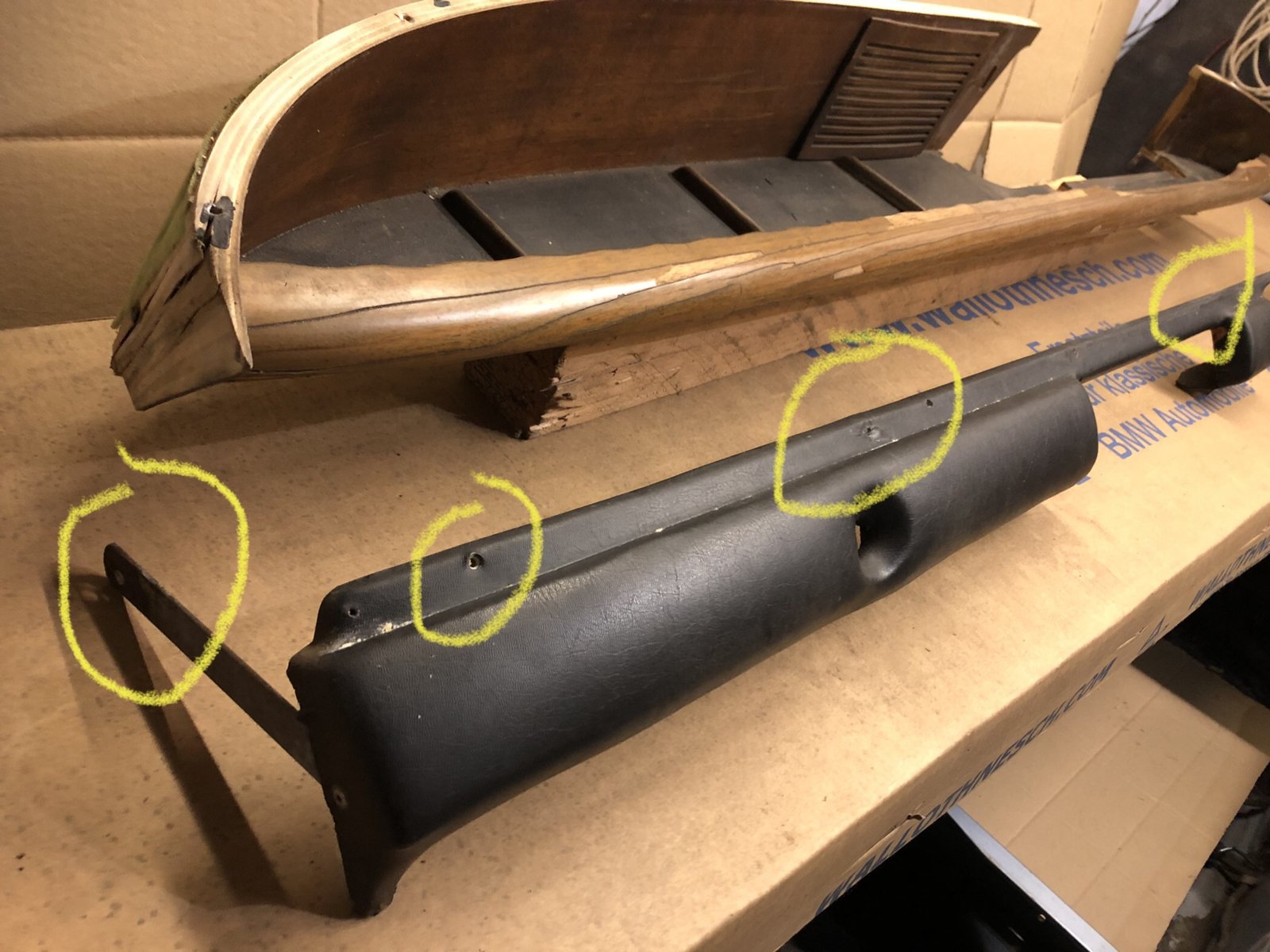

Remove the gauge cluster padded cover
remove the padded gauge pod cover , it is held on with 2 M6 nuts which have to be accessed from behind the dashboard.

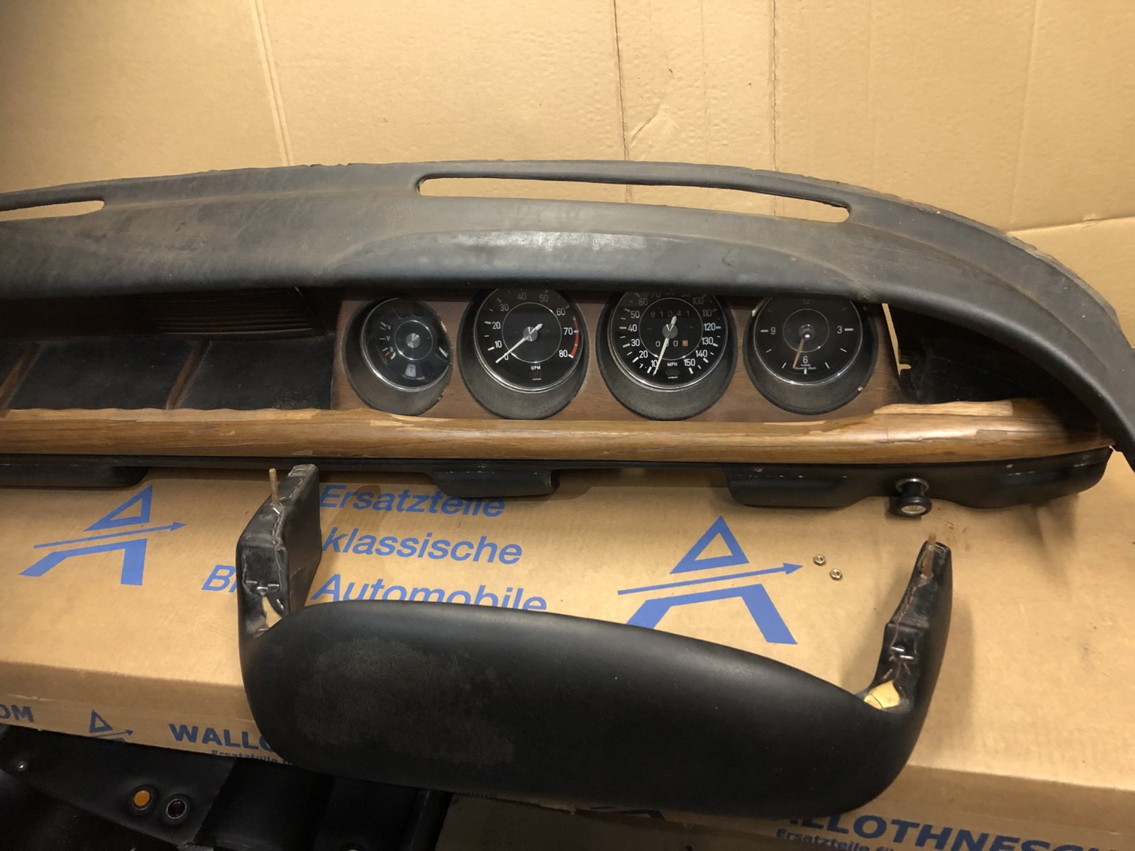

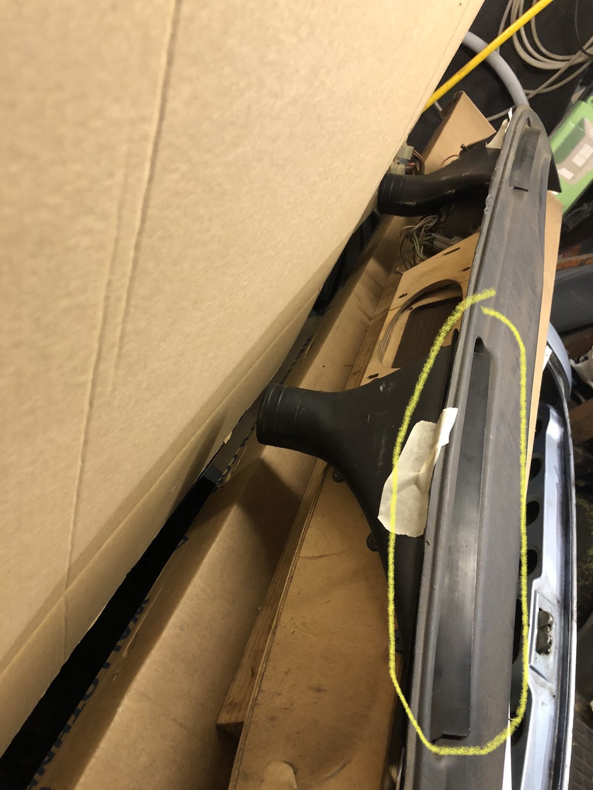

Next you need to remove the black padded panel nearest to the windscreen ( I had my windscreen out of the car ! )
Be very very careful with your de-mister vent ducts - they are very brittle !!!

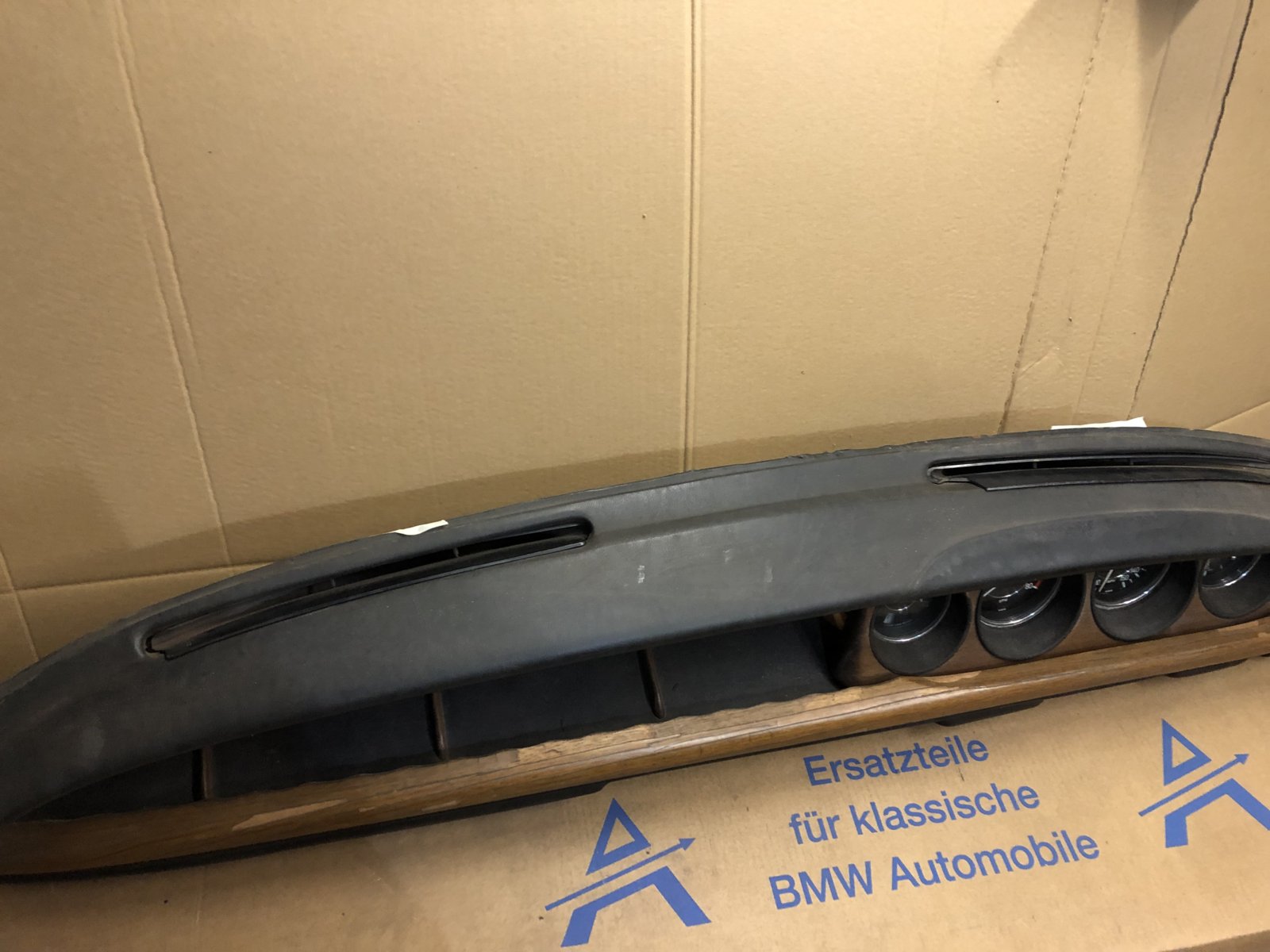

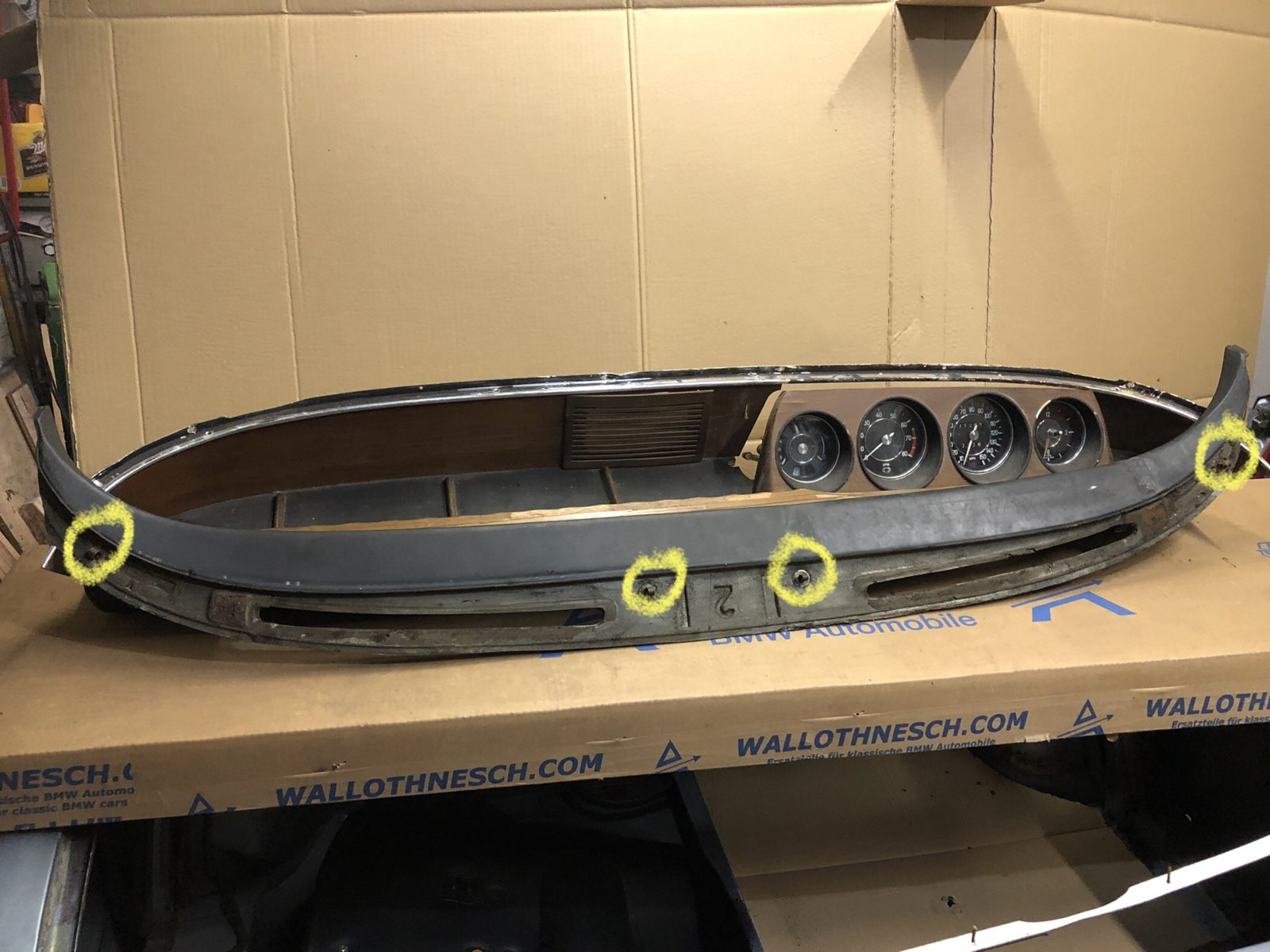

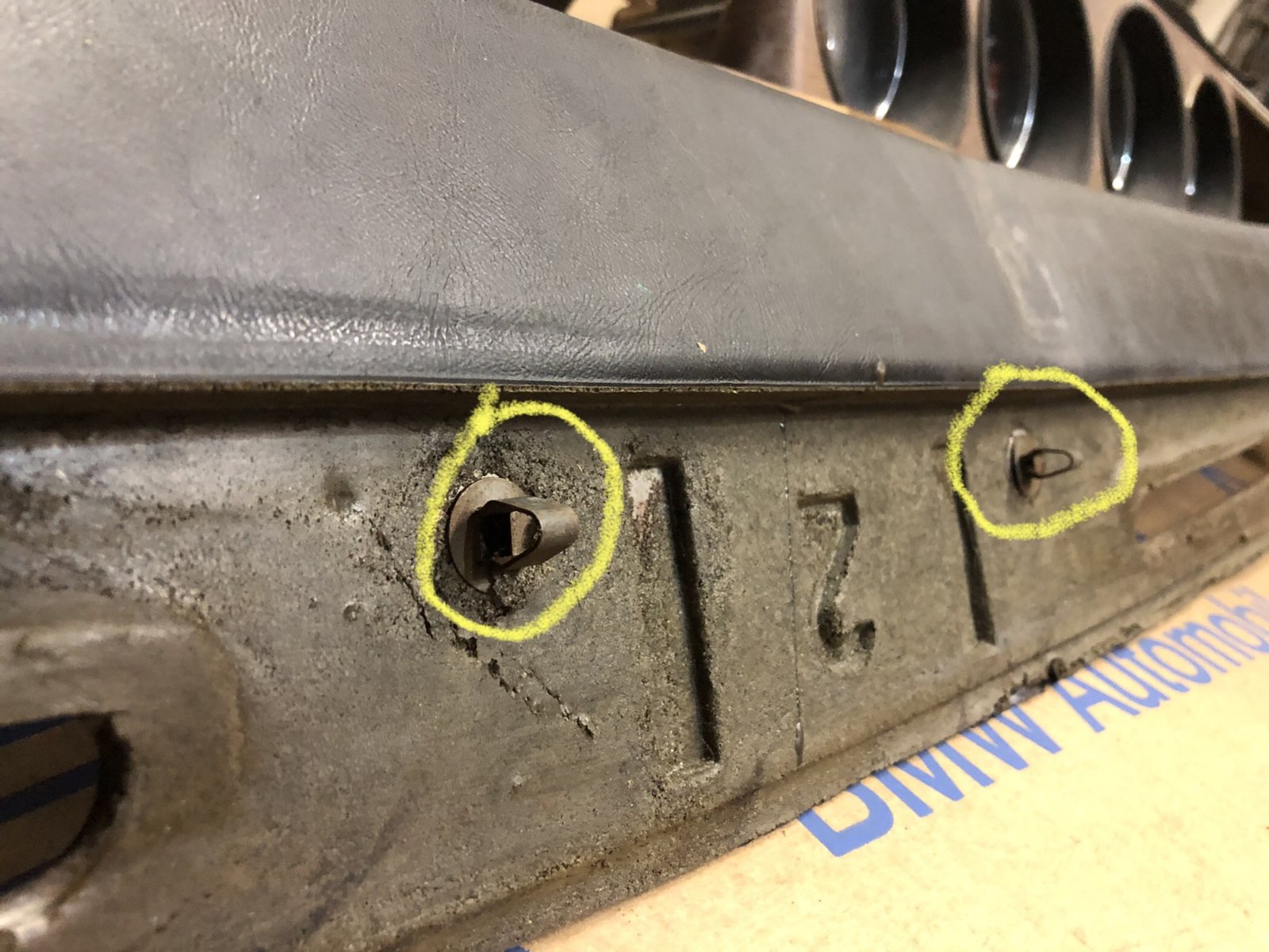

The dash pad is held down by 4 spring clips. They “let go “ when you pull upwards on the dash pad.

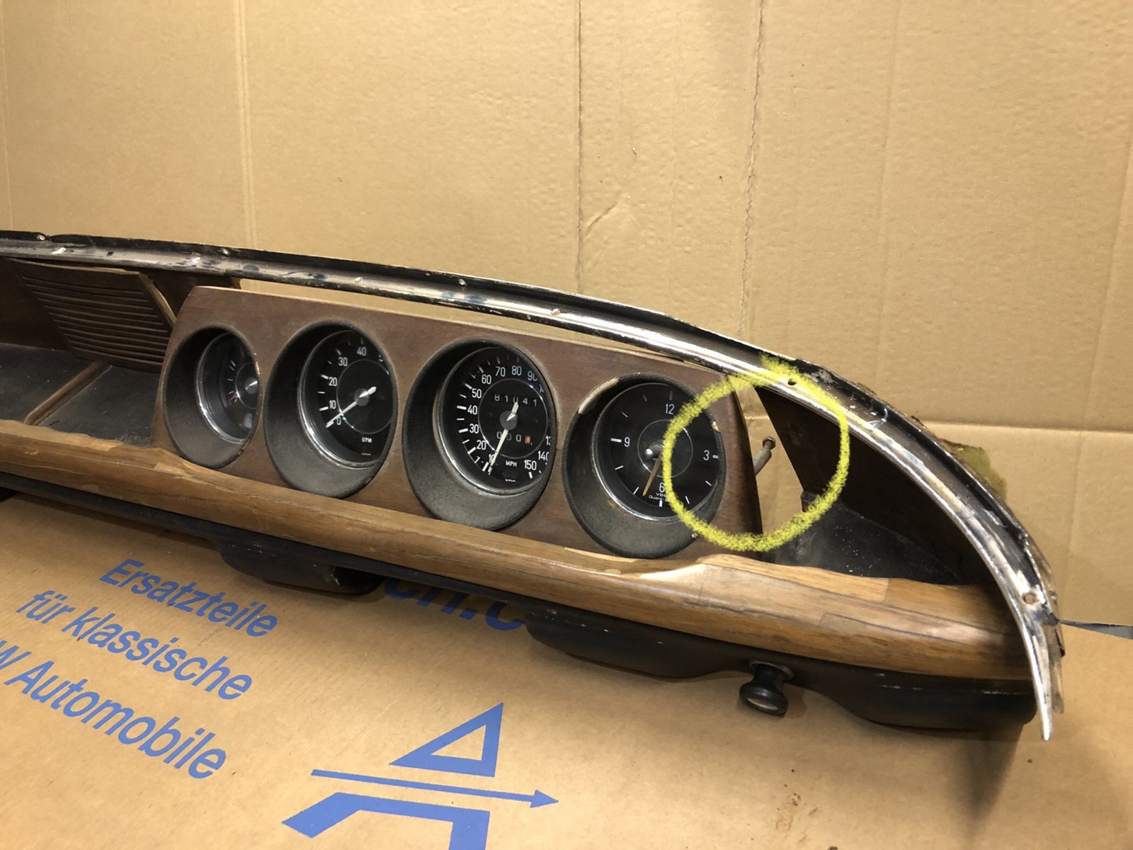

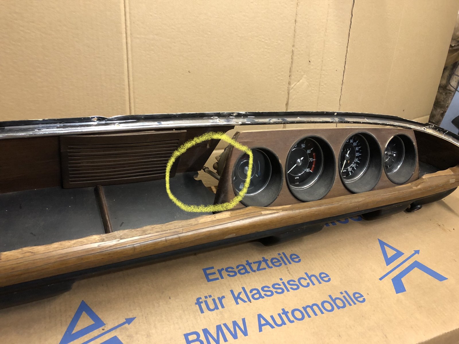

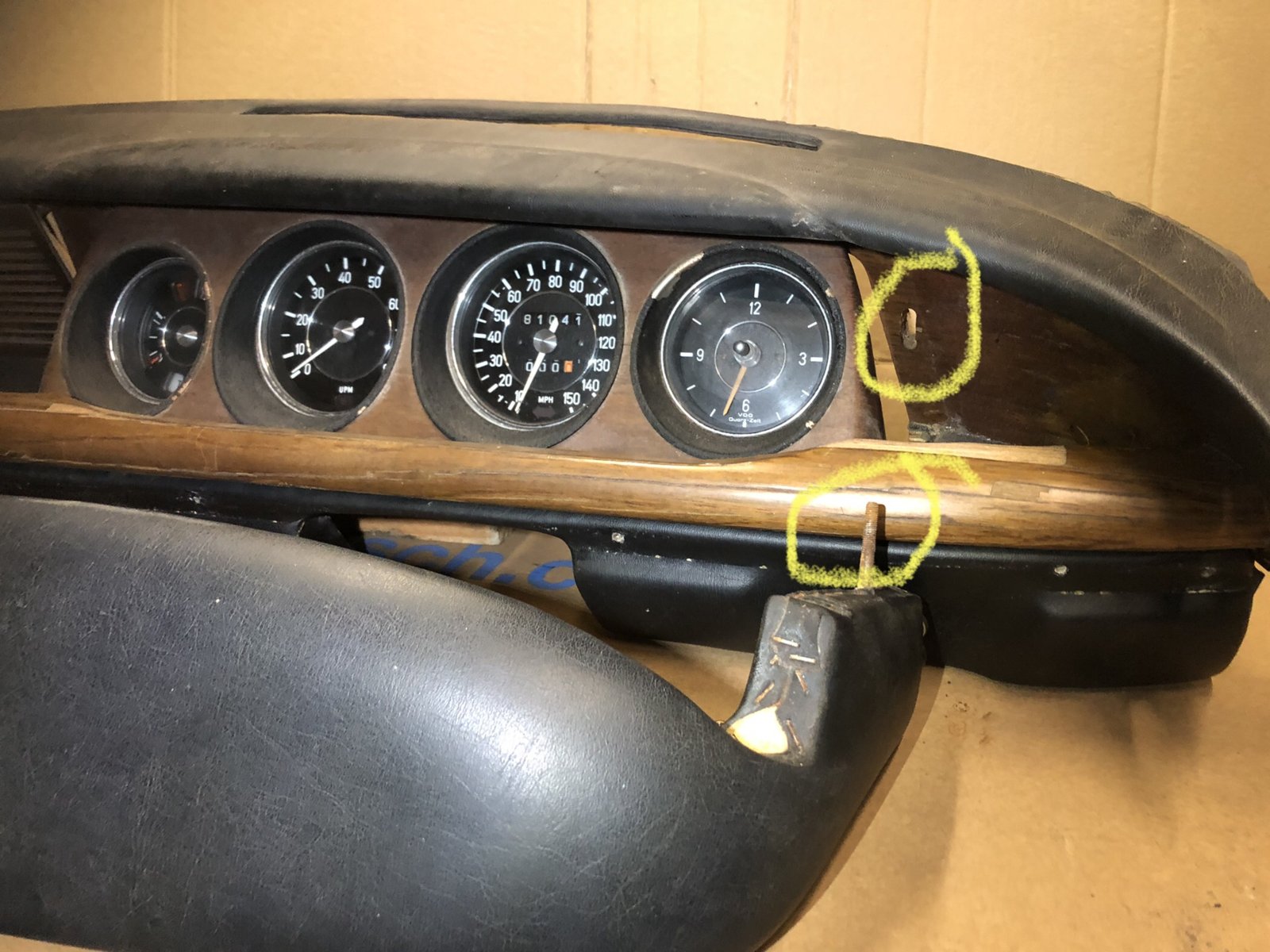

Next you need to remove the gauge cluster complete.
It is held in by 2 M6 nuts they go through both the timber dashboard and the metal car bodywork support behind it.
Remove the 2 nuts and lift the guage pod upwards a little and out towards you , just enough to get your hand in behind it to disconnect the speedo cable and the trip meter rest cable , there are 2 multiplug wiring connectors which need to be disconnected, the cluster is now free .

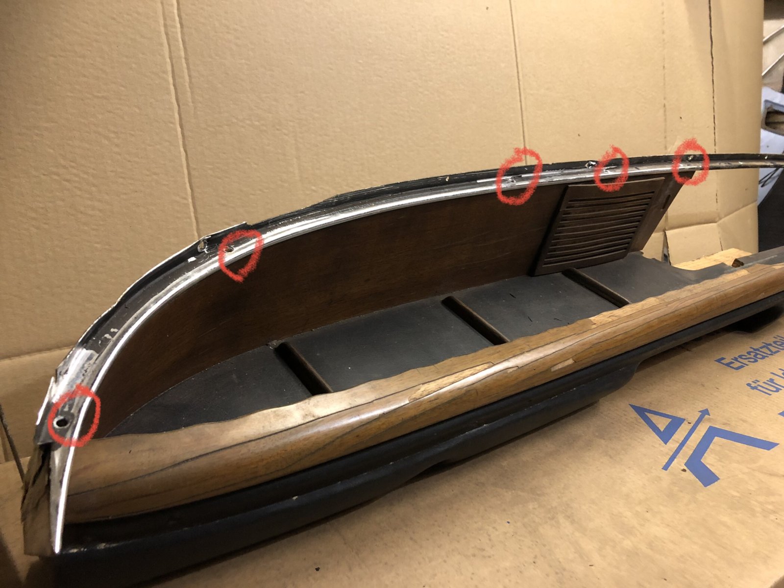

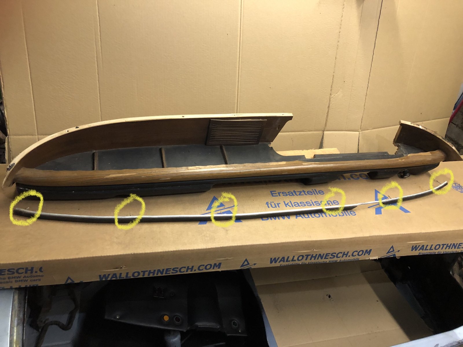

Then the next thing to remove is the chrome strip along the top of the wood . It has screws going into both the car bodywork and the timber dashboard below it. Remove all of the screws.

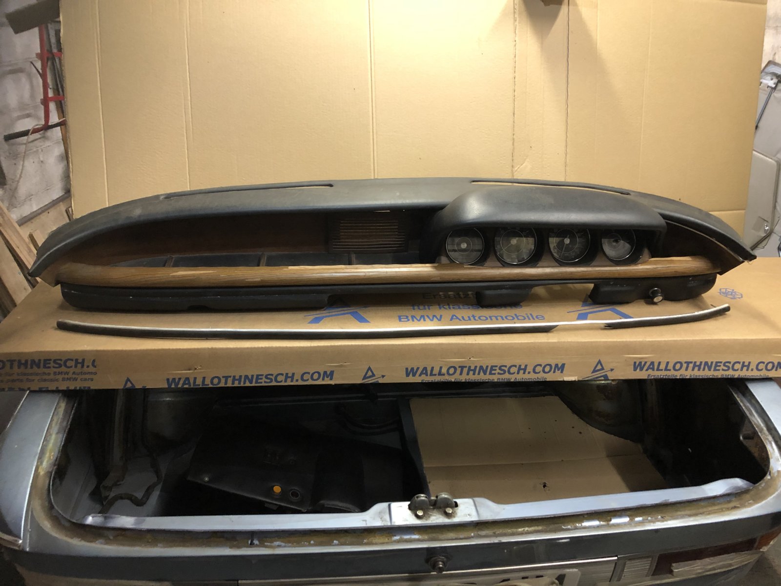

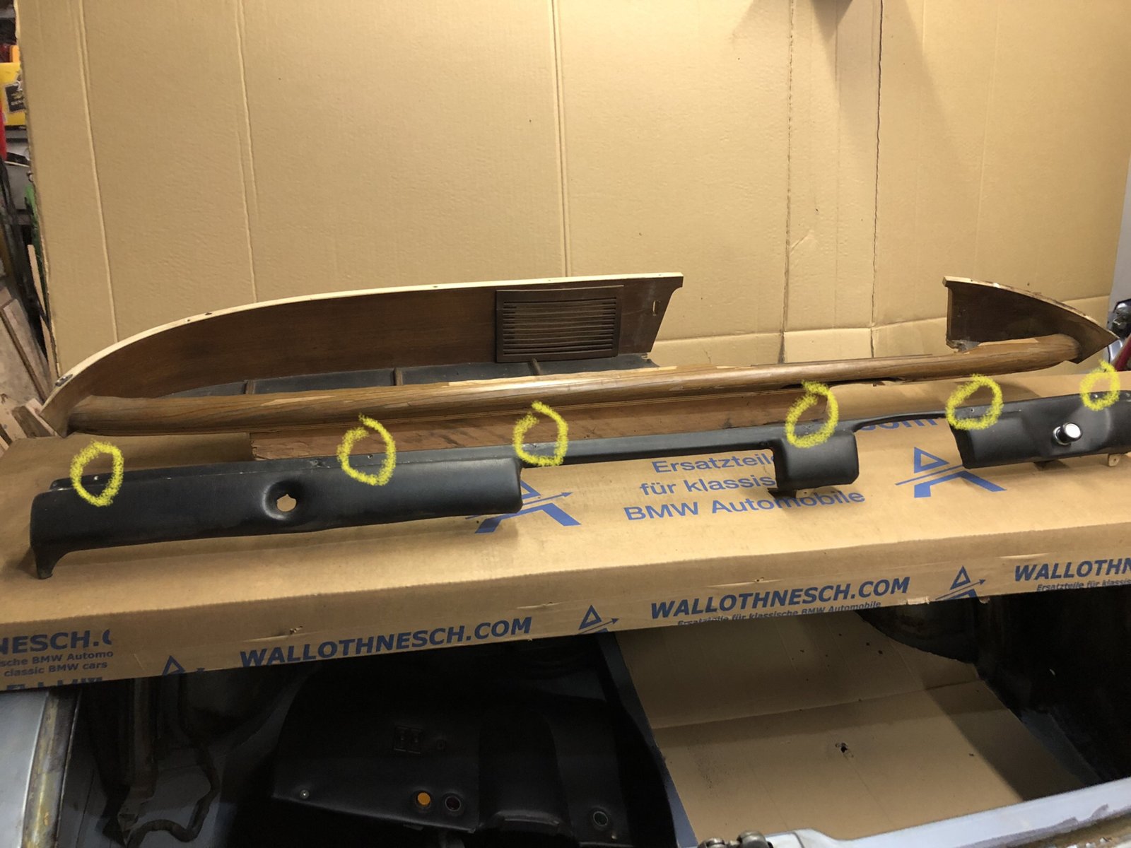

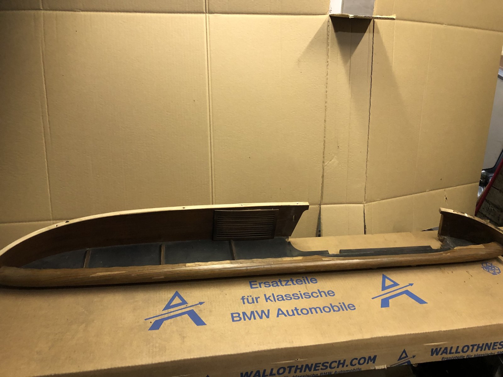

the next part to remove is the aluminium and rubber strip at the front of the dashboard. I pryed mine out from the dashboard carefully trying not to bend it too much ( it is aluminium and it bends easily) I thought it was attached with clips , it turned out they were wood screws ( they pulled out of the wood anyway )
Once that piece is removed, you will then see more screws behind it holding the Lower black piece of the dashboard to the wood , remove all screws.

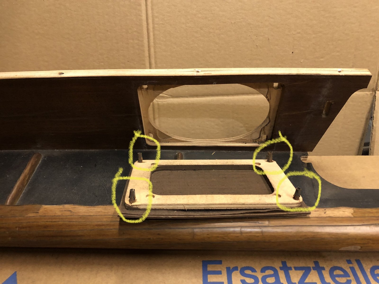

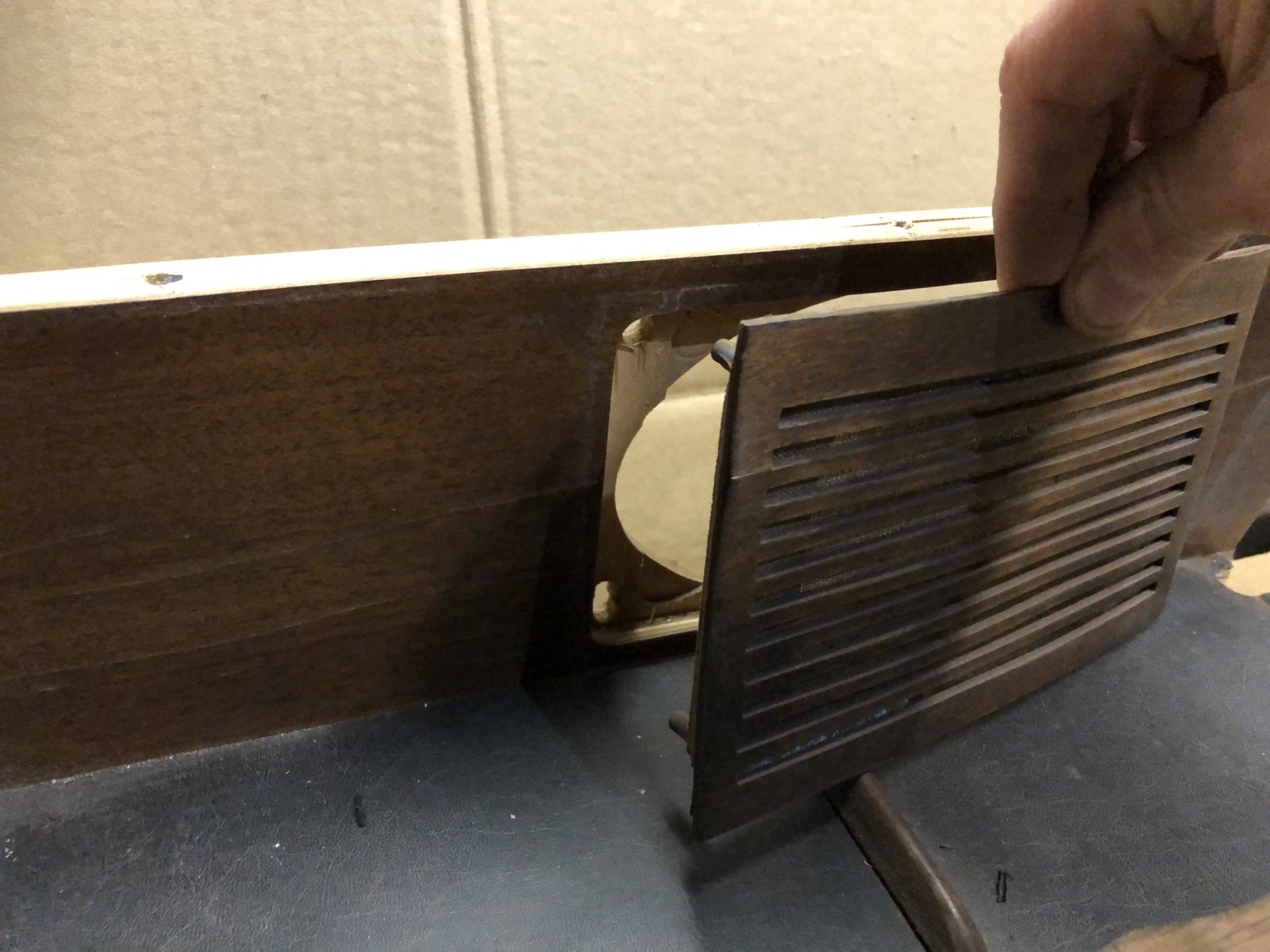

The speaker cover just pulls out carefully as it is held on with 4 spring dowels
Be careful, it can be brittle.

View attachment 131632remove the padded gauge pod cover , it is held on with 2 M6 nuts which have to be accessed from behind the dashboard.View attachment 131634View attachment 131635View attachment 131636 Next you need to remove the black padded panel nearest to the windscreen ( I had my windscreen out of the car ! )
View attachment 131637View attachment 131638View attachment 131641Next you need to remove the gauge cluster complete.
View attachment 131642View attachment 131644View attachment 131645Then the next thing to remove is the chrome strip along the top of the wood . It has screws going into both the car bodywork and the timber dashboard below it. Remove all of the screws.View attachment 131648View attachment 131649the next part to remove is the aluminium and rubber strip at the front of the dashboard. I pryed mine out from the dashboard carefully trying not to bend it too much ( it is aluminium and it bends easily) I thought it was attached with clips , it turned out they were wood screws ( they pulled out of the wood anyway )

"Next you need to remove the black padded panel nearest to the windscreen "
Does the windscreen really need to come out to do this?
You might be able to do it with the windscreen in place Perhaps ( mine was out anyway )
If you do try it with the windscreen in I think you should go in under the dashboard first and disconnect the demister vent flexible ducting and try and lower the vents down in behind the dashboard a bit . Otherwise the black padded panel will not “jump” over the vents themselves , and remember they are very brittle !!! ( again my windscreen was out already , so I am guessing this would be the case )
My padded gauge cover was also secured to the topmost dashpad by screws - so my padded gauge cover had to come out with the top dashpad.
