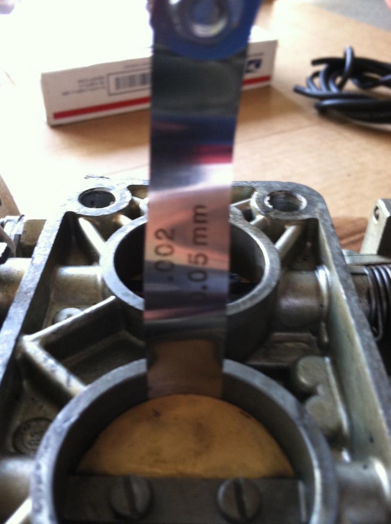

I thought I did. I removed the carbs and gapped the secondaries at 0.002. But when I adjust the idle speed on one of the carbs, the vacuum will come down but the flow (measured with a synchromoter) doesnt come down much at all. Im guessing that this means the secondary on that carb is still leaking. Ill have to take it back off and check. Other than the secondary throttle plate, is there any other source of a leak like this ?

It's not the measurement
Of the clearance in the bore. Measure form the plate surface to the throttle plate.
Assuming a nominal butterfly plate thickness of.06, the plate would be .02 above the surface or two thirds closed.
The plate is not open, only sufficient to not stick.

Doesn't the measurement at the bore determine the air flow through the secondary at idle ? I think you are suggesting a measurement of clearance between the throttle plate and the spacer plate. I'm confused as to what that would do.

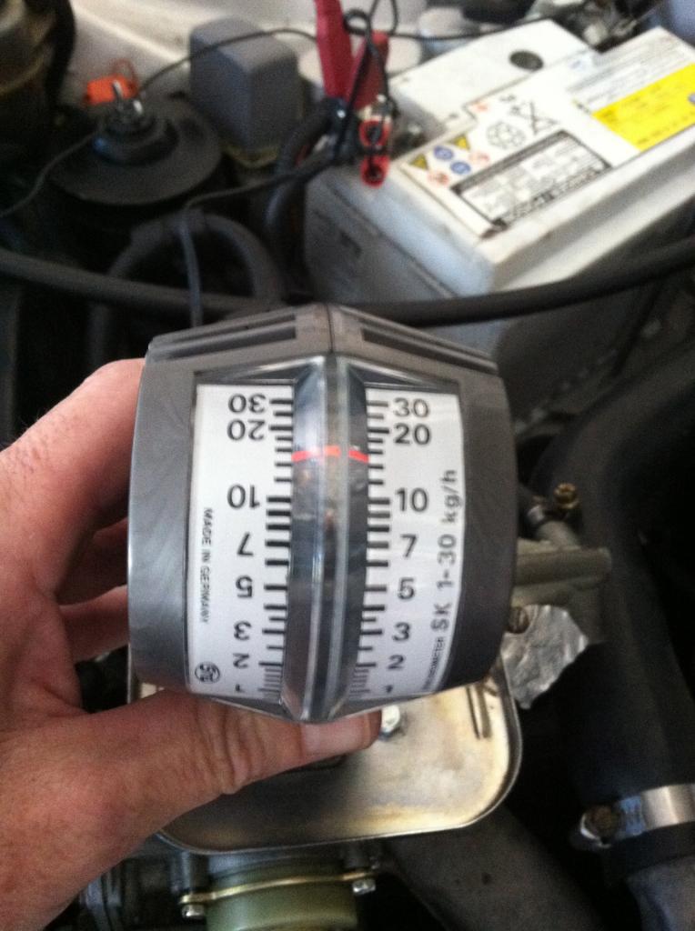

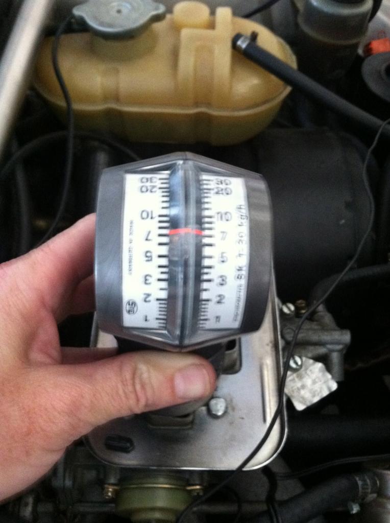

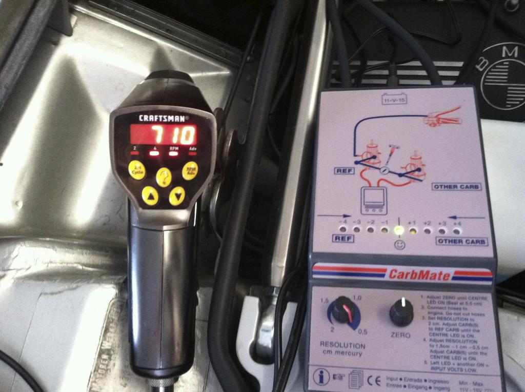

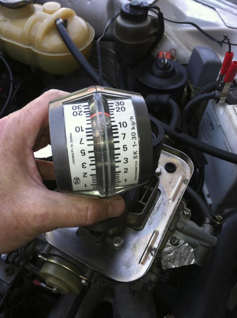

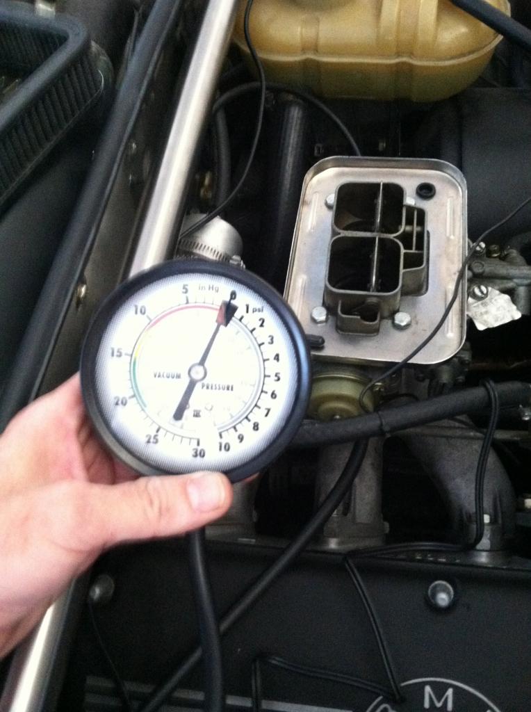

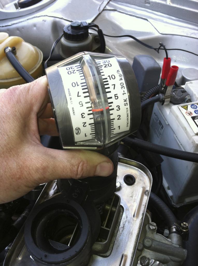

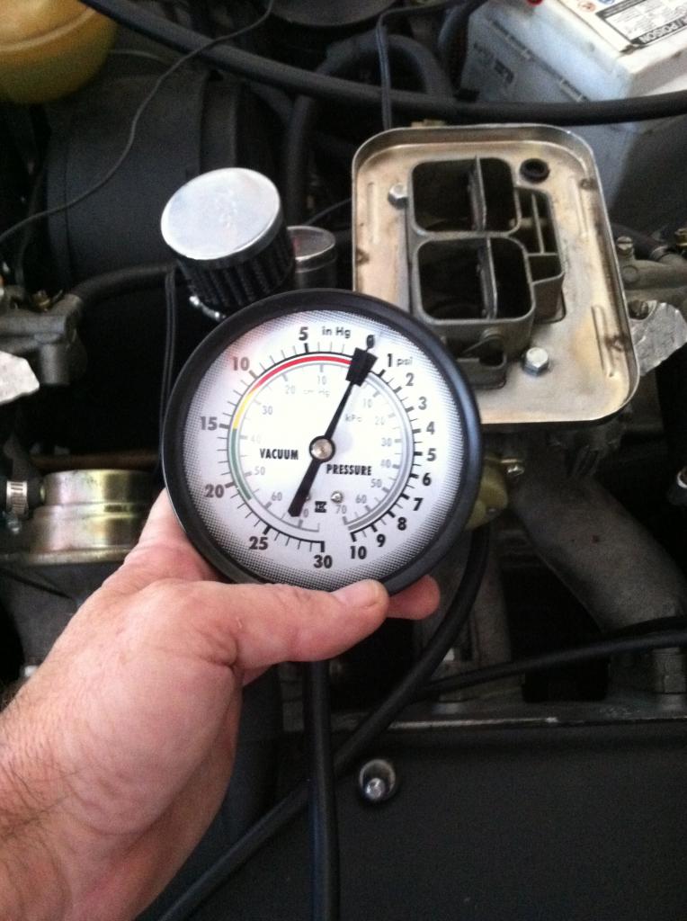

IMG_1586.jpgIMG_1587.jpgProgress
I rebuilt the carbs: gaskets, o-rings, mixture needles, jets, reset the floats, replaced the factory throttle shaft bushings with bearings and went from a 50 to a 55 idle jet on the primary and secondary. I also set the secondary to 0.002"
Using Steve's instructions, I was able to get the car running again. In the photos below you can see the carbmate shows the carbs synch'd at 0" in Hg, but the synchrometer shows that damn Italian carb is still pulling more air than the other carb. What am I doing wrong here??
Rear carb: "The Spaniard"
Front carb: "The Italian"

What are the readings on the dial gauges - zero?
What vacuum ports do you have the carbmate and the dial gauges hooked to?
Those Synchronmeter readings are from the secondary throat, yes? If so what are the primary readings?

Carbmate is hookedup to the vacuum ports off the carbs. Here are the readings from the synchrometer off the Italian carb. At idle, what should the primary and secondary be reading, ideally ?
Stevehose
13,056
5,749
Sarasota, FL
It varies, but at idle I'd say 3-4 on the primary and less on the secondaries. If your primary is very high then likely your throttle butterfly screw is in too far (not the mixture screw, although this may need adjustment once that throttle plate setting is correct). If your secondary is high then you are leaking air past that throttle plate from previous discussion.
