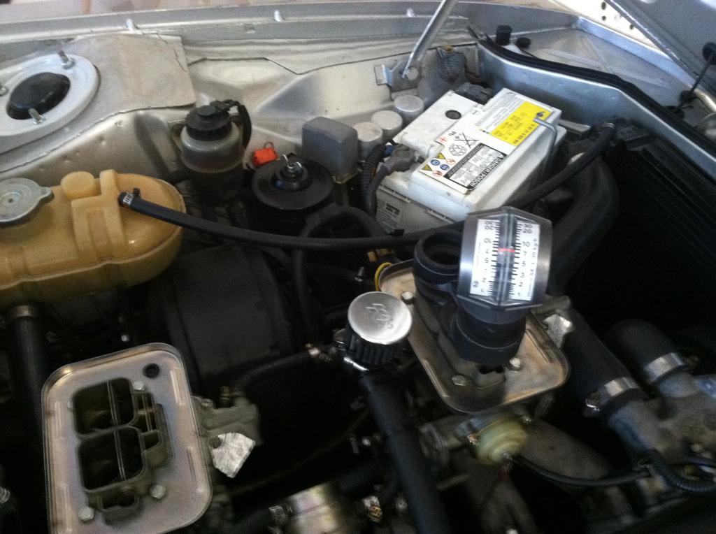

Ill be with mine over the weekend and ill try to grab a photo. Regarding the idle, do you have a carb synch tool ? Using a synch tool I was able to get my idle to around 800. It's still a little rough and I hear popping out the exhaust but that synch tool was really helpful.

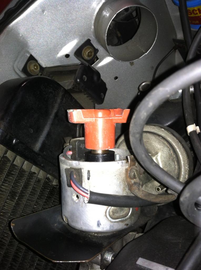

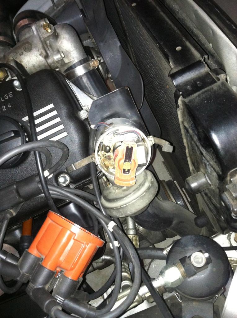

Peter,
Here are photos from my Petronix install.

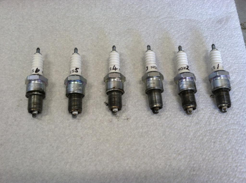

Pulled the Bosch Platinums out this weekend and installed NGK BPES6 gaped at 0.030. Also put in a new rotor. Small improvements, but still doesnt sound right to me

OK, Forum question; does the black ring on the Pertronix look like it is riding too low? The instructions in the box gave me the impression that both black pieces should be basically "centered". Also, David your rotor looks much "smaller" than mine, mine is more triangle shaped, was your old rotor bigger? what's the difference/purpose?

Peter,
I installed mine last year (bought at La Jolla), ring and trigger seemed to line-up pretty nicely. Although not completely certain without looking at it again, the trigger box didn't extend much above the top of the plastic ring piece
This was the rotor that was on my car when I bought it.

That's exactly the way I envisioned it should be, not sure if it makes a difference, but I will check with La Jolla today. We're finally getting some rain so coupe feaver is lower. Thanks for the pictures. Still looking for the red button that says "run smooth with more power"- Maybe it's written in German?

Mine comes up about halfway and works fine, not sure how the rotor would fit otheriwse?

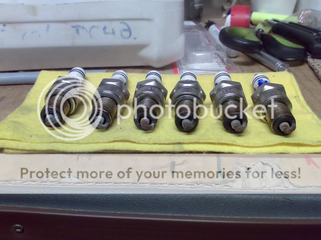

now a question: i would like to ask the experts about the aspect of my own spark plugs, what do you think about these sparks (1,2,3...,6)
can you tell from the aspect any fault on burning, or,...i feel they look very much the same
thanks
remark: david, can you post a pic of your sparks ?

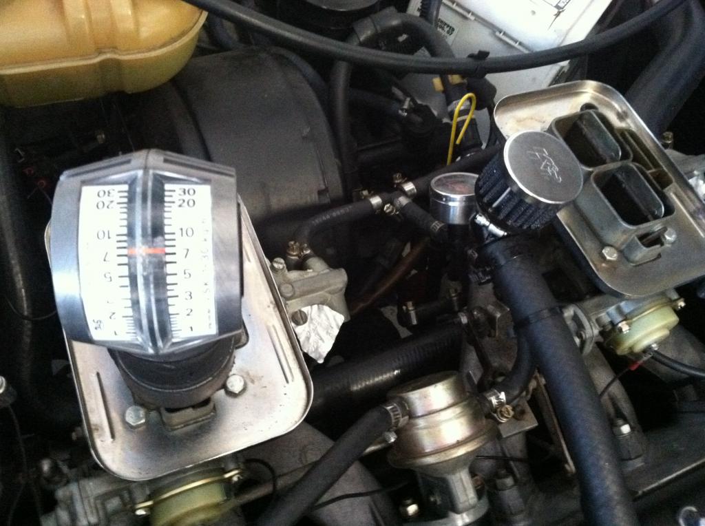

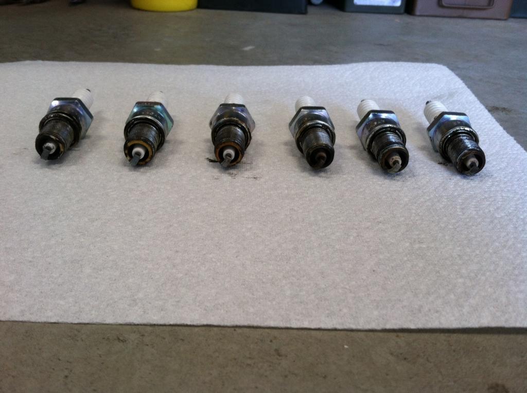

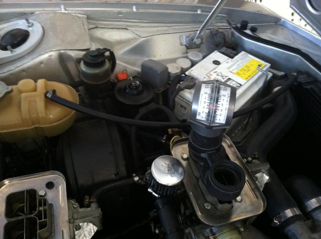

These plugs have about 50 miles on them. Front carb mix screw is just under 2 turns out (about 1.875), rear carb mix screw is 3.5 out. Sounds like a big difference, but they are synched as good as I can get them. Time to look at the jets I think.
Stevehose
13,016
5,693
Sarasota, FL
If your jets are the same, then an idle mixture screw out that far is compensating for something, typically an air leak. Regarding the secondary barrel - seems like a reading of 3.5 is high, should be closer to zero at idle. But maybe that's a Weber thing?

I wondered about what the carb-synch reading should be. I can say that Ive sprayed carb cleaner everywhere and I cant detect a leak. Maybe its subtle. I plan on putting in throttle shaft bearings I bought at Ireland to see if that helps.
I need to check the jetting. It wouldn't surprise me if they were different. I just have that kind of luck this year.
