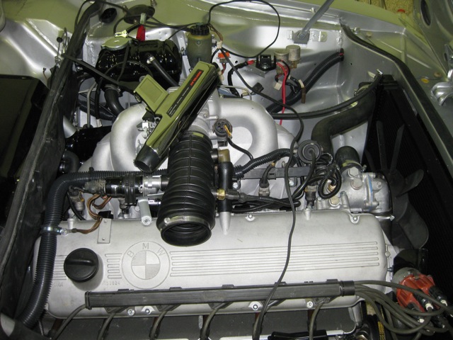

My original core is 2" and I have the earlier viscous clutch. From wall to radiator is 1/4", radiator 2", radiator to fan blade 3/8." The later pump and clutch gives more room. The tanks at either end 'may' push the core towards the pump but I don't know.
