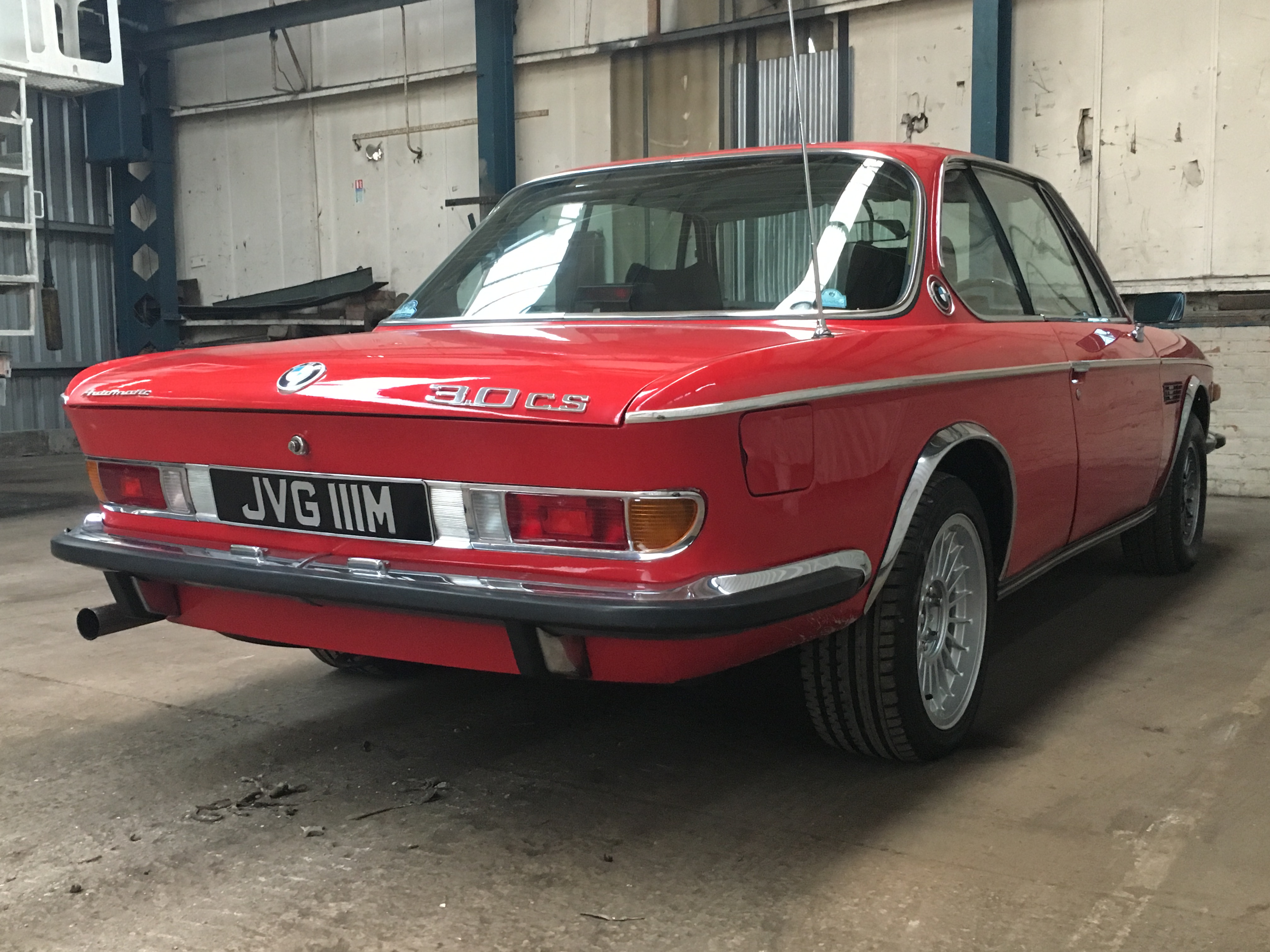

Rears on 10mm spacer coming tomorrow for the fronts
