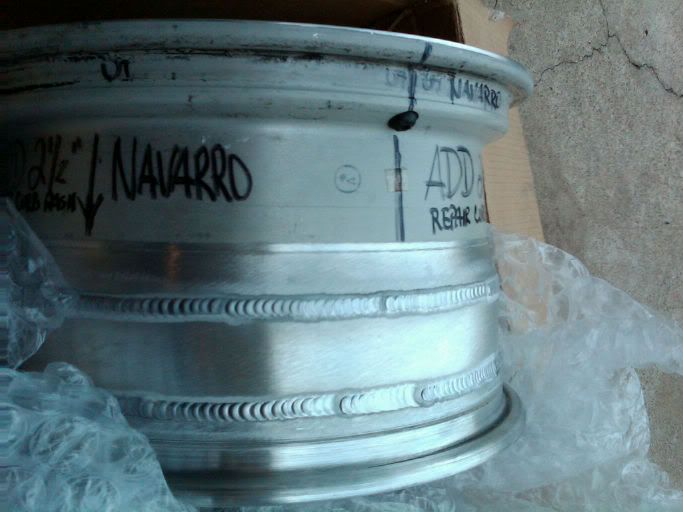

These are one piece wheels. However, there are plenty of wheel companies that will widen one piece wheels. It would probably be cheaper to buy a set of RS's with new lips and barrels though.
Like this:
The picture Green's show on the link is of a one piece wheel they did so pretty sure widening the Mahles is possible. The economics are another matter - currency, shipping etc.
but remember, in order to widen a wheel, say from 7" to 8", unless you add equal amounts to both sides, you will not change the offset. for instance, a one piece ET11 wheel that is widened, will be widened to the inside ... this well keep it ET11 and the wheel will be widened toward the centerline of the car. the point is that rubbing on the suspension (or something else) might occur
oops, you are correct, i got my geometry wrong. i stand corrected.
Although I consider myself offset challenged I was going to chime in as well. I think your point still holds that you can only increase the offset, and you don't have the opportunity to recenter the wheel. If you widen three piece wheels, you can keep the original offset by replacing the lip and the barrel.
I'd like to see these widened on the outer lip. Apparently some can be widened on the outer and some cannot, though I've never fully understood why. ( My points of reference are I was told RC090's could only be widened on the inner lip, while I have seen plenty of Porsche fuchs widened on both the inner and the outer, something to do with getting tires on I was told.)
