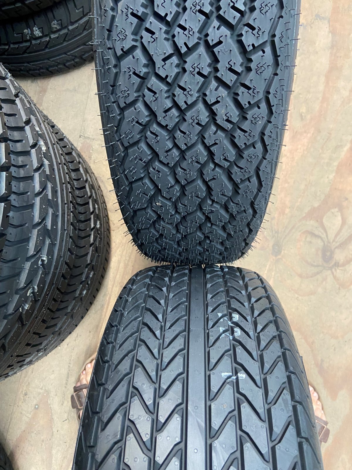

And finally, taller profile sidewalls respond to steering inputs more slowly than low profile sidewalls. This is, as you say, just physics.
Ok; that would be true if the amount of tread in contact were the same, which it isn't by any means. If you compared a lower profile tyre to a taller tyre with the same contact area/footprint, then yes the lower profile tyre would turn in quicker. but we arent doing that.
The picture on my last post shows the massive difference in how much foot print is on the road between a 205/55R16 P7 7.5" footprint compared to a 5.5" footprint of the 195/70R14 CN36 (It's shame i haven't got a 205/70VR14 CN36 on the shelf it would prove my point better.)
I have said this before, but a modern 50% profile tyre will put a huge amount more rubber in contact with the road tha a 70 profile tyre of the same section. a lower profile tyre has a wider foot print in relation to its section width.
Oo! i have had an idea. I do have a 205/70VR14 XWX on the shelf. this picture pretty clearly demonstrates this point.

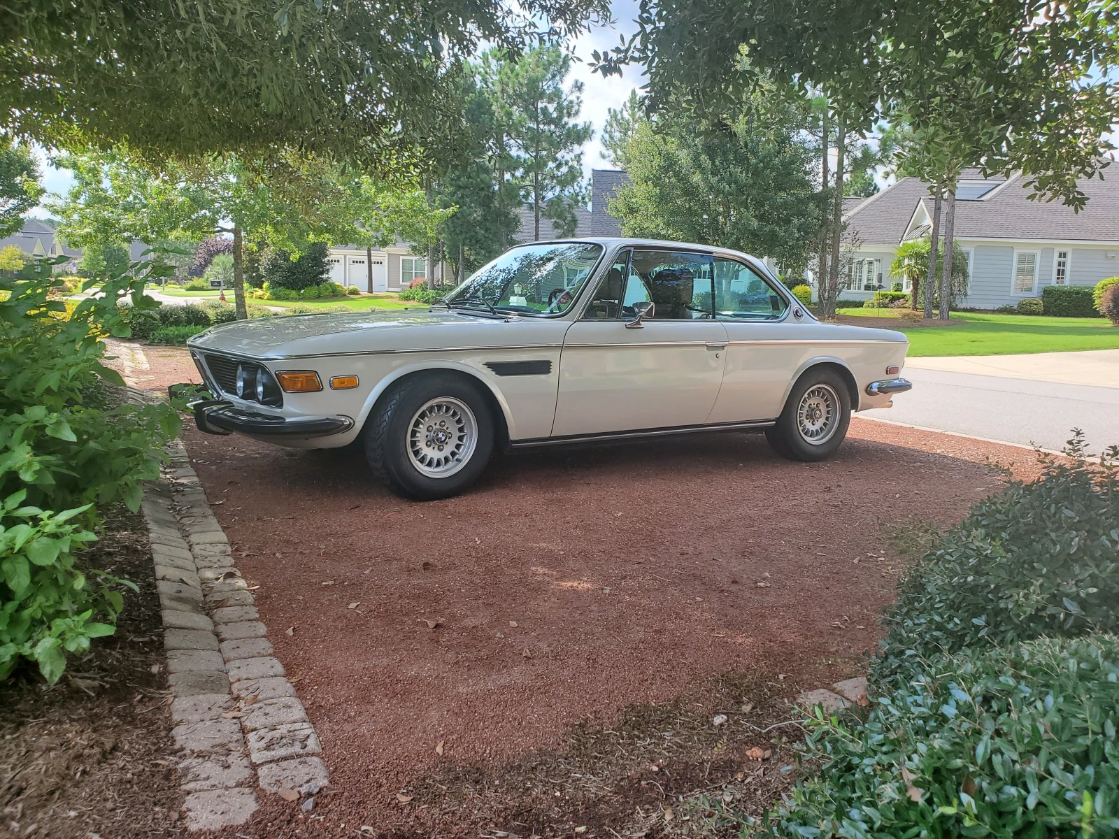

So, I have retreived my wheels and tires from my buddy - https://e9coupe.com/forum/threads/195-70vr14-pirelli-cinturato-cn36.46032/post-405665 - and have them on my car. Alas, I parked another project car in front of my coupe, and proceeded to tear the dash apart, which stuck my coupe in the garage for a while. In any event, I now have a set of 195/70R14 Pirelli CN36s on my coupe, and I have done a brief test drive:
Yes, I know, the bottle cap wheels are not great. These were the only 14" wheels I had laying around when the CN36s fell in my lap, so I'm using them.
My primary comparison is to the previous wheel and tire combo - 15" Weds Bavaria wheels with 205/60R15 Toyo Versado Noir tires (which were chosen primarily because I wanted to settle on a suspension setup I liked before investing in better tires). These tires are obviously a much more modern compound, 10mm wider than the stock tires and 5mm smaller rolling diameter. And even though the Weds are pretty light, I suspect this combination weighs more than the setup I now have on the car.
One thing jumped out at me in my little test drive. Going into a turn, and while in a turn, and coming out of a turn, all felt easier with the CN36s. In comparison, my prior setup felt like it was doing something unnatural in a turn, as if it wanted to return to going straight as quickly as possible. Turning the steering wheel initially was somewhat different. The actual process of turning the wheel was easier, which is probably due to the lighter weight of the new current wheel and tire combination and the lower moment of inertia. Or perhaps having 10mm less tire width came into play. The car did not change direction quite as sharply with steering input. Instead, both the change in direction and weight transfer were more gradual. What was most noteworthy was how comfortable the car felt mid turn, as if it could just happily continue in that attitude for a long period of time. The car did seem to be tilting or listing a tiny bit more in turns. I didn't notice any difference with smaller road bumps, but larger undulations in the road did cause a little more pitch than I expected. I did not do any hard braking, but I will want to do that because I always want to know what my cars are going to feel like in a very hard braking situation before I encounter one.
In short, this combination is more comfortable than my other setup, and I suspect the more turns I do with them, the better I will like them.
To be continued, as I do more driving.

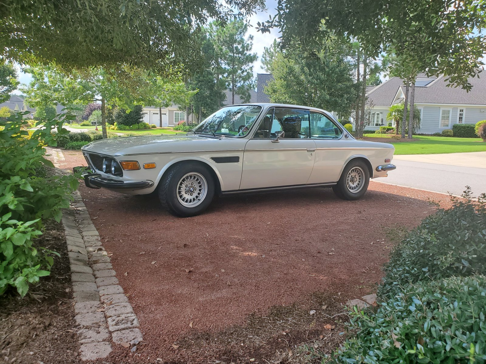

My primary comparison is to the previous wheel and tire combo - 15" Weds Bavaria wheels with 205/60R15 Toyo Versado Noir tires (which were chosed primarily because I wanted to settle on a suspension setup I liked before investing in better tires). These tires are obviously a much more modern compound, 10mm wider than the stock tires and 5mm smaller rolling diameter. And even though the Weds are pretty light, I suspect this combination weighs more than the setup I now have on the car.
Thank you for that, it great to here a real test. thank you for taking the time to write.
