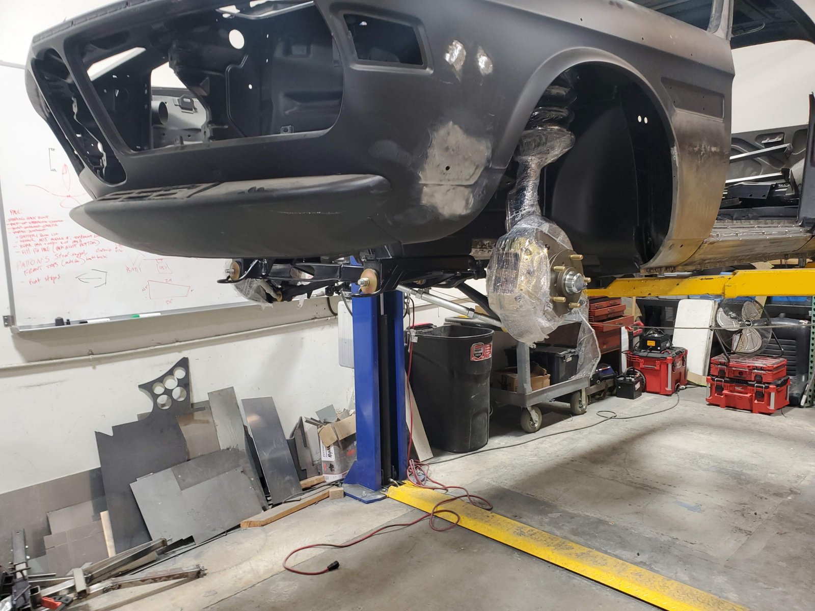

On the subject.. I was looking at my valance the other day. I have no reason to think it has been damaged but the car has been media blasted so there is no filler anywhere and I was surprised to see how many stretch marks are in the lower valance, presumably from the stamping. My bet is that anyone who has a straight, shiny lower valance has a lot of body filler in their car, as there is no way to get behind there and metal finish it (it is two layers near the core support). Perhaps the stone guard hides the sins (as does the bumper and normal viewing angle).

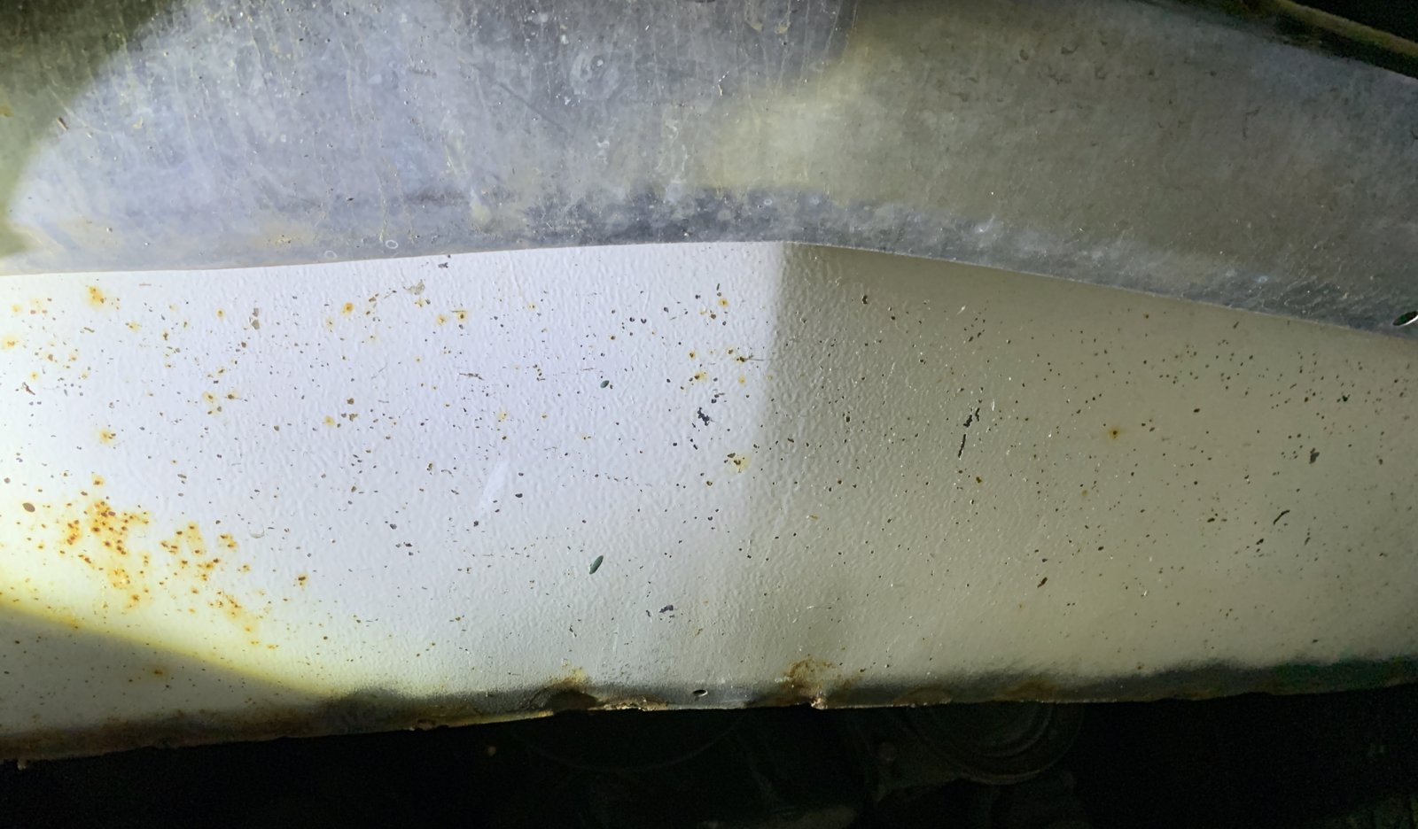

I'm no body expert, but I've read that media blasting can warp metal sheet and make it somewhat work hardened as well. Thus the advantage of body dipping though that has it's own drawbacks of difficult to remove residue in tight spaces and inaccessible spaces that need paint.
I had a look at my rather high milage 2800cs and the pin pricks of rust and a magnet tell me there's no filler and other than some slight trauma at the lower edge and a factory looking crease in the middle, it's also smooth.

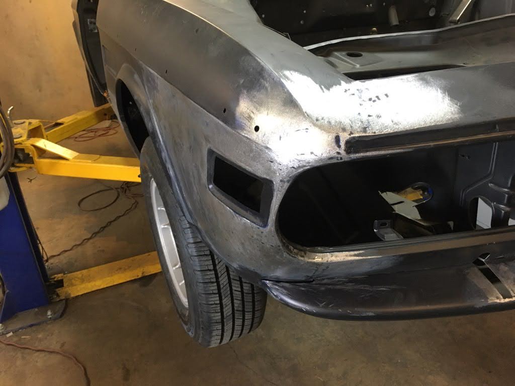

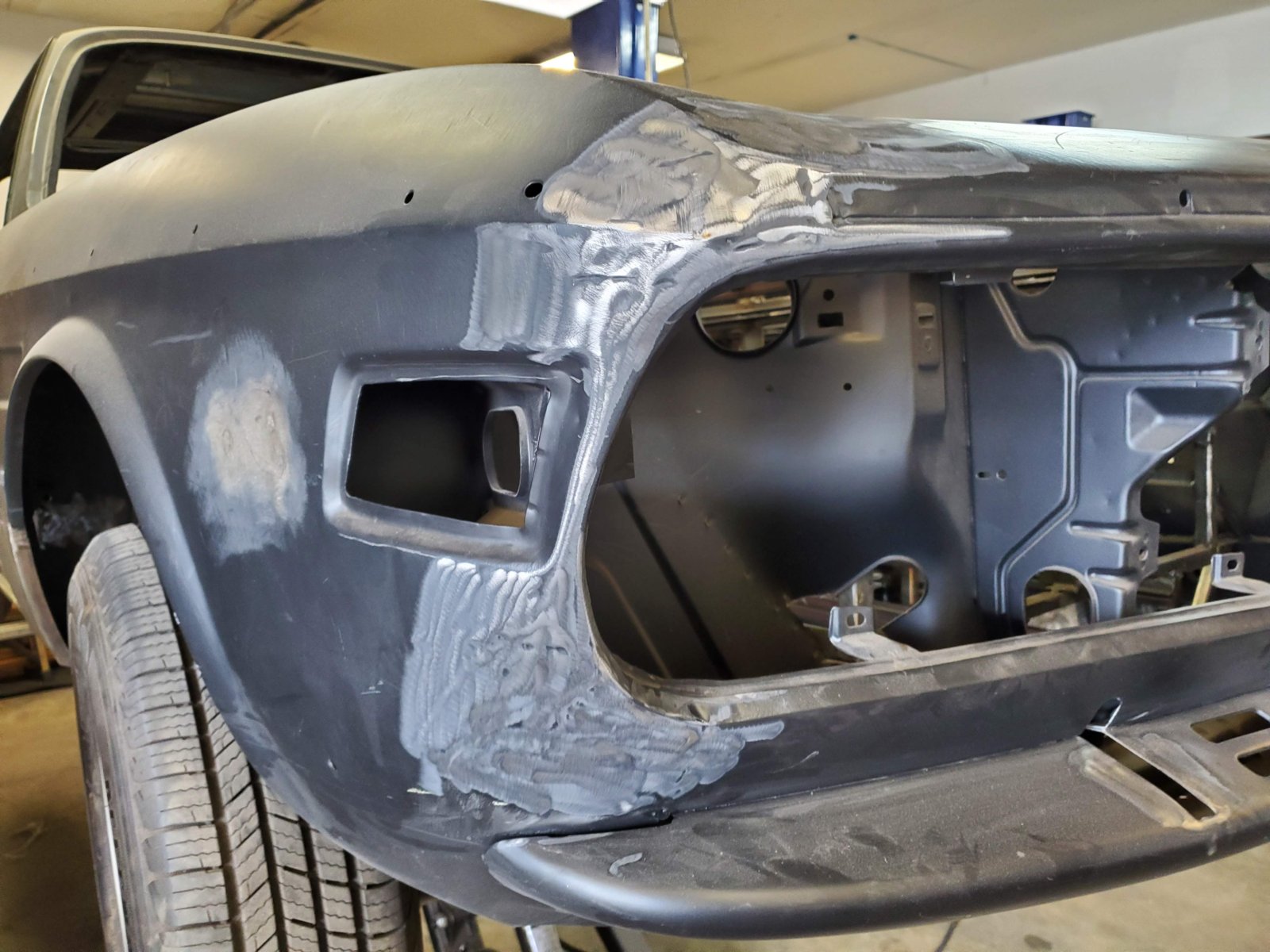

The old trope of media blast warping is just that -- old. Good media blasting companies know what they're doing. They used "Dirty 30" grit on the bottom of the car to get off the undercoat but all the visible body panels are done with plastic beads to prevent heat build up. Besides, that valance is welded to the core support so no amount of blasting heat would be able to cause those wrinkles. Perhaps there was an accident and poor repair but even that seems unlikely given how straight the trailing edge is. Prior accident damage was clearly visible on right front corner (subsequently metal finished much closer) but a blasted/stripped car really exposes all prior work and the lower valance just doesn't look like accident damage to me. Maybe mine is uniquely wrinkled. Just seems unlikely.
Prior accident damage not well repaired:
We cleaned that up quite a bit but it was all up fairly high:
I can easily shoot pictures that make it look straight (see below). You really have to shoot from the side on a smooth panel to know for sure. Hard to say how straight the the image above from @mulberryworks is with that textured finish. From the shadows it looks like there are wrinkles near the trailing edge to me.
