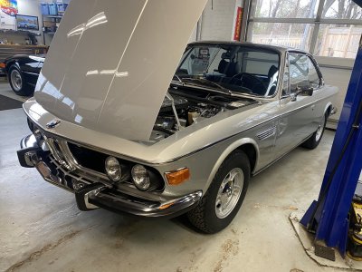

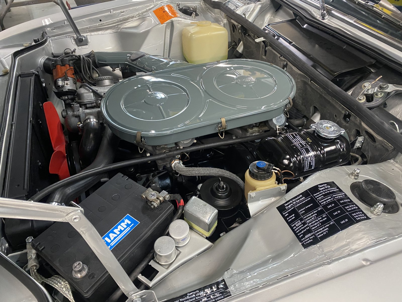

Wow, it's been 7 years. Congratulations on the beautiful work and inspiring photos. I like that you kept it as original as can be other than the sound deadener. Was all the paintwork done in house? What type of paint was used on the Diff?
Hello Bob, seven years just flew in a blink. The car had factory sound deadening and I just replaced it with a modern equivalent. I did not want the car
to roar like a steel drum when at speed so hence the need for the sound pads. The diff paint was a worth satin black, we buy the paint in spray cans.
Yes we did the entire car in house, including the paint. We used PPG water bourne paint and PPG clear, we were not able to match the colour in a solvent based
paint. The colour is a perfect match in water base.

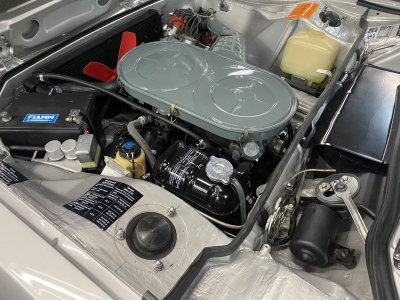

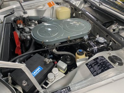

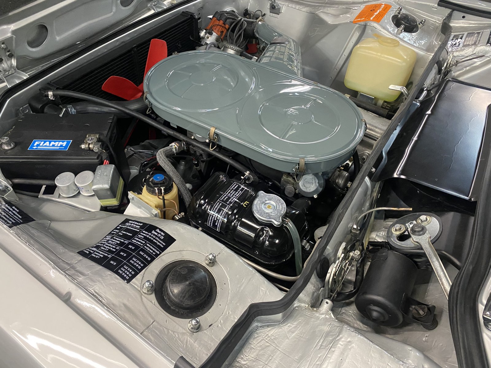

I do like the FIAMM battery. It is not hitting the eyes in the engine bay as most of modern ones being yellow, blue or white.

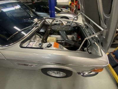

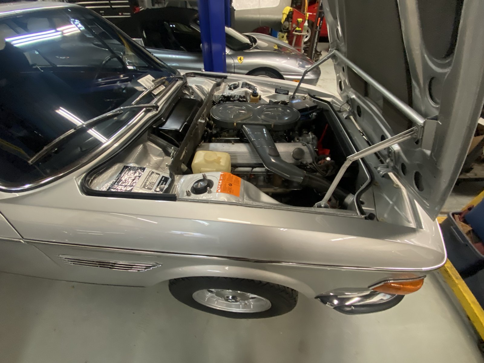

Was the 2800cs equipped with chrome-finished fender and hood grilles?
Later models in "Polaris" have had black painted pieces.
Also it was a black sticker underneath the fender grilles not to expose that there is just steel beneath :D

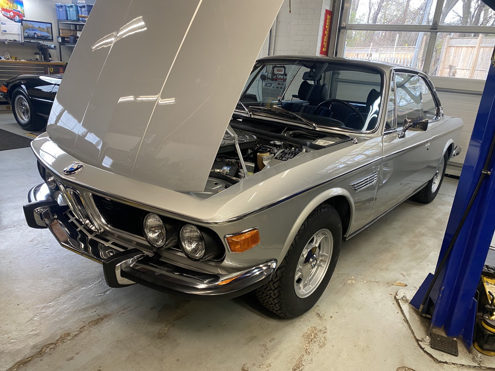

I never drove the car before the restoration either but I have a few Bmw's and I wasn't concerned about how it drove. When I did complete the car and after the first drive I was impressed at the solid feeling of the chassis and the firmness of the ride, not rough and not a parade float feel of an American car. I kept the original koni reds shocks, as I learned the hard way with the Bilstein yellow sport shock (too firm and jarring which ruins the ride, the original engineers knew what they were doing.) The engine is super smooth and when all the carbs open the car has a very nice growl, the power is more than adequate. The gearbox is one of the smoothest shifting units I have ever used.
The battery is a std american battery with some italian decals, a correct looking battery makes a nice addition to the engine compartment.
I'm not a 2800cs expert but my car came with black poorly painted chrome vent grilles, and my car is a 1969 euro car and most cars in period photos had chrome.
I was on the fence when it came to the black decal under the vents, I almost ordered the decals but changed my mind.
The car came with two center grilles, silver and black. I choose the black grille, incorrect but looked better to my eyes.
The correct shade of silver makes a difference, code 90 is period correct and stunning in person.

I have both thanks to Keshav for my 71' but recently swapped them and prefer the Black. Goes better with the headlight shrouds IMHO.
