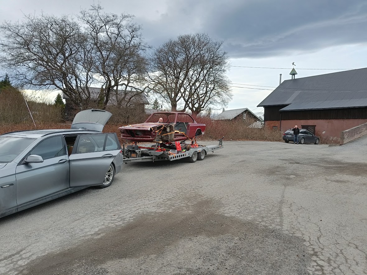

Some pictures of the car before dismanteling
Some pictures from when i picked it up.
