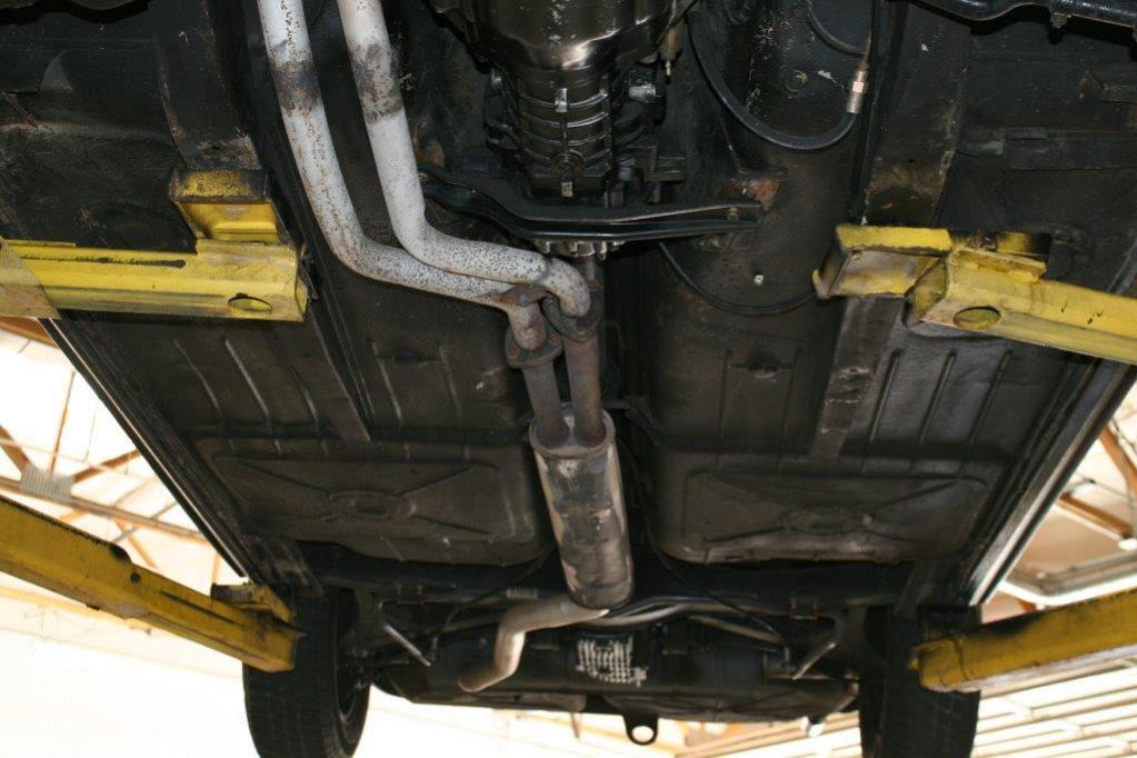

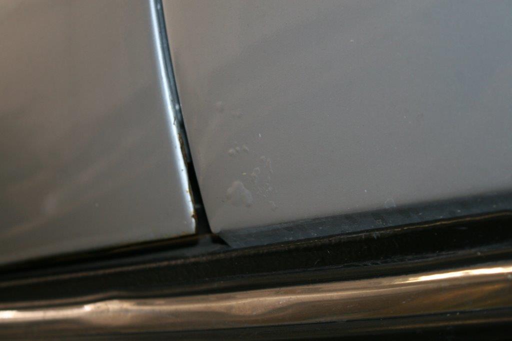

Here is the link to the rest of the photos: https://www.dropbox.com/sh/rl3w2jkf69xr4rl/AABRCt9oAaD_3chdflFjkYkWa?dl=0

Looks like a clean coupe from the pics on Hemmings (with the exception of the speaker grille) but based on the pics on dropbox showing all the rust bubbles, this car will be in need of rust remediation and paint. Based on my experience, probably will cost a min of 15k to 25k+. A coupe is worth all the money if rust remediation/bodywork/paint are documented with pics.

Looks like a clean coupe from the pics (with the exception of the speaker grille). Worth all the money if rust remediation/bodywork/paint are documented with pics. I may be wrong, but based on the pics, it looks like they just painted over the rust.
That's the feeling I get from seeing the photo of the bubbling. And I agree that speaker grill is ruining that dashboard.

For $40k, there should be ZERO rust bubbling of any kind. Surface, OK. But bubbling is a sign most likely, to be deep cancer starting to rear its ugly head.
I'd pass.

Andrew. That's the same thing you thought about my coupe and I ended up spending close to 25K on rust remediation and PARTIAL paint at VSR. My car looked better than this on the exterior. You really have no idea what LURKS underneath the paint until you start taking things apart.
I am not saying it may need the same amount of work but I agree that for 40k in the current market, it should not have rust bubbles lurking underneath the paint. It is an omen
