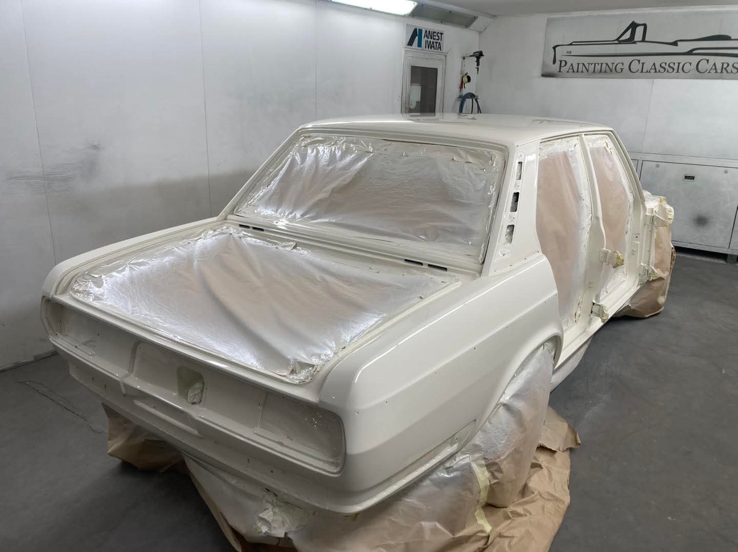

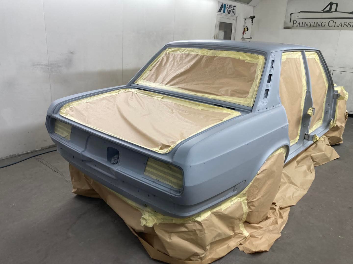

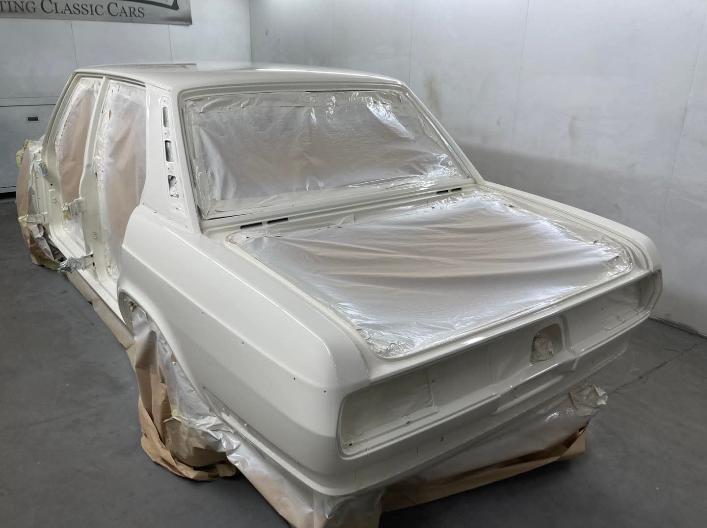

Question about the metal prep: it appears you've jumped straight from bare, ungalvanized metal to epoxy primer? Did you have the frame dipped for rust prevention (the way that many 50's and 60's cars are treated), or does the epoxy primer provide the rust prevention because it fully seals the bare metal?
I'd be curious to know details of the epoxy primer - I need to get educated....
The epoxy primer is there to prevent flash corrosion of the bare steel. It does not absorb moisture therefore effectively seals the bare metal from the environment. The paint system they use is by Novol who specifically design paint systems for classic cars.
If you go to about 3:45 minutes in on the following video the full process is explained.
They applied 2 coats ( and maybe 3) of clear. There's no mention of cut and polish. Glasurite clear on my car was at least 5 coats with 2 coats cut with at least 5000 wet sanding to remove the orange peel.
That part of the process is probably in the next video, unless the job was to have a factory finish.

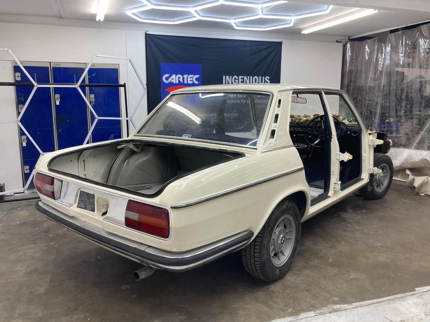

I see you also have one of my favorites mods - the rear bumper deletes. Did you also do this on the front bumper?
Euro models didn't have the rear over riders, they were fitted with the blanking covers as standard. Only front over riders were fitted (still on this car).
I don't understand why Euro cars didn't have them. Every other car make I can think of from this period has both front and rear, seems a bit odd to have fronts only.
