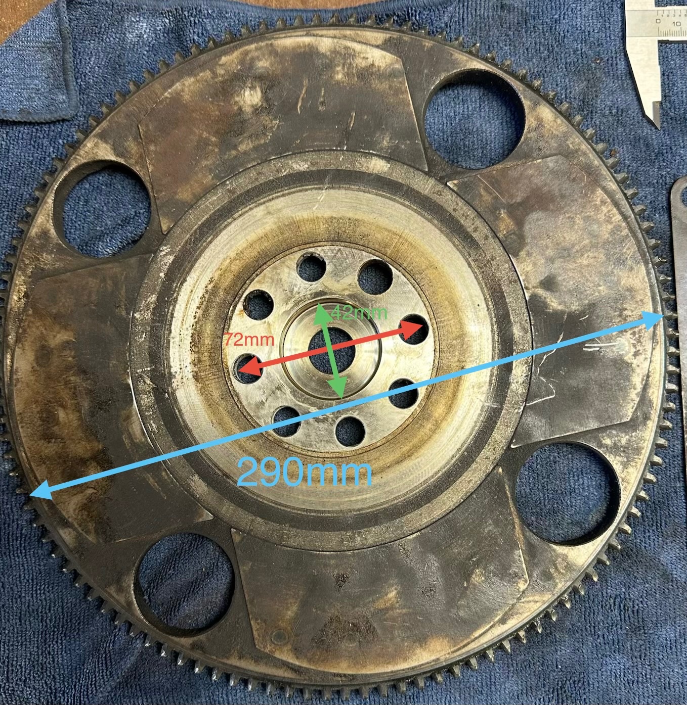

Trying to see what my options are to replace the fly wheel on my Bavaria. Unfortunately the starting ring gear is developing flat spots. The M30B30 is paired with the original BW 65 three speed auto transmission.
Real oem calls for part number
11221253633​
It’s then superseded by
11221262617​
Looks like finding a new one or good used one can be complicated. Anybody deal with the issue of replacement and have any pointers.
I’ve attached a photo of the original flywheel with measurements

Ooops should have read it better, you have an auto ring gear is part of the flex plate
What about a flex plate from a 530, 533, 535 or 6 or 7 series
