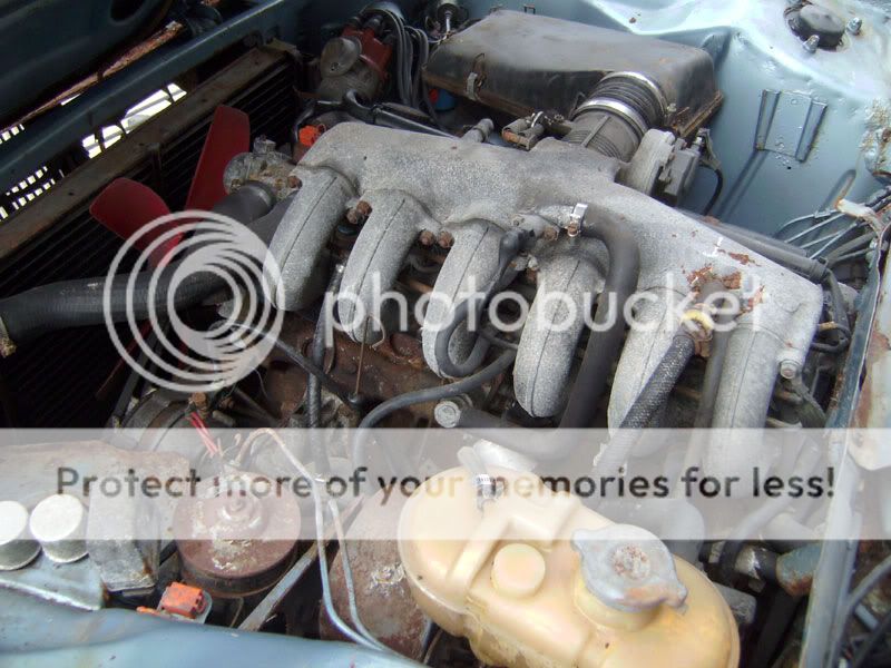

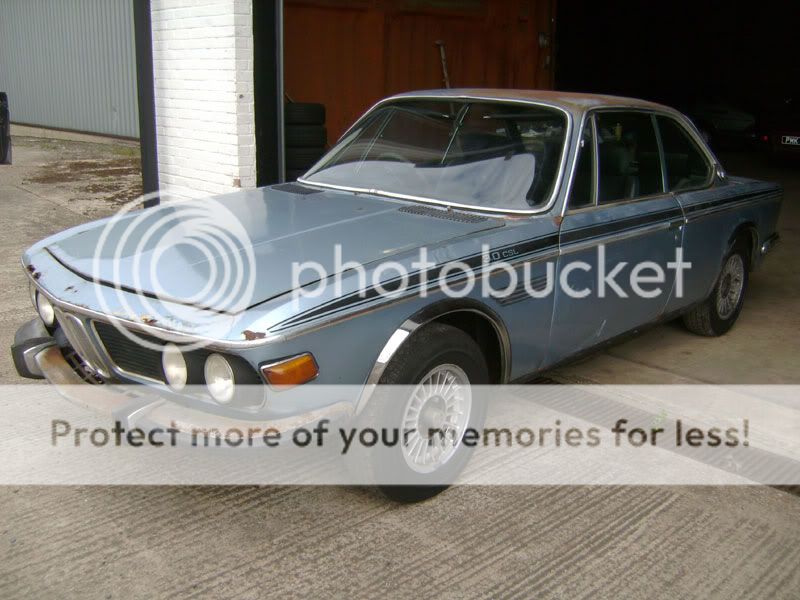

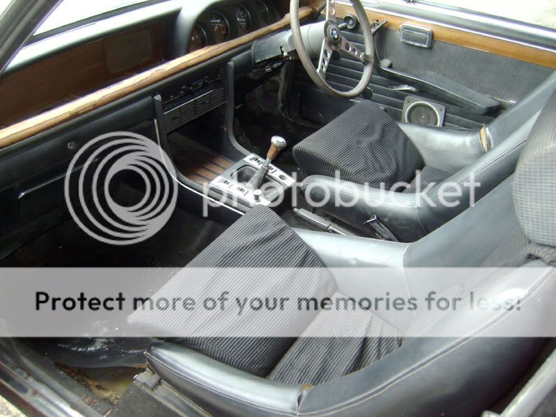

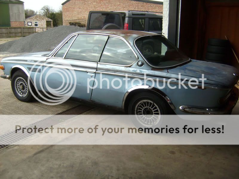

hi all,
i have just become the proud new owner of a 1973 3.0 CSL in need of full restoration.
the restorations wont be starting for a while as i haven't collected the car yet and i will be on the hunt for all the parts before it begins.
i am looking forward to picking your collective brains during the process!

Good for you - Old Girl looks likes she has had some hard knocks but still a pretty thing.
