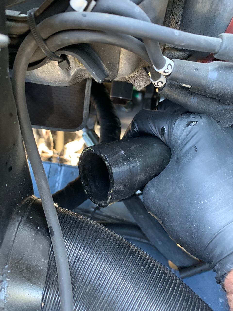

I'm finding out that between the twisty country roads up here, the inspiration those provide to indulge in spirited driving and possibly some flex in the radiator bracket rubber, this issue can become a serious problem.
Here is what happened to me last weekend.
With an immense does of good fortune, this happened right as I was parking my car at the Novato cars and coffee... and not during the one hour drive there or, worse, during the 13 hour drive from LA to NorCal a few months ago. And the culprit is... the Sanden compressor pulley. Even through there is about 1/4 inch clearance between it and the hose at idle, during driving, things tend to move more then that. The pulley cut the clamp in half. Fortunately the hose was only scored and not cut. Lucky for me, Lisa 02p (who was parked next to me) called her friend Kacey from Bill Arnold BMW, who was also attending the cnc. She immediately drove to her shop, got me a new clamp, installed it and, thanks to her help, I was able to get back home... albeit at a much more measured speed. Those two women saved the day!
With an immense does of good fortune, this happened right as I was parking my car at the Novato cars and coffee... and not during the one hour drive there or, worse, during the 13 hour drive from LA to NorCal a few months ago. And the culprit is... the Sanden compressor pulley. Even through there is about 1/4 inch clearance between it and the hose at idle, during driving, things tend to move more then that. The pulley cut the clamp in half. Fortunately the hose was only scored and not cut. Lucky for me, Lisa 02p (who was parked next to me) called her friend Kacey from Bill Arnold BMW, who was also attending the cnc. She immediately drove to her shop, got me a new clamp, installed it and, thanks to her help, I was able to get back home... albeit at a much more measured speed. Those two women saved my day!
