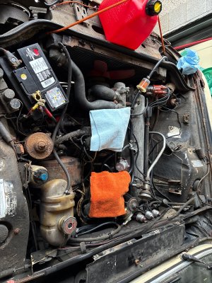

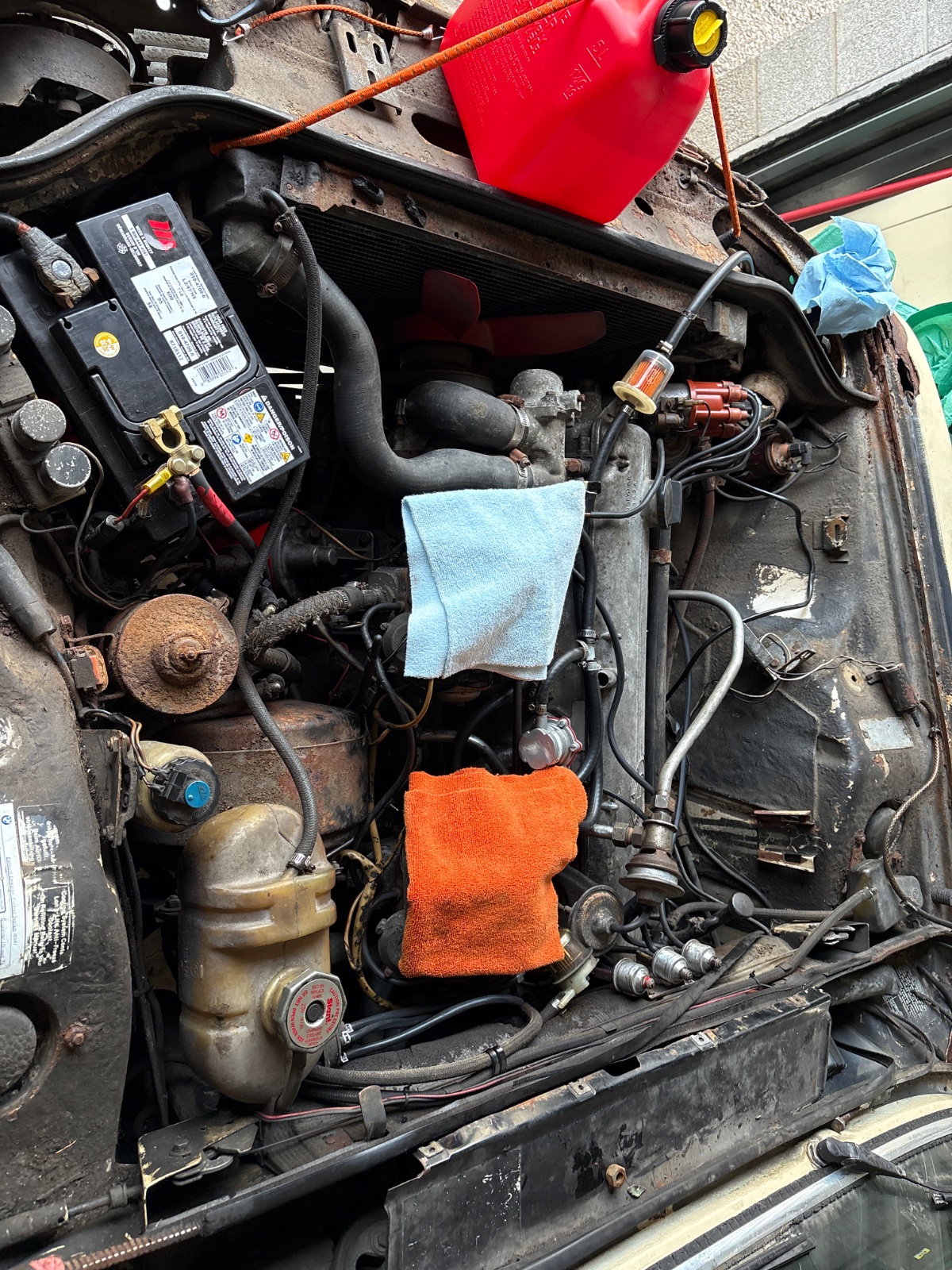

So far I’ve managed to clean the whole interior alongside some other things like getting the car running, hooking up the entire emissions system, replacing the mechanical fuel pump, the list goes on… Alongside all of the work I’ve put in so far I did forget to mention that it was a no-keys no-ownership car. (great idea, I know :’) lol) In it’s current state theres a fair amount of body rot on the car, the windshield is cracked, the gas tank is dented and 3/4’s of the exhaust is rotted off as well. Now I do apologize for my shpiel of an introduction so I’ll get into the meat of why I wanted to post this.

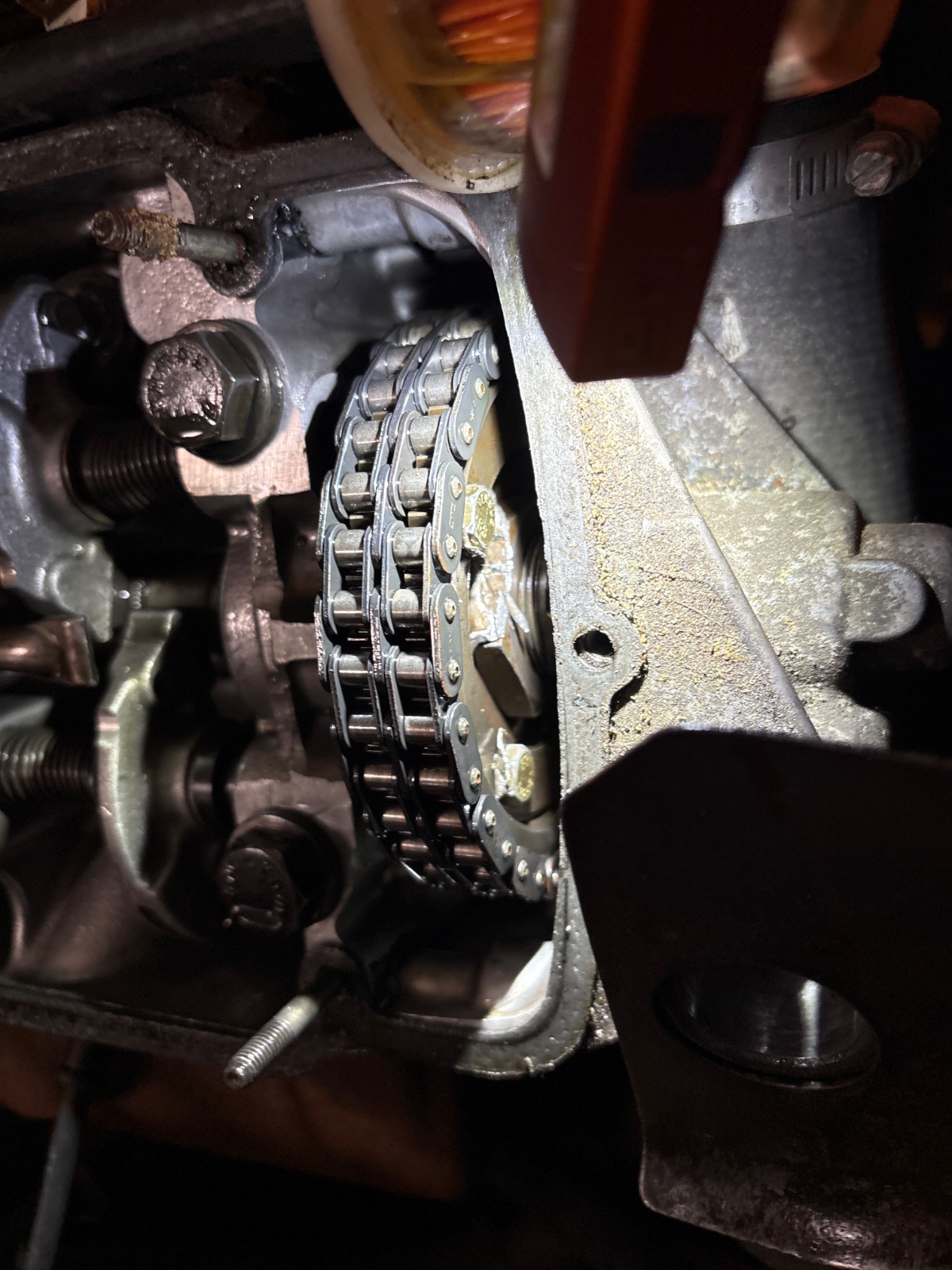

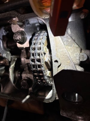

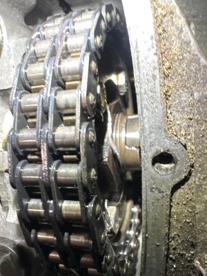

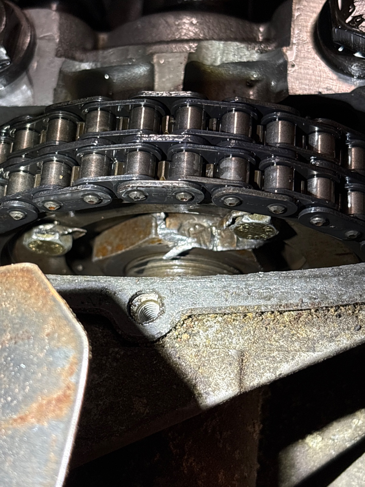

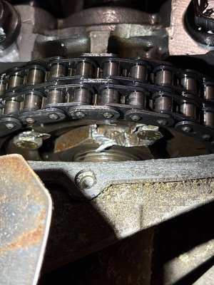

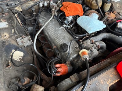

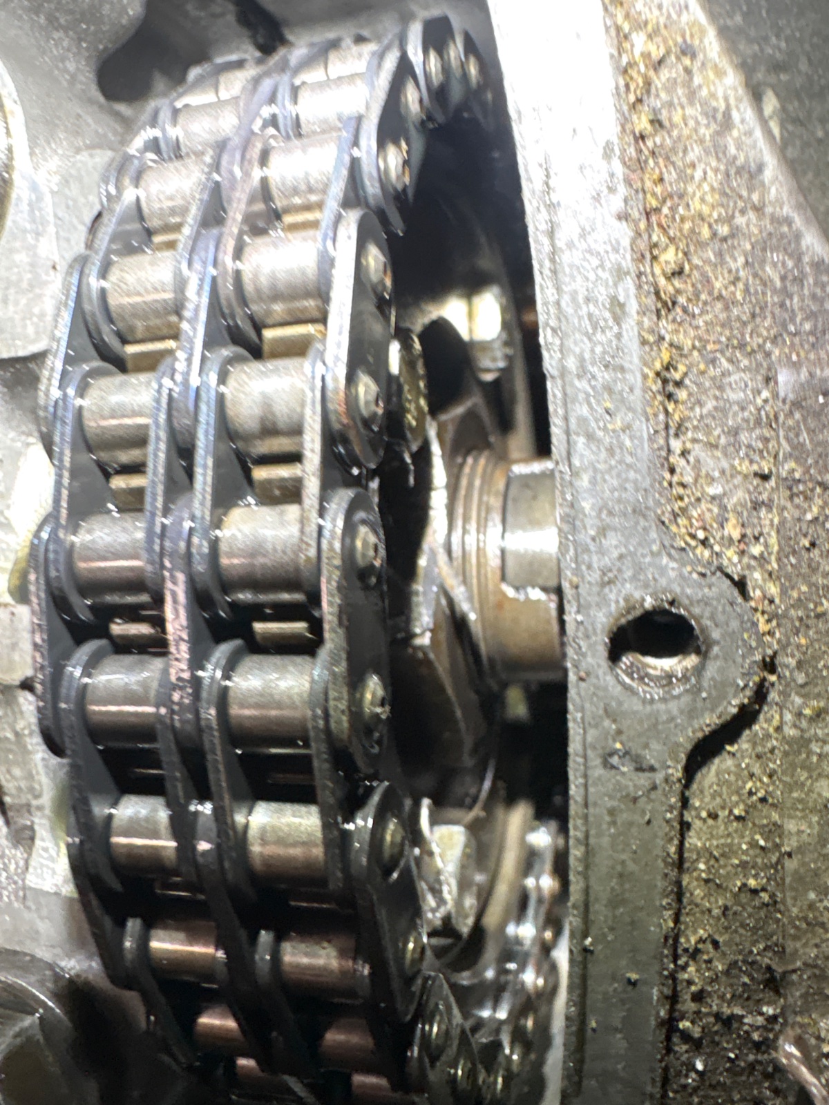

As recent as only a few weeks ago my friend and I were attempting to time the engine so that the car is running in tip-top shape to a certain degree at least. In my infinite wisdom I decided to check the valve train through the oil filler cap and had noticed something off by the timing chain. After taking the valve cover off I ended up finding some shards of metal from god-knows-where by the timing chain and camshaft flange bolts(?) This killed my motivation to work on the car but after some thought I’ve decided to try to tackle this head on as my worst fear is having to sell the car or blow even more money on getting the engine rebuilt.
So far, the camshaft is still fine, the timing chain is still on tight and doesnt slap around when cranking at least, and the valves and lifters are completely fine too. I have heard a few metal clangs when starting the engine before, which has made my stomach drop so much but Im holding out hope the car is still revivable.

The four camshaft bolts with m10 heads are secured by two flat pieces of metal and the ends are bent up to ensure the bolts can't back out. One of yours is destroyed so the metal went somewhere.
Is that what it is? I think I do recall when I was poking around with my work light in the front of the engine I got a peak at the bottom of the oil sump(?) Basically just the bottom of where the timing chain leads to past the guides. I saw some shinies by the oil down there so Im guessing thats where the rest went. Any suggestions on what I should do next?

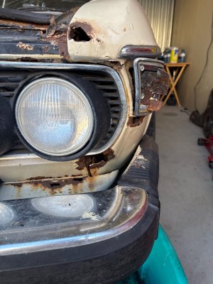

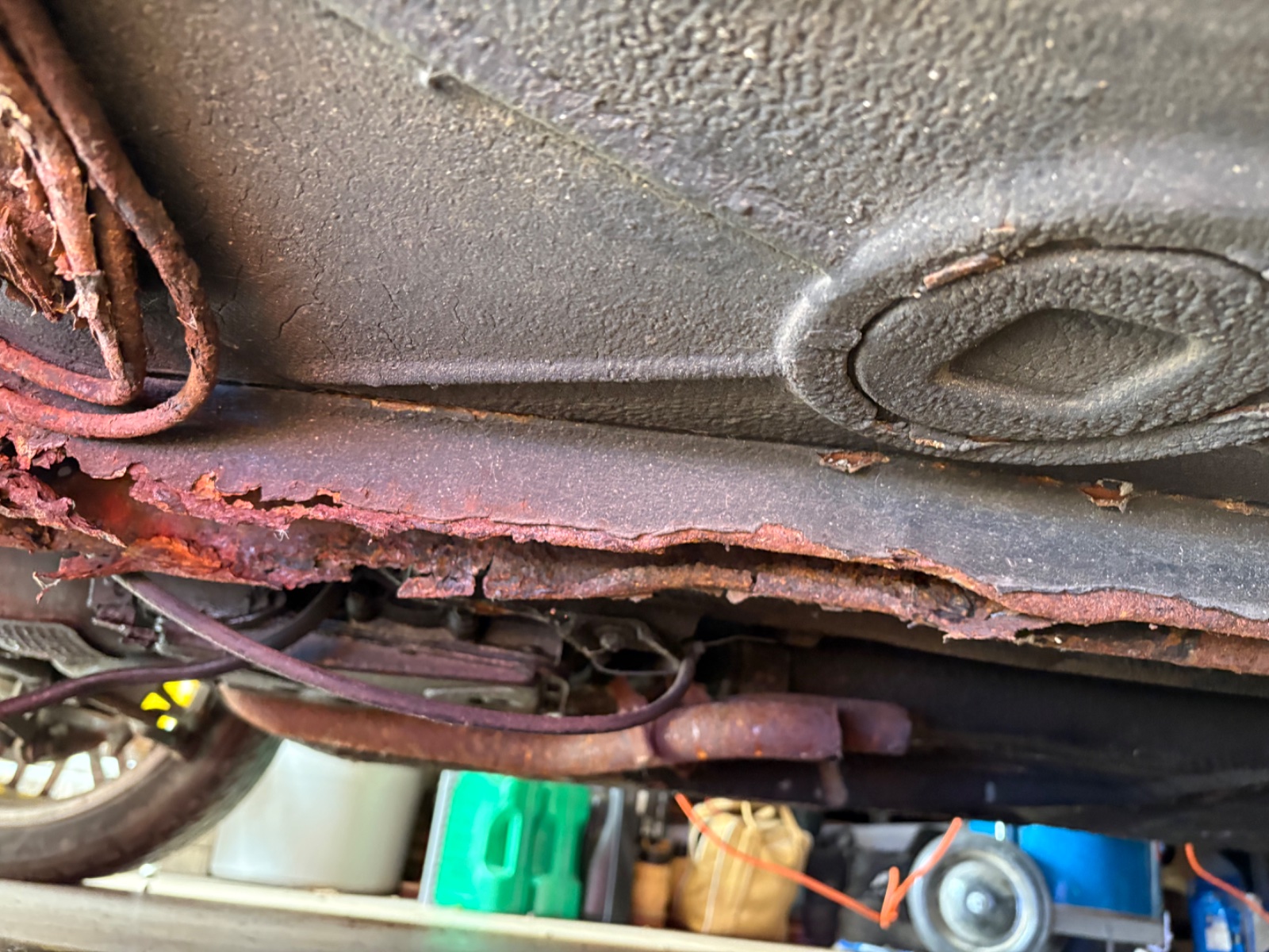

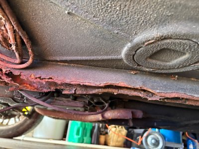

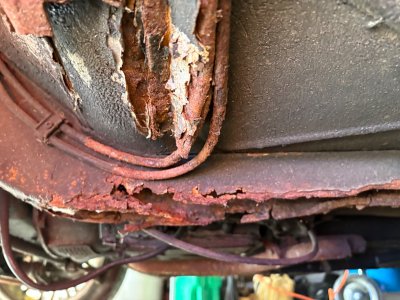

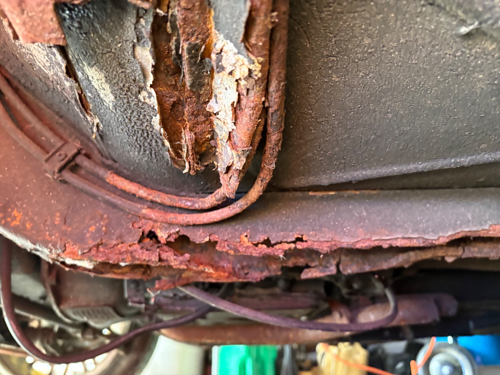

Welcome to the madness! I would caution a little bit on putting too much $ into getting it running yet...the structural underneath would stop me from driving it at all. That rotted out sub frame rail is almost completely gone. I'd be worried about parts of the car completely collapsing. With any kind of budget, that rot is a wallet killer. Not what you want to hear, I know....maybe some other, wiser souls will chime in with better news?
Yeah, definitely your lock plates decided to interfere with normal operations..I wouldn't run the engine until I got the front covers off and cleaned it up and inspected..def don't want metal shards in the oil passages..

I’m with e9leveque in this. I’ve restored/rebuilt a bunch of cars and would never touch something in this condition that’s worth so little already. I picked up my Bav 10 years ago for about $3k…zero rust, SoCal car..I’m finally knee deep in it and it still adds up to a TON more receipts than you can imagine. My car already had every original part on it, was straight, and ran. Finding the missing pieces, replacement fenders/doors/etc, is really tough with these because they weren’t well cared for.. also, welding and repairing this type of stuff is waaay different than just having a welder and being able to lay bead here and there..blowing through the thin metal, warping the panels, just making it look right, is a huge skill. I have a couple welders, been at it as a hobby for over 15 years and still have so much to learn.
These cars are totally worth bringing back to life IF the starting point is already really good and you do the work yourself. If you ever want to sell it, it will be worthless unless you’re a pro bodyman already. It’ll be a patched and cobbled mismatch of a learned in project car.. That rotted area is literally holding the car from folding in half..and it’s failing soon. You could easily pick up an almost rust free car for barely anything and be way ahead.
